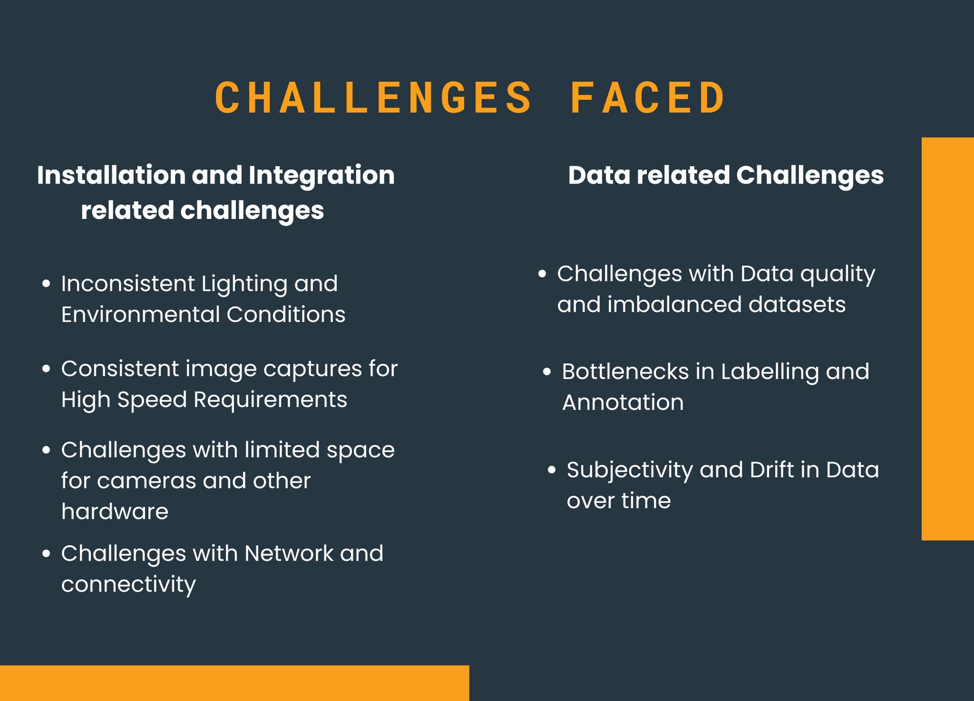

List of the challenges faced
Source: Eigen Innovations
