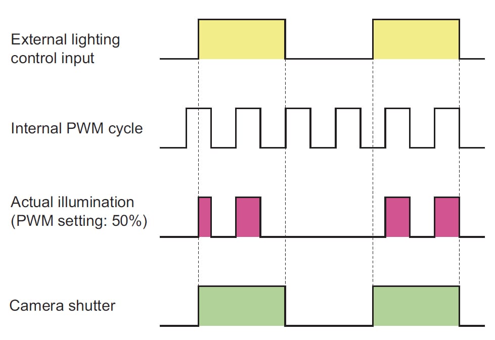

The lighting itself is not the only consideration. With line speeds so fast, it is important to be able to turn the light on and off with the camera exposure, and there is marginal room for error. If the light cannot receive a trigger, turn on, flash, and turn off all within the camera’s exposure time, the image will flicker and have inconsistent intensity. Any jitter in the triggering of light pulses relative to the camera exposure can blur or misalign images. Lighting control needs to be nearly perfect for consistent and precise results.
Lighting control can precisely time light flashes down to the microsecond-level, so that the maximum amount of light reaches the camera within every shutter. Source: CCS America

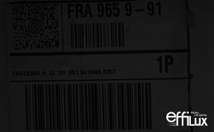

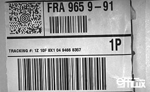

In flood lighting applications, the contrast is there even without lighting, such as a dark barcode on a light background. There is no specific direction or LWD required to see the target information, and the main purpose of lighting is to evenly illuminate the entire field of view.
Barcode
Barcodes, such as those in logistics applications, already have high contrast. Dedicated strobe flood lighting ensures the image is bright and uniform for code reading, even at long working distances. Source: Effilux
Barcode
A dedicated strobe flood bar light can provide uniform illumination, so ambient light or other factors do not affect the image day to day. The most common application of high-speed flood lighting is logistics, where thousands of packages need to be scanned every day. Flood lights also provide the intensity needed for high-speed applications that require installing lights at longer working distances.

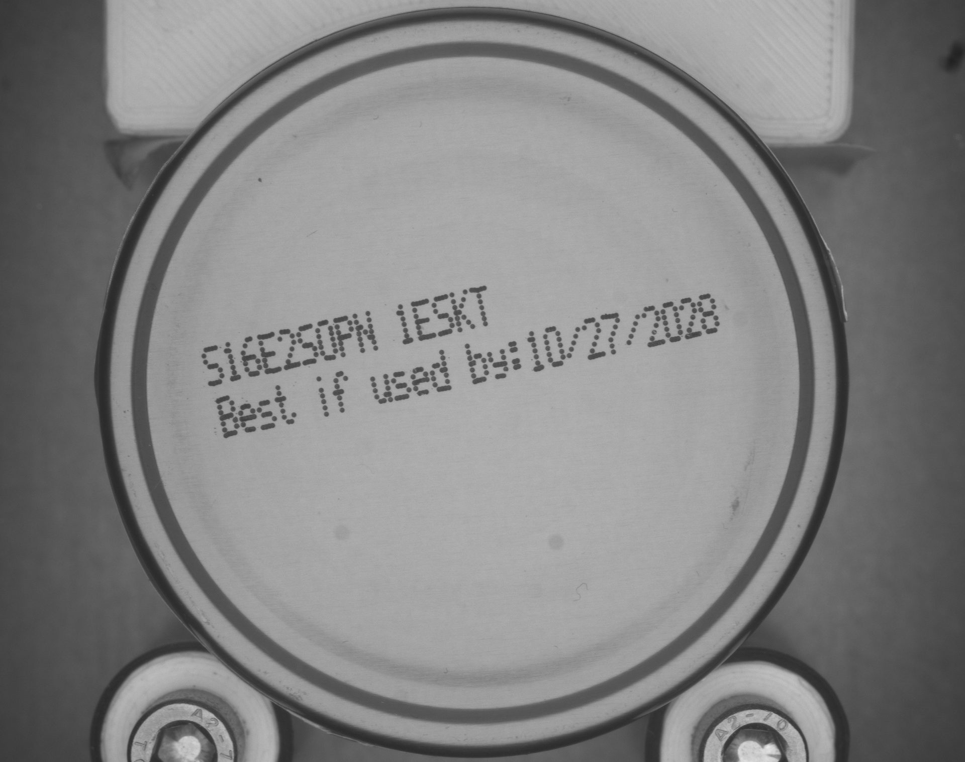

Inspections that use precision lighting have a specific detail that needs to be seen that has little to no contrast on its own. Engineers must factor in what wavelength, direction, angle, size, and optical accessories will do the most to enhance uniformity for the highest possible contrast, or else the system will not be accurate enough to be reliably deployed.
Lighting on can
Sometimes, flooding the FOV with a lot of light makes it harder to see the target information. A lighting solution with a specific lighting geometry, working distance, etc. will clearly highlight the defect and emit enough light, so the image is bright with no blur. Source: CCS America
Lighting on can
Since higher intensity lighting may create more harsh specular reflections, especially on curved or shiny parts, precision lighting solutions become even more crucial in high-speed applications. High-speed precision lighting must provide different types of lighting geometries in addition to strobing capabilities, so that there is as little noise as possible interfering when capturing the defect.

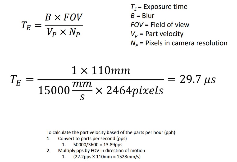

The best indicator of an application’s required intensity is the exposure time. To calculate the exposure time for an application, you need to know blur (B), field of view (FOV), part velocity (VP), and pixels in camera resolution (NP).
This formula is used to calculate exposure time for an application and can help engineers determine if a standard light on overdrive or a dedicated strobe light is the likely solution. Part velocity can be calculated using parts-per-hour (pph) if that is the information the customer provides. Source: CCS America
Generally, if the exposure time is:
  • >500µs: standard intensity is usually sufficient
  • 100µs - 500µs: application dependent
  • <100µs: dedicated strobe required
