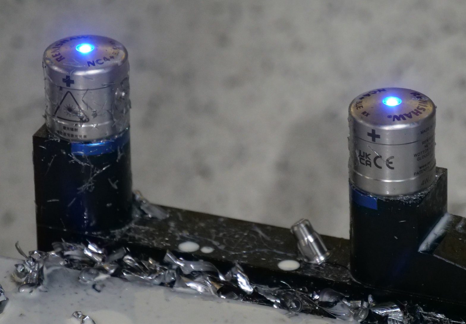

When Standard Tool & Mold Inc needed support with its on-machine tool measurement technology, it turned to global engineering technologies company Renishaw, who supplied the new NC4+ Blue tool setter, a high-accuracy blue laser system.
During machining processes, dimensional accuracy is dependent on several variables including: tool size deviation, tool run out, and tool breakage. Renishaw’s NC4 systems allow users to control these variables, enabling the measurement of tools at production feeds and speeds, and minimizing the risk of excessive tool wear or breakage, which is an important consideration for small and fragile tools.
“The machine that it’s installed on gets both coolant chips and debris, and the NC4+ Blue has stood up well to this challenging environment and been very accurate and repeatable” Standard Tool & Mold (Canada)
