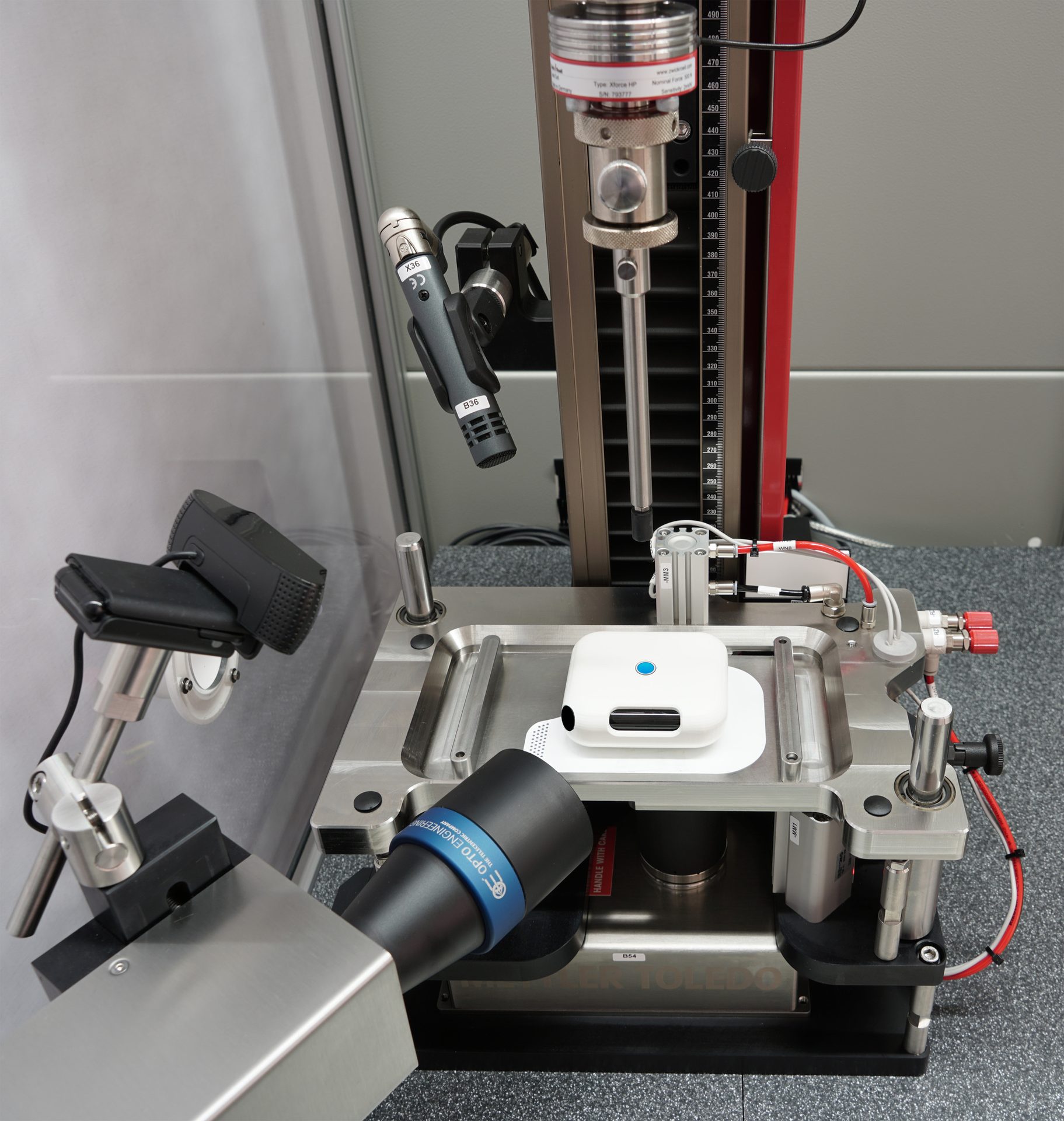

ZwickRoell zwickiLine testing machine for OBDS testing technology with high-resolution measurement devices, cameras, and microphones that must be verified on a daily basis.

ZwickRoell OBDS testing setup
When testing the emerging wearable devices, manufacturers are now confronted with various new and unique challenges. ISO 11608-6 requires manufacturers to measure the amount of the drug dispensed, which is directly influenced by the overall function of the various mechanical components of an OBDS. These devices typically hold much higher volumes of medication, which translates into longer injection times, sometimes lasting as long as an hour. Measuring the medication flow rate will be a critical component of the combination products’ capabilities as high flow rates can be painful for the patient. Additionally, the needles within these OBDS devices tend to be both larger in diameter and shorter in length which will require higher resolution measurement techniques. Lastly, these devices will be adhered to the body for extended periods of time so testing of the adhesive properties at body temperature will be important to track.

ZwickRoell semi-automated testing solution including custom device holding fixtures, precision control electronics, and multi-purpose testing software including ISO 11608-6 methods
A solution has to work for not only the manufacturer but also partners in terms of reproducibility among all parties involved. Furthermore, by automating testing processes, human influences on the test result are eliminated to the highest extent possible and higher accuracy is ensured. The use of intelligent software integrated in the test sequence documents results and clearly displays them for the user. For maximum transparency, reliable traceability for validation and quality control, machines must guarantee reliable performance in accordance with standards like 21 CFR Part 11. This is particularly important and essential in the biotechnology and pharmaceutical industries to trace who did what, when and why, and who is responsible. Through close collaboration between delivery device manufacturers and testing machine providers and by continuously sharing expertise and know-how, the industry will continue to evolve medicine and needle-based drug delivery devices and ultimately benefit patients to the greatest extent possible.
