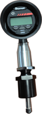

Dave Leboeuf, product manager at Fowler High Precision, emphasizes the importance of strict manufacturing specifications for handheld gages. Each gage is built to very strict specifications to ensure accurate measurements, and higher-end gages are often accompanied by setting masters. These masters help both calibration and the accuracy of measured readings. Regular, thorough inspections and calibration of these gages are needed to maintain their accuracy over time, Leboeuf says.

Whether it’s a standard yearly check, an adjustment based on usage, or integrating shift-level practices, calibration schedules should be flexible yet systematic, experts say.
Leboeuf suggests a general rule of thumb for gage calibration. “The rule of thumb is once yearly, but this depends on use. If your gage is being used all day, every day you may wish to have it calibrated more often, [such as] every six months or less.”
Peter Dow, sales and engineering manager at Dow Gage, a division of Sirois Tool, calls for a tailored approach, aligning calibration schedules with specific operational needs and quality assurance protocols. “This should be determined by using the company’s quality program,” he says. “Obviously, the amount of use of the gage on the shop floor should be a factor to determine inspection intervals,” he says.
Michael Jeffers, Marposs product manager, TESTAR Division, offers insight into the calibration practices for Marposs's I-Wave2 probe. While factory-calibrated, Jeffers notes the necessity of regular zeroing at the shift level. While min/max masters are not essential for calibration, they are beneficial in verifying system accuracy. Jeffers points out that this practice can notably reduce the costs associated with frequent calibrations.

In addition to calibration and inspection, simple practices like regular cleaning, careful handling, and proper storage significantly contribute to the longevity and accuracy of these tools. By adhering to these best practices, manufacturers can maintain the integrity of their quality control measures, ensuring that their products consistently meet the high standards of precision and quality.
“Keep them clean,” Lebouef advises. “Many gages now are water and dust-proof, which allows them to be subject to harsh environments and still work correctly, but they should be kept as clean as possible anyway.”
This practice ensures that even in tough conditions, the gages maintain their accuracy and functionality.
Dow says that, while durable, gages should be protected from environmental damage and wear.
“They should be handled and cared for as any other precision equipment,” he says. “For obvious reasons, all gaging contact surfaces should be wiped or blown clean of chips, etc., before use in the next part to be inspected. When not in use on the factory floor, the gage should be stored in a clean, dry cabinet or drawer.”
Jeffers outlines a simple yet effective maintenance routine. “Simply wiping down gages, eliminating any chip and coolant buildup, and maybe lightly cleaning with denatured alcohol in case of swarf buildup is all you really need,” he states. Jeffers also highlights the importance of proper benchtop space and storage structures to minimize potential damage to the gages.
