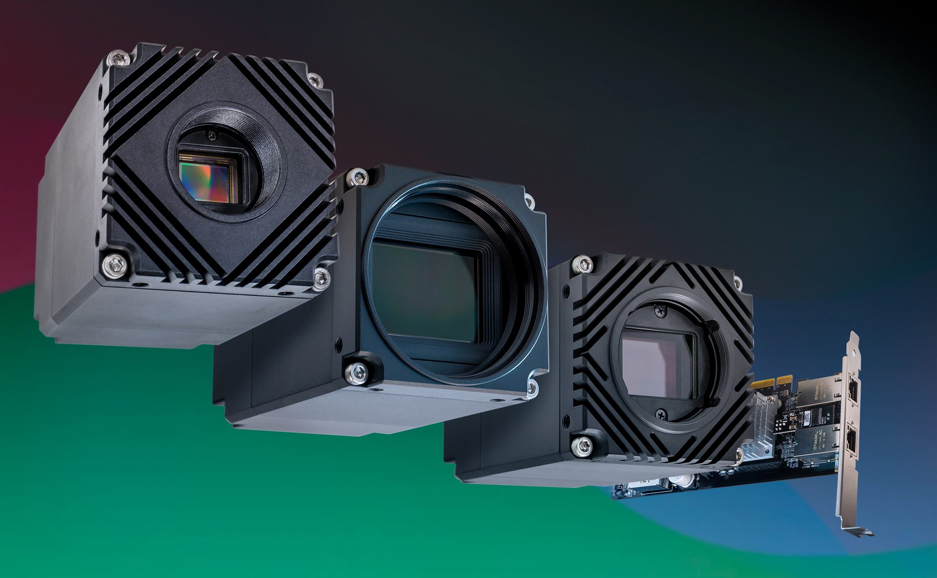

Motherboard With RDM Acard Atlas 10
High-speed, Maximum Reliability By Alexis Teissie
RDMA with 10GigE Cameras
The landscape of high-speed data transmission is in a constant state of evolution, as new technologies emerge to meet the ever-growing demands of bandwidth-intensive applications. While the User Datagram Protocol (UDP) has been the preferred protocol for streaming data for GigE Vision cameras due to its efficient streaming performance and simplicity, it has limitations when it comes to flow control and packet retransmissions on higher Ethernet bandwidth cameras such as 10GigE and 25Gige cameras. Remote Direct Memory Access (RDMA) is a viable alternative for high bandwidth, multi-camera applications, offering a more robust and efficient data transmission method. RDMA bypasses the CPU and operating system to store image data directly onto the host PC’s memory, making it the ideal choice for managing large amounts of data in modern high-bandwidth Ethernet camera applications.
