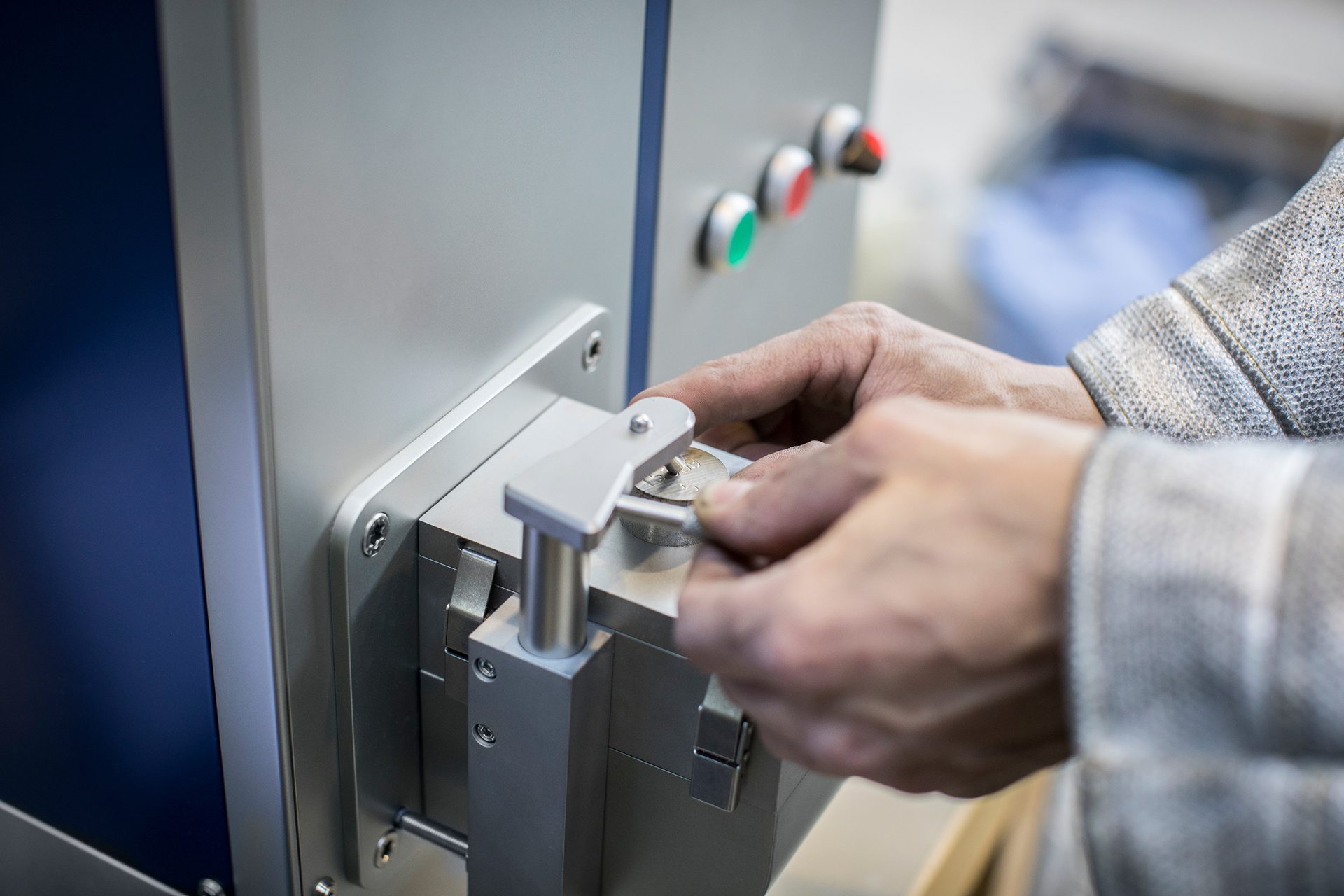

OES offers several practical advantages. It provides accurate detection of low-level elements essential for aluminum melt control and features rapid measurement cycles for efficient process monitoring. The spectrometers require straightforward sample preparation and are user-friendly, needing minimal specialized training. Additionally, its compact and durable design makes it suitable for placement near production lines.
OES works by comparing the intensity of emitted light to the concentration of the substances being analyzed. The spectrometer uses preprogrammed calibration curves to match light intensity with known concentrations, allowing for accurate composition analysis of unknown samples. Ensuring the analyzer is correctly calibrated is essential for reliable results.
Close-up of hands adjusting a metal disc in a machine for engraving.
Source: Hitachi High-Tech America Inc.
The Critical Role of OES Analyzers
Not all OES analyzers are created equal. It is necessary to verify that the analyzer meets the required specifications due to the demanding nature of aluminum alloy melt characteristics for gigacasting. The analyzer should be able to detect extremely low levels of phosphorus, antimony, calcium, and bismuth in near-eutectic and hypereutectic Al-Si alloys. It should also have fast start-up times to keep pace with high production throughput and use argon efficiently to help manage costs.
Aluminum alloys pose unique challenges when obtaining accurate measurements. Like other non-ferrous melts, aluminum alloys tend to segregate on solidification, leading to uneven concentrations of elements. For sampling, this means that the measurement may not accurately represent the melt. In practice, it is just a matter of following some simple instructions: pour the sample with a single drawing process, cool the sample quickly, and keep molds and other equipment scrupulously clean.
By following these steps, the risk of contamination or inaccurate measurements due to segregation can be significantly reduced, ensuring reliable analysis for aluminum megacasting processes.
OES also requires a flat, planar surface of the sample for accurate readings. This means the surface must be machined with a lathe or milling machine prior to analysis. The process must remove any oxides or other inclusions, and there must be a certain degree of surface roughness to aid the measurement. However, contamination should be avoided, and no single hard grains should be torn from the microstructure. Trial and error with the first samples may be necessary to optimize the process.
