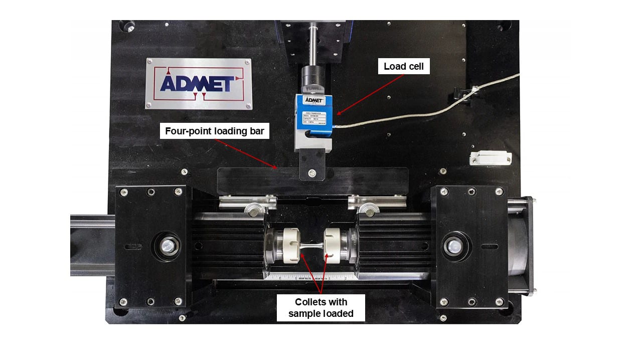

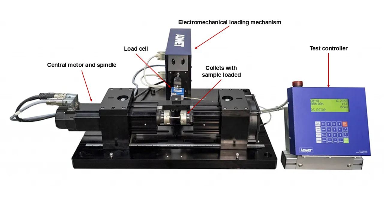

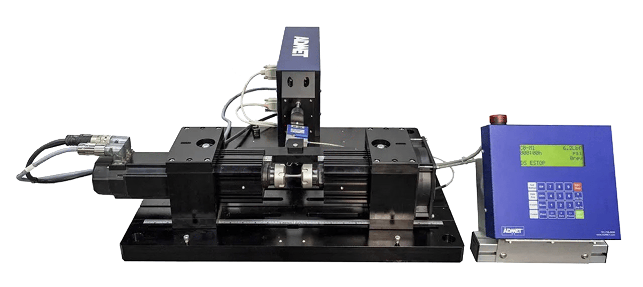

Shown in Figure 1, a typical rotating beam fatigue testing system includes the following components:
  • A central motor and spindle held by precision bearings
  • A pair of collets to securely hold the test sample
  • A loading mechanism, electromechanical or deadweight-driven, that applies bending moment
  • A load cell to measure and record the bending moment
  • A digital controller to control test parameters and record all data
ADMET testing machine with load cell, four-point loading bar, and sample in collets.
Labeled electromechanical testing machine showing a motor, load cell, sample collets, and a test controller.
Figure 1. A dual pivot four-point loading rotating beam fatigue testing system with a servo controlled bending moment actuator. (Top and Front View)
Most modern machines allow users to specify rotation speeds from 600 to 6,000 RPM, which is useful for testing different materials and for studies that compare results at different speeds. Rotating beam systems can generally produce bending moments up to 50Nm (445 inch-pounds) and conduct fully reversing fatigue tests at up to 100 Hz cyclic frequency. Four-point- and cantilever-loading configurations are most common, and four-point loading is considered superior to single point cantilever systems because they produce a constant bending moment along the entire length of the specimen.  Rotating beam fatigue testing systems are commonly fit with a furnace to characterize fatigue properties across a range of temperatures.

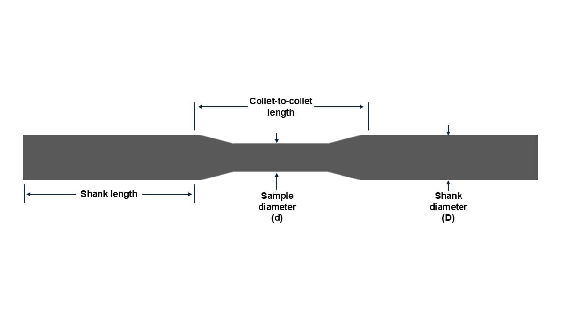

Most rotating beam fatigue testing is governed by ISO 1143 - Metallic materials — Rotating bar bending fatigue testing, which standardizes all test parameters and procedures for testing. All test samples must have a circular cross section, and have parallel, tapered, or hourglass geometries depending on how the bending moment is applied. The standard allows for a wide range of sample diameters and provides guidance on the fillet radius between the sample and shank diameters. Shank length is typically governed by the type of chuck or collet that is used to secure the test.  A rotating beam fatigue testing system with four point loading requires a parallel specimen sample geometry as shown in Figure 2.  Common sample diameters range from 2mm to 12 mm, however, larger sample diameters are possible.
Tensile test specimen showing shank length, collet length, sample (d) and shank (D) diameters.
Figure 2. Sample Dimensions for Rotating Beam Fatigue Testing.

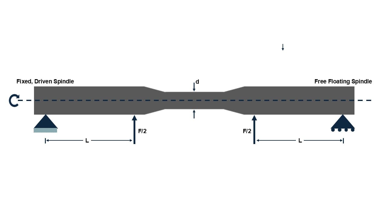

In the direct load four-point bending configuration shown in Figure 3, each spindle pivots about a point and the driven spindle is fixed whereas the pivot for the passive spindle rides on a linear bearing parallel to the axis of rotation. The linear bearing prevents axial forces as the specimen is flexed. A Force, F/2, is applied to each spindle a distance, L, from the pivot point thereby inducing only a pure bending moment to the specimen. When the specimen is rotated one half revolution, the stresses in the fibers originally below the neutral axis are reversed from tension to compression and vice versa. Upon completing the revolution, the stresses are again reversed so that during one revolution the test specimen passes through a complete cycle of tension and compression stresses.
Diagram of a rotating beam fatigue test: driven spindle, necked specimen, two F/2 loads.
Figure 3. Loading Pattern for Rotating Beam Fatigue Testing.
The bending stress formula for the direct load four-point bending moment mode is shown below. For other loading conditions, it is recommended to consult ISO 1143, Table 2.
Bending Stress, S = 16 × F × L/(π × d3)
Where,
S = applied bending stress in pascals.
F = total applied force in newtons (Note: The ISO 1143 specification defines, F, as the applied force to each spindle).
d = sample diameter in meters
L = force arm length (0.1m for eXpert 9300)
To give a feel for the range of bending stresses that a rotating beam fatigue testing machine can apply, a 20mm and 5mm diameter sample subjected to a 50Nm bending moment (at each spindle) generates a bending stress of 64MPa (9.2ksi) and 4,074MPa (591ksi), respectively.
