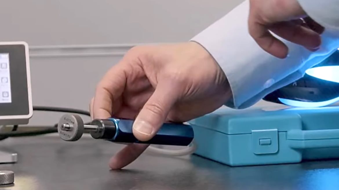

A person's hand holds a blue-handled tool with a metal disk, next to a display unit.

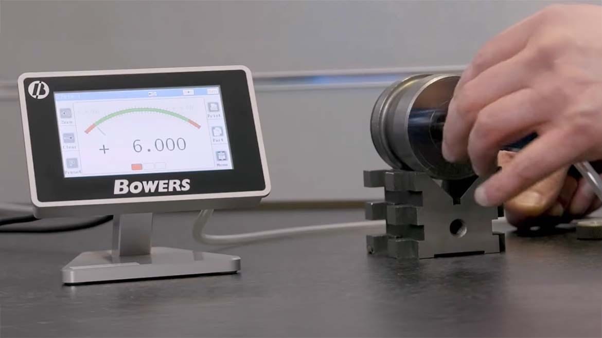

Hands measure a cylindrical part on a metal stand using a digital Bowers display showing 6.000.

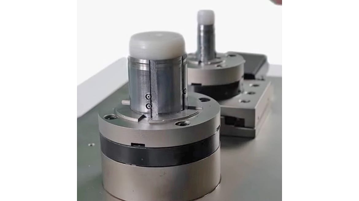

Close-up of two metallic industrial fixtures with white plastic caps, possibly chucks or testing equipment.
