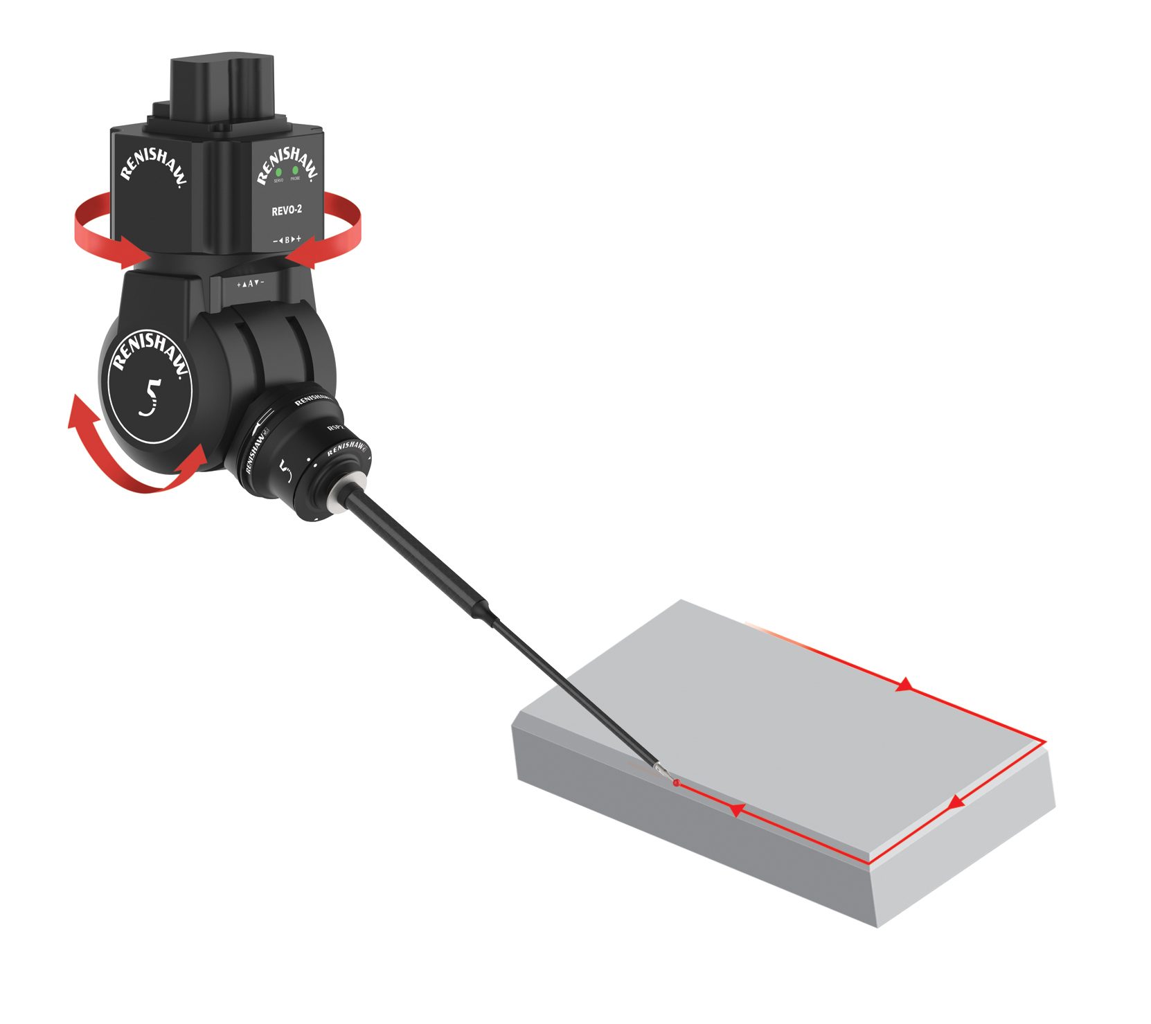

Unlike conventional 3-axis machines, 5-axis CMMs incorporate two additional axes of movement—often referred to as A and B—that are located within the probe head. These motorized rotary axes allow the probe to pivot and rotate with extraordinary dexterity. This innovation means that instead of repositioning the entire machine’s structure to access complex features, the probe head can simply tilt and turn itself into position. It’s a small change in physical motion, but a monumental one in terms of impact.
At its core, 5-axis CMM technology enables what can be thought of as a synchronized dance between machine and head. While the X, Y, and Z axes guide the overall location of the probe, the rotational axes fine-tune the angle, allowing measurements to be made from virtually any orientation, all in one smooth, continuous movement.

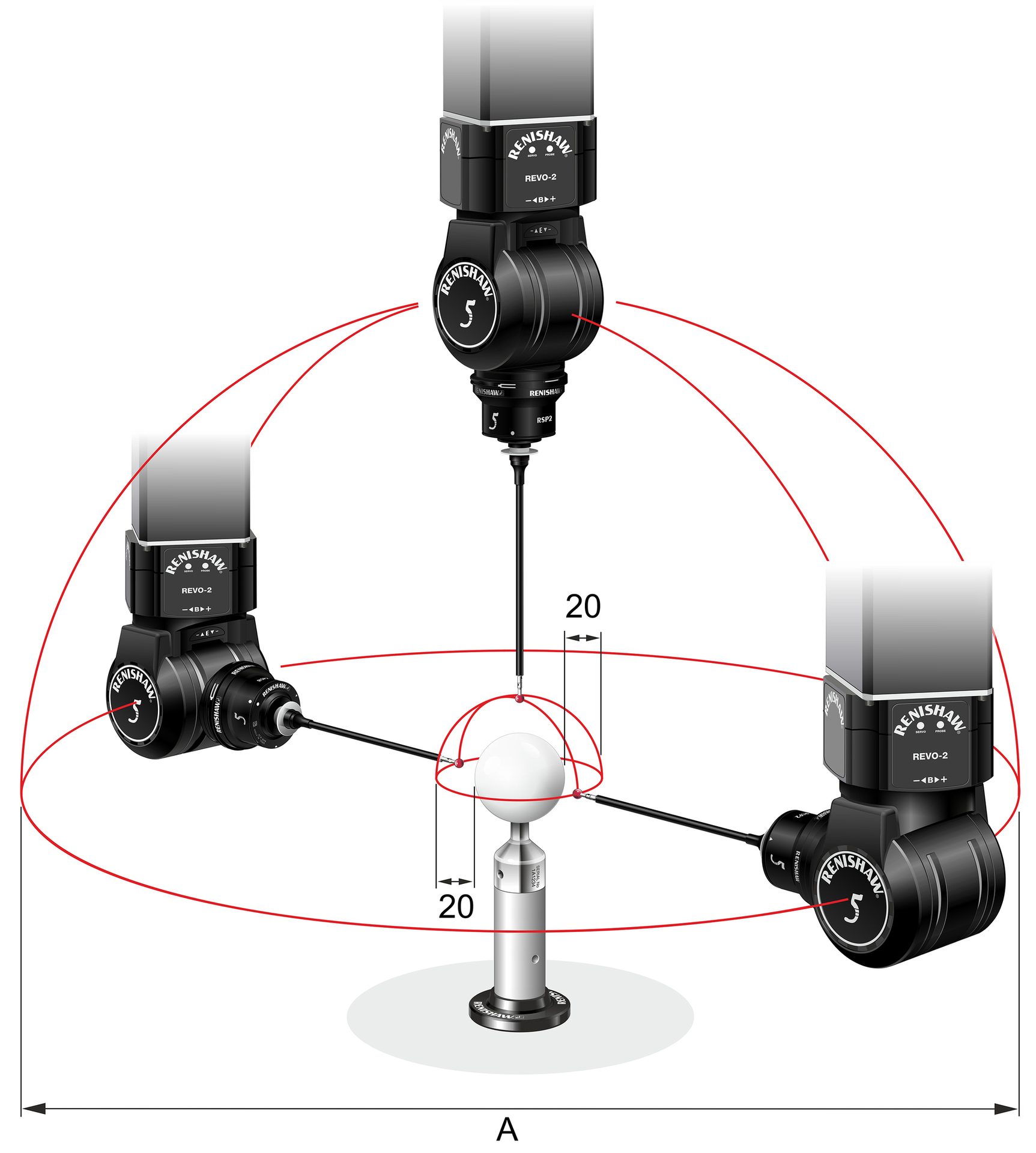

CMM Volume Necessary For The REVO System Calibration

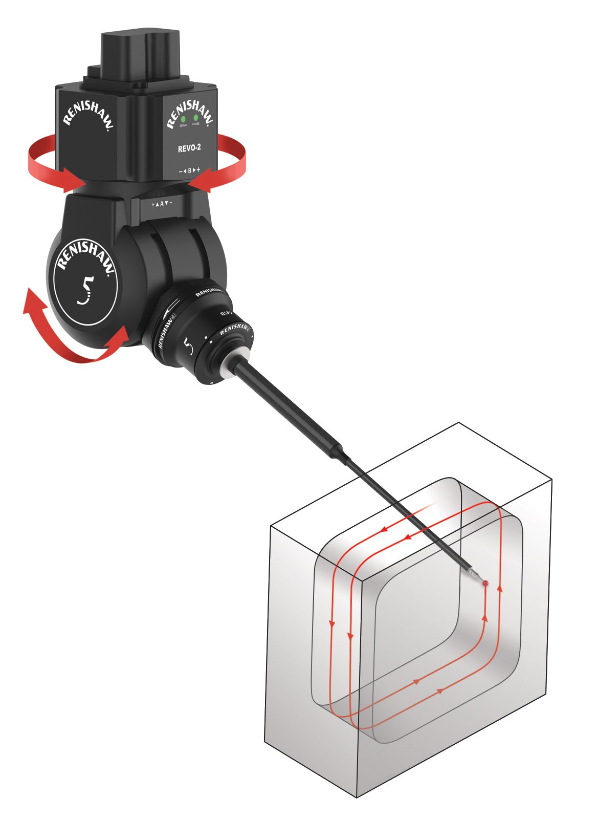

REVO 2 Curve Scan
REVO 2 Pocket Scan

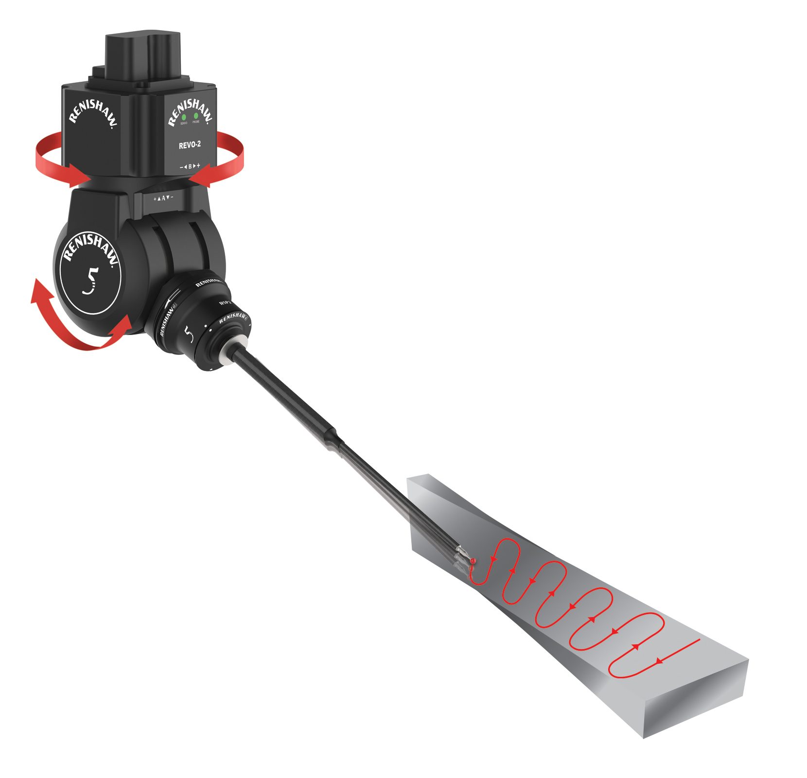

REVO 2 Spiral Scan

Inferred Calibration and Infinite Gains
Another major boost to productivity comes from inferred calibration. In traditional systems, every angle and stylus must be calibrated individually—a tedious and time-consuming process. With inferred calibration, systems determine the head orientation and probe position in a single operation. After initial setup, the probe can operate at any angle with minimal additional calibration.
This innovation drastically reduces preparation time and allows faster deployment of measurement routines, particularly valuable for high-mix, low-volume production environments where new part programs are developed frequently.

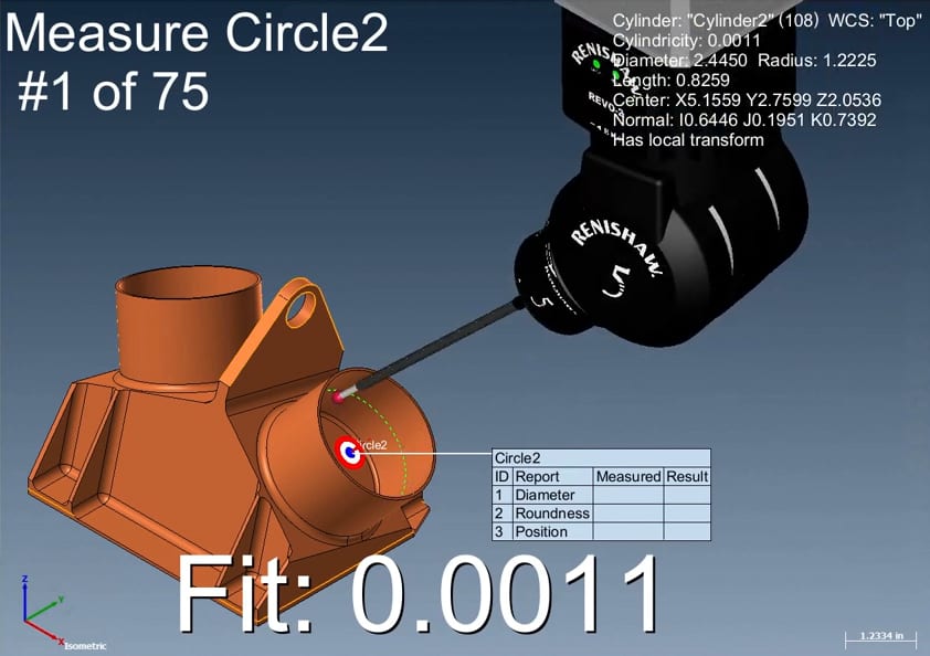

Measure Filter REVO Scan Crp

Extra Productivity from Software-Driven Techniques
Pre-programmed control features within metrology software can enable unique measurement techniques that further the speed and accuracy of 5-axis CMMs. Scanning techniques include Circle Scan, Edge Scan, Surface Sweep, Gasket Scan, Helical Scan, and Head Touches. As an example, here are three more software-driven scan techniques:
  • Curve Scan – Curve scan automates the measurement and reporting of small transitional surfaces and edges like fillets and chamfers used to reduce sharp edges and stress concentrations.
  • Pocket Scan – Pocket scan is used for rapid and automated inspection of isogrid and orthogrid structures that stiffen and save weight on aerospace panels and pressure vessels.
  • Spiral Scan – Spiral scan enables CMM programmers to accurately and quickly program and measure turbine blade or propeller surfaces while staying clear of neighboring blades.
