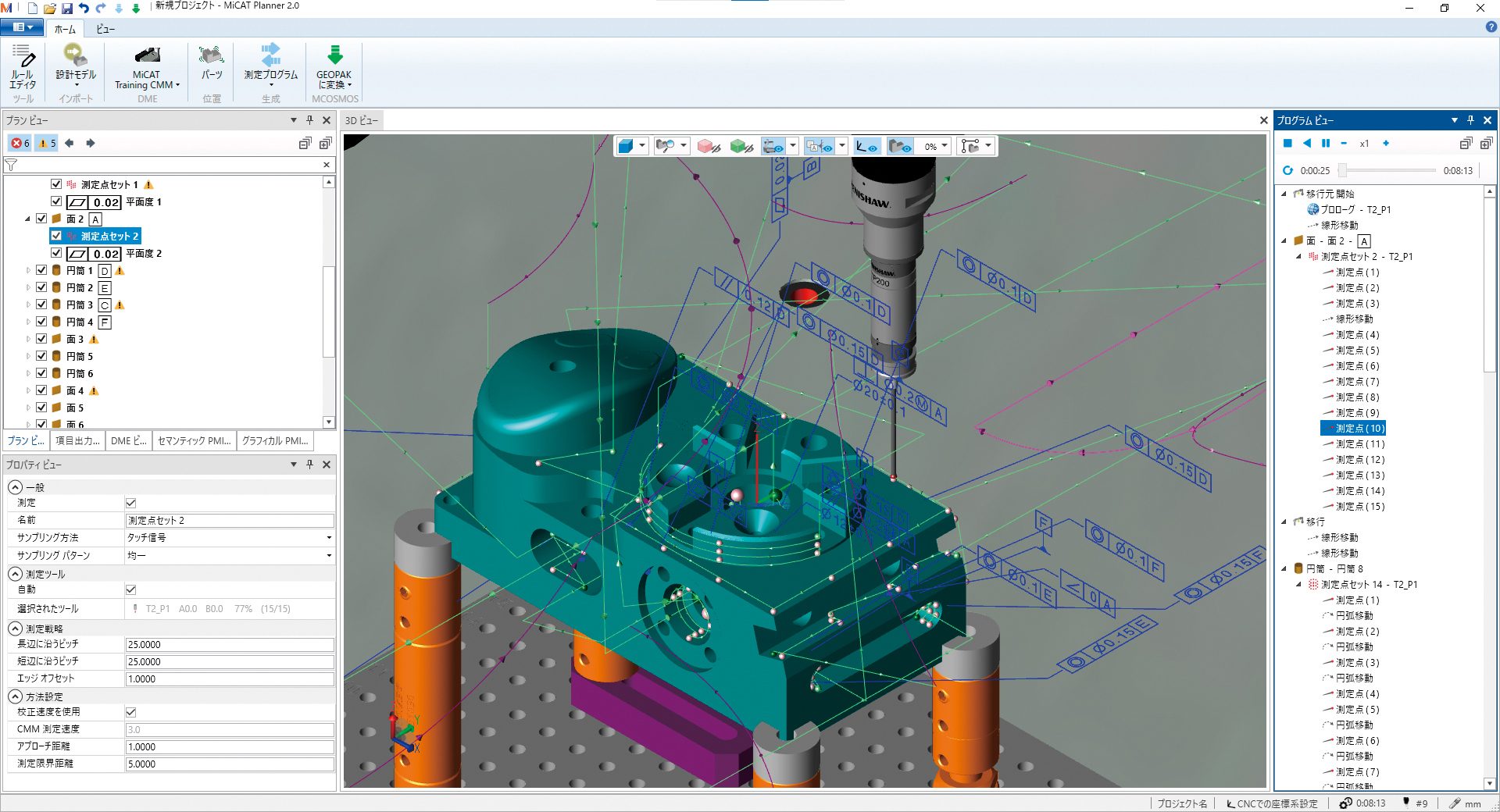

The inspection process begins with sophisticated planning software that utilizes a CMM’s configuration along with embedded Product Manufacturing Information (PMI) from native CAD models—including all geometric dimensioning and tolerancing (GD&T) annotations. Rather than manually scripting inspection routines, users simply load a CAD model, allowing the software to automatically identify features, assign measurement strategies, and generate optimized inspection plans. This significantly reduces probe changes, prevents collisions, and shortens inspection cycle times.
By removing the need for manual scripting or hand-coding inspection routines, automated planning software drastically reduces programming time—from hours down to mere minutes. The resulting output is a fully executable inspection program tailored for immediate use on CMM systems.

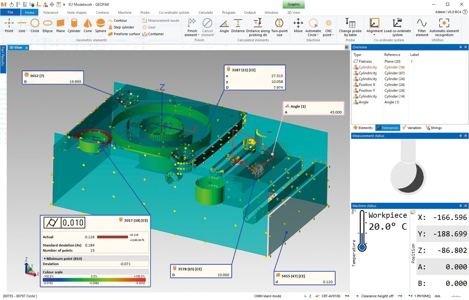

3D graphical displays can show measured components to capture the trend of deviations of a part’s components for simple visualized GD&T evaluations.

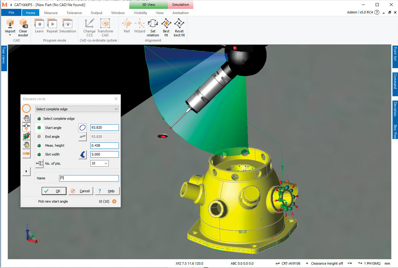

CMM software can import 3D CAD information for advanced interference checks, automatic changes of probe orientations, and more to create highly efficient measurement programs in much shorter times.
