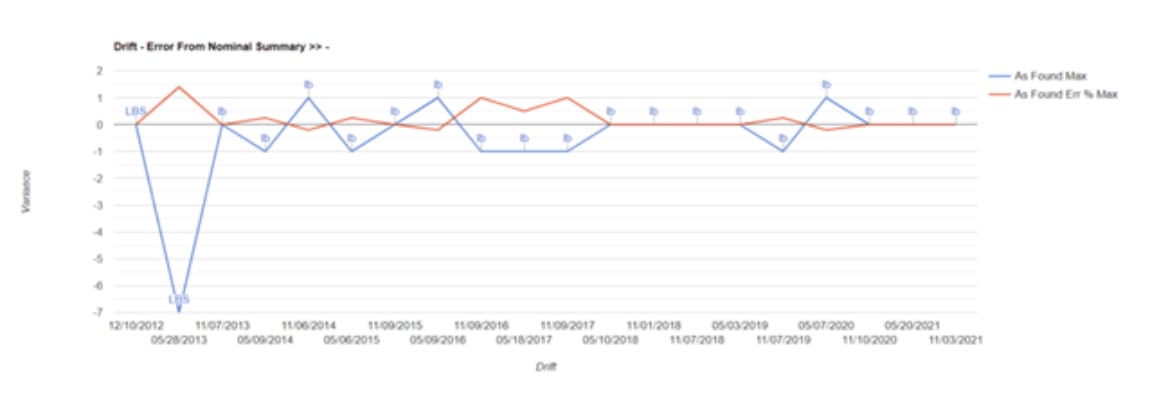

So how do I get started?
Most calibration software packages use real data from your calibration events to create charts showing your equipment’s’ drift trends over time. These charts can be easily viewed within the equipment record, giving you the information you need to make informed decisions about calibration frequency, maintenance, and eventual replacement.
Graph
In addition to helping with calibration frequency, drift analysis can also facilitate predictive maintenance of your gages, extending their useful life, which reduces replacement costs.

Graph courtesy of The Cross Company
