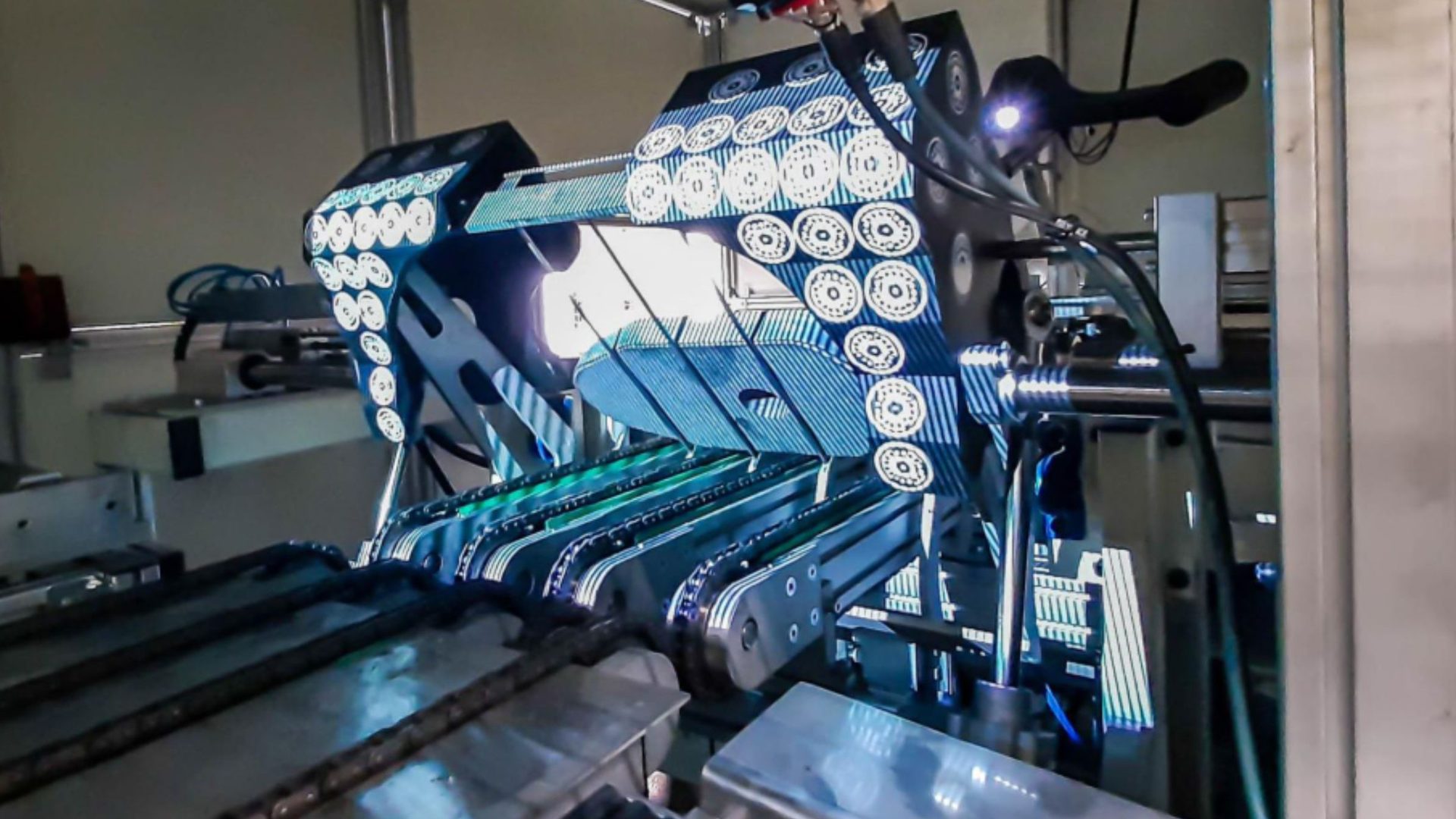

Multi-Scanner Measurement Platforms
To capture complete and detailed geometry of complex objects, multi-scanner configurations are often used. These systems employ two or more 3D scanners operating on a single measurement platform, enabling sequential or parallel scanning from multiple angles. Data from each scanner is automatically aligned and merged into a single high-resolution 3D model.
Each platform is tailored to specific use cases, with adjustable parameters such as measurement volume, resolution, accuracy, and sampling density. For areas that are hard to reach using optical methods alone, contact optical probes can be integrated into the system. Their measurements are merged with the scanned geometry to enhance data completeness.
With the right configuration, these systems can operate fully or semi-automatically, minimizing the need for operator involvement and ensuring repeatable, high-quality results.

Automated Scanning Stations
To further support inline inspection, automated scanning stations are being developed. These systems integrate a 3D scanner with linear positioning units and rotary tables, allowing fully automatic scanning from multiple positions and angles. Auto-calibration features are included to maintain measurement consistency over time.
Such solutions are ideal for serial inspection of repeatable components, where scanning and report generation must be performed continuously with minimal human supervision.
