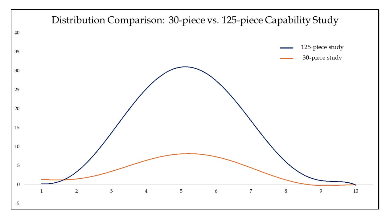

Comparison of Data Distributions
The histogram below shows the distribution difference between a 30-piece study and a 125-piece study. Both datasets are sampled from the same distribution (mean = 5, standard deviation = 1.5), but the larger sample size in the 125-piece study produces a more pronounced and representative distribution:
graph
As shown, the 30-piece histogram is more irregular due to its limited sample size, whereas the 125-piece histogram better approximates a normal distribution, resulting in statistical conclusions that are more reliable.
