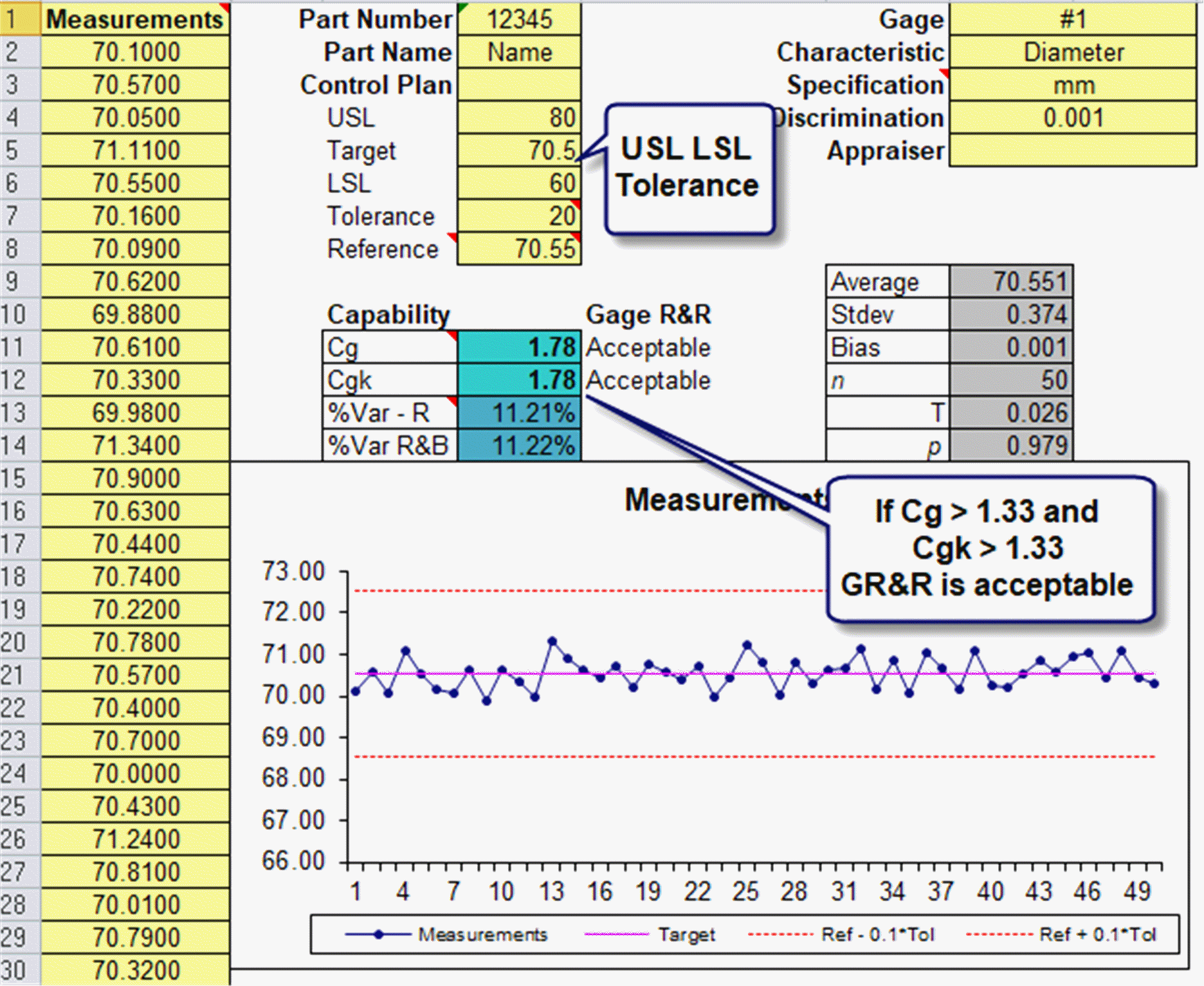

Type 1 GR&R uses one appraiser, one gage and 50 parts. It’s a good first step to assess your measurement system. Each part must have a known reference value (measured independently to a high degree of accuracy) and upper/lower specification limits or tolerance. Because the calculations are non-trivial, consider getting software to help with the analysis. Figure 1 shows a Type 1 GR&R where Cg and Cgk (capability) are greater than 1.33. The measurement system is acceptable.

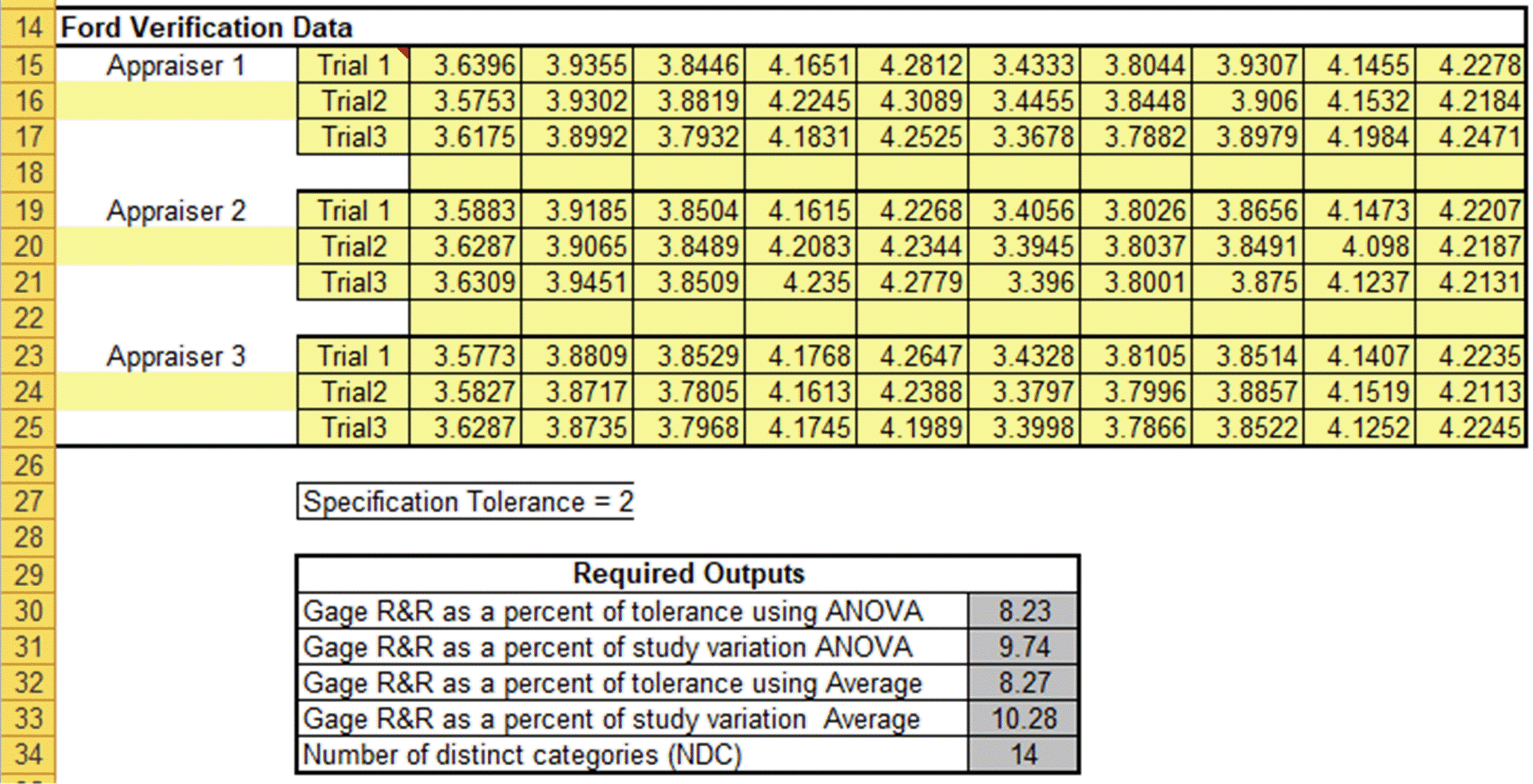

To conduct a Type 2 GR&R you will need a single gage, two or more appraisers and 5-10 parts. Label each part so that you know which one is being measured. Have each appraiser measure each part at least twice. Have them do it randomly so that they can’t remember what the previous value was. Then input the data into MSA software to analyze GR&R.
Ford® published verification data (Figure 2) that can be used to validate any MSA software.

The biggest mistake beginners make is using 10 parts from the middle of a production run. There won’t be enough part variation to get a good GR&R. You need bad parts to do a good GR&R or at least 5-10 parts that span the specification tolerance. You might want to pull parts from startup, middle and shutdown of a production. Or get parts from rework or scrap.

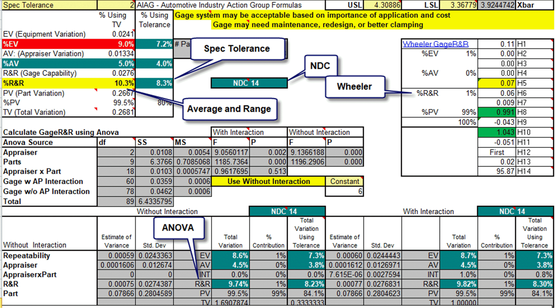

How will you know if you have enough part variation? There’s a calculation called NDC (Number of Distinct Categories) that must be greater than or equal to 5. Ford’s data has an NDC of 14. This example (Figure 3) shows all four methods:
Fig 3 Ford Verification GRR
Figure 7
Interpreting Results
If NDC >=5, then the analysis is straightforward. You will want most of the variation to be between the parts, and less than 10% to be caused by the measurement system (appraisers and equipment). In this case, the ANOVA method is less than 10% while the Average and Range method is just over 10%. If NDC < 5, there is not enough part variation to use either ANOVA or Average and Range Method.

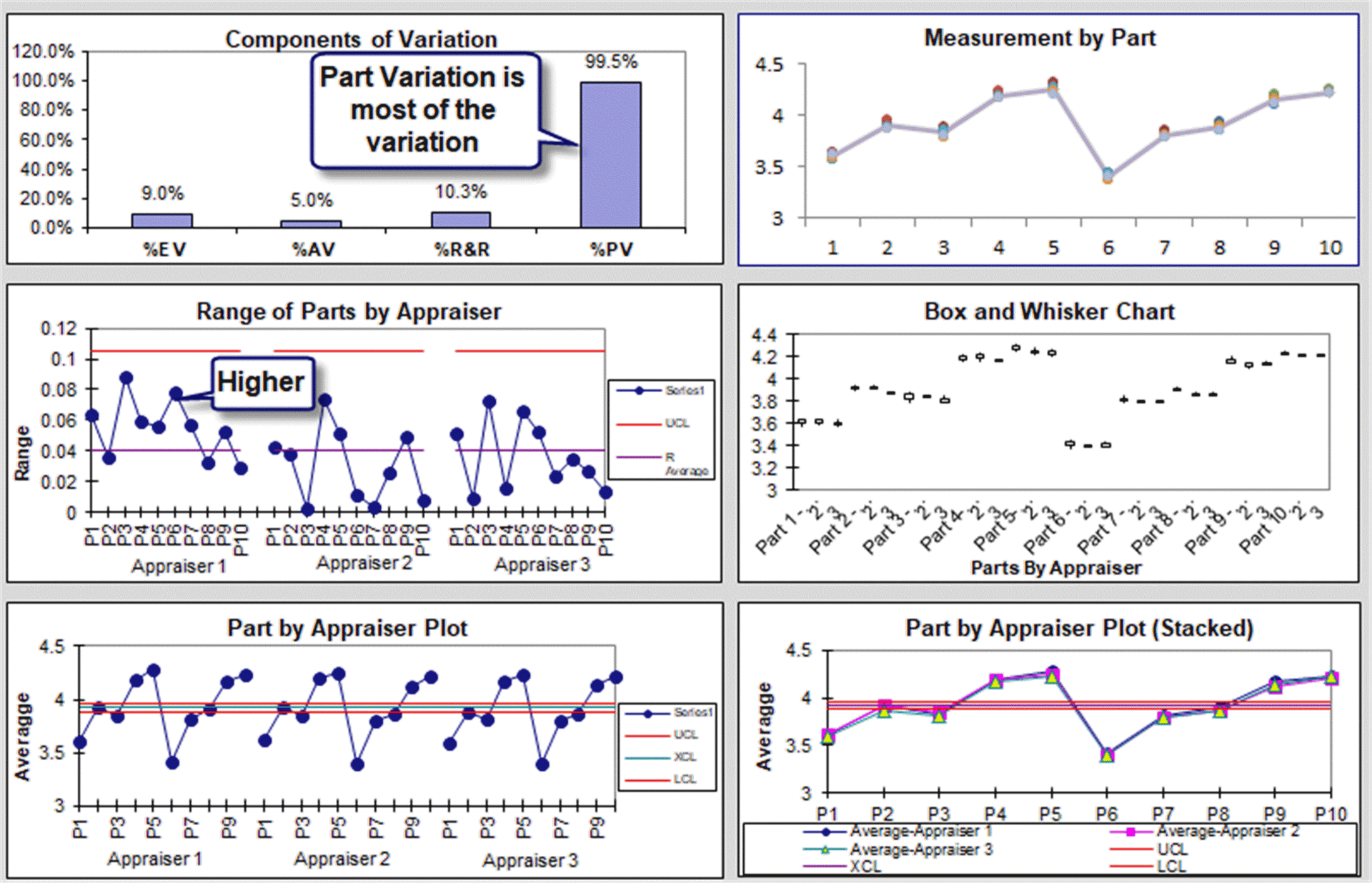

You can analyze the performance of each appraiser using graphs (Figure 4) provided by MSA software. Appraiser 1 range (variation) is slightly higher than appraisers 2 and 3.

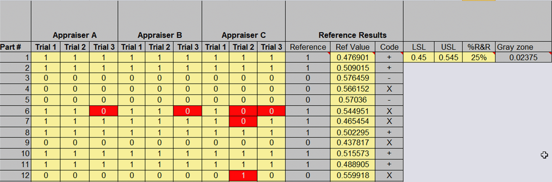

When using pass/fail gages or measurements, use attribute GR&R to access the measurement system. You will need 50 parts, 2-3 appraisers conducting 2-3 trials. You will also need reference measurements for each part measured to know if it passes or fails. Here’s an example from the AIAG (Figure 6). Each appraiser registers a pass (1) or fail (0) for each part three random times. This is compared to the reference value and spec limits. Red cells show errors. Appraiser C seems to have more misses.

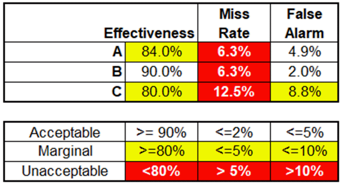

This is then used to assess the gage system. In this case the miss rate is too high (Figure 7). Appraiser C’s miss rate is almost twice as high as appraiser A and B, and the false alarm rate is too high. So, this measurement system needs improvement. Pass/fail gages can wear over time and cause problems with accuracy.
