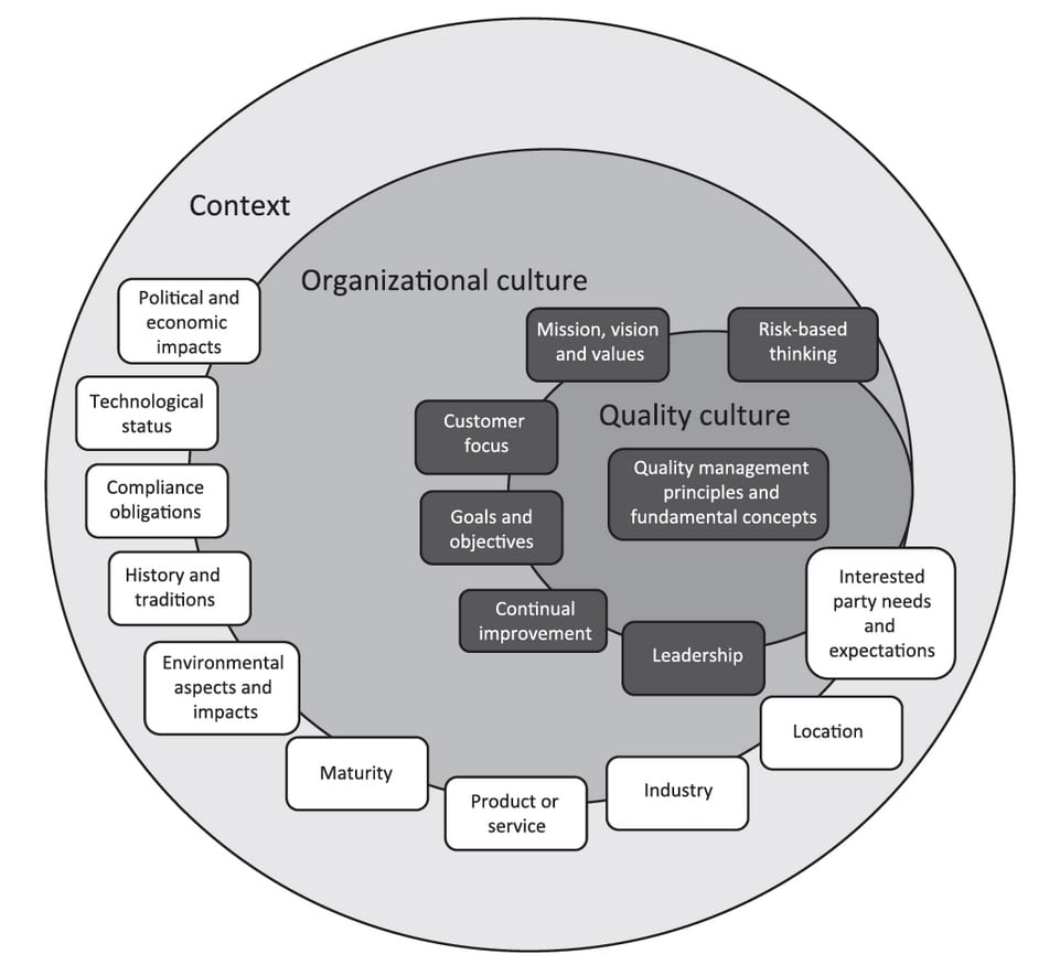

Leadership will now be required to demonstrate their active roles in several areas of culture including ethics, accountability and sustainability. Culture seems to be an underlying theme, and may be the most impactful, of what is coming. For more information on this, see ISO 10010:2022 Quality management — Guidance to understand, evaluate and improve organizational quality culture (figure 2 is from the ISO 10010).
Pull Quote
Example of a relationship between quality culture and organizational culture
Figure 2. Example of a relationship between quality culture and organizational culture.
The word culture may be missing directly in the new standards; however, it is becoming clear in the ongoing online discussions that registrar auditors will be adding this to audits very soon. For the ISO 14001, top management will need to be ready to demonstrate (and maybe even document) how they are actively involved in the environmental aspects and impacts for ethics impacts meeting government processes, accountability of the environment and for ongoing sustainability of the organization to meet any and all environment regulatory issues or customer requirements. This will need to be demonstrated for both 5.1 leadership and 9.3 management review.
