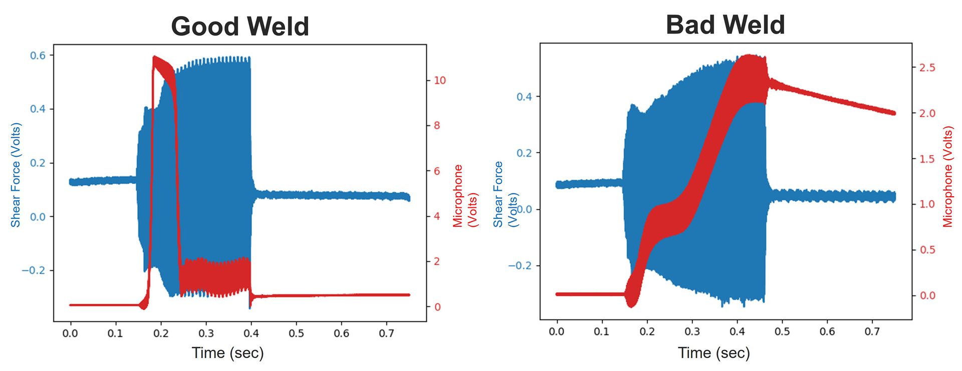

Another example comes from ultrasonic welding of lithium-ion battery tabs, a critical process in electric vehicle production. Traditional QA methods often rely on destructive testing and statistical sampling, which not only delay feedback but also carry hidden costs. Inspecting one part in a thousand means holding 999 units as work-in-progress until results are known. If the tested part fails, the entire batch may need to be scrapped — a costly outcome in high-volume production. To address these challenges in one project, process monitoring systems equipped with acoustic microphones were developed to capture the distinct sound signatures of good versus bad welds (Kitt and Corey, 2023). Machine learning models, trained on datasets that represented a range of production-relevant conditions, enabled real-time analysis of every weld.
Figure 2. Real-time QC in ultrasonic battery tab welding uses acoustic signal monitoring with machine learning to distinguish good vs. bad welds, enabling 100% in-line quality assessment and reducing costly scrap.
This approach provided 100% in-line quality assessment, giving manufacturers immediate feedback at production speeds. In addition to reducing scrap and rework, real-time QC revealed trends that could flag maintenance needs before downtime occurred. Inspection then becomes a continuous, predictive process, integrating quality assurance into production.
