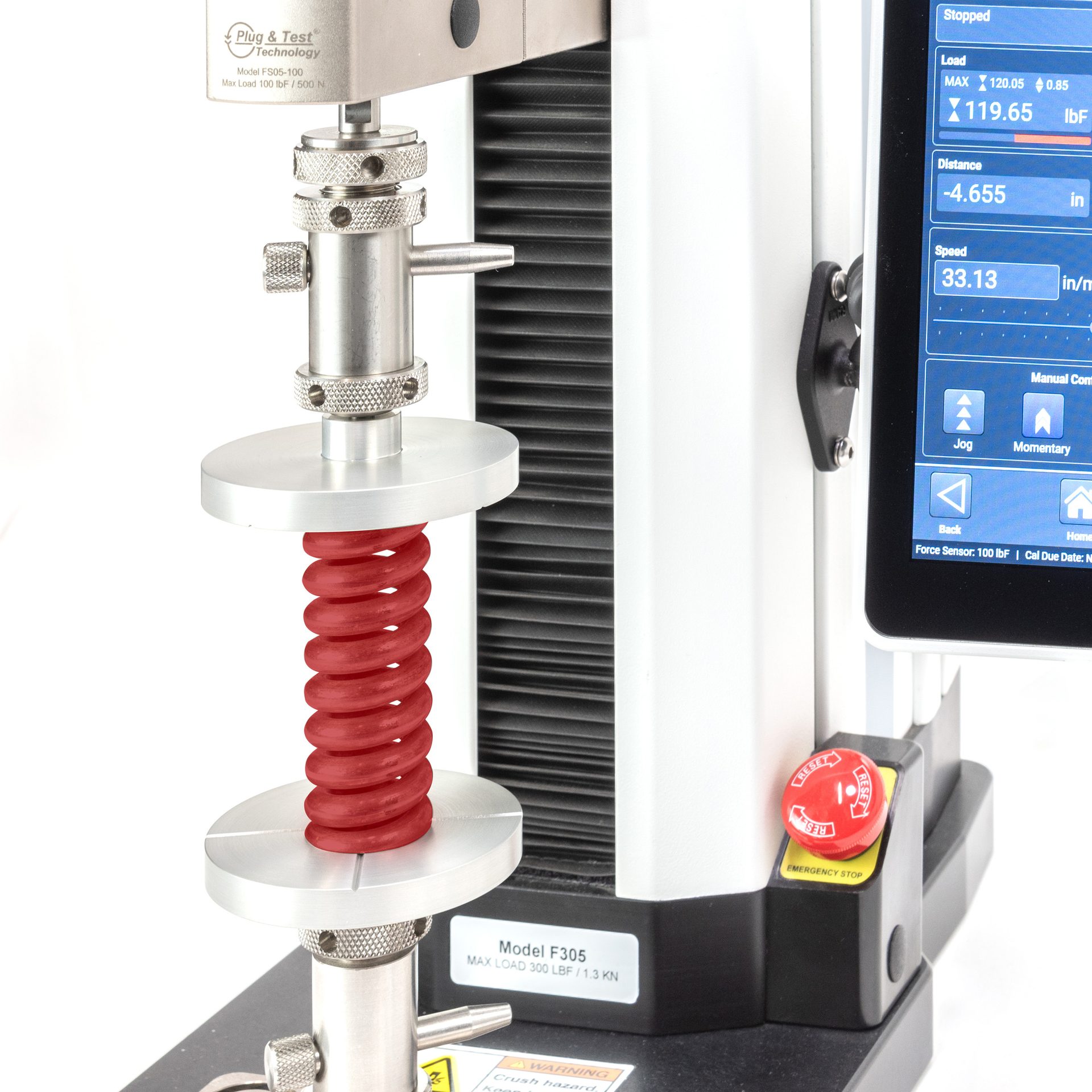

Spring Testing
Nearly every industry uses springs that require strength and durability testing to verify their form and function. Compression springs found in common everyday items such as pens and vehicle suspensions all require testing. Spring rate, load, and displacement are key characteristics of compression springs that can be quantified in compression force testing.

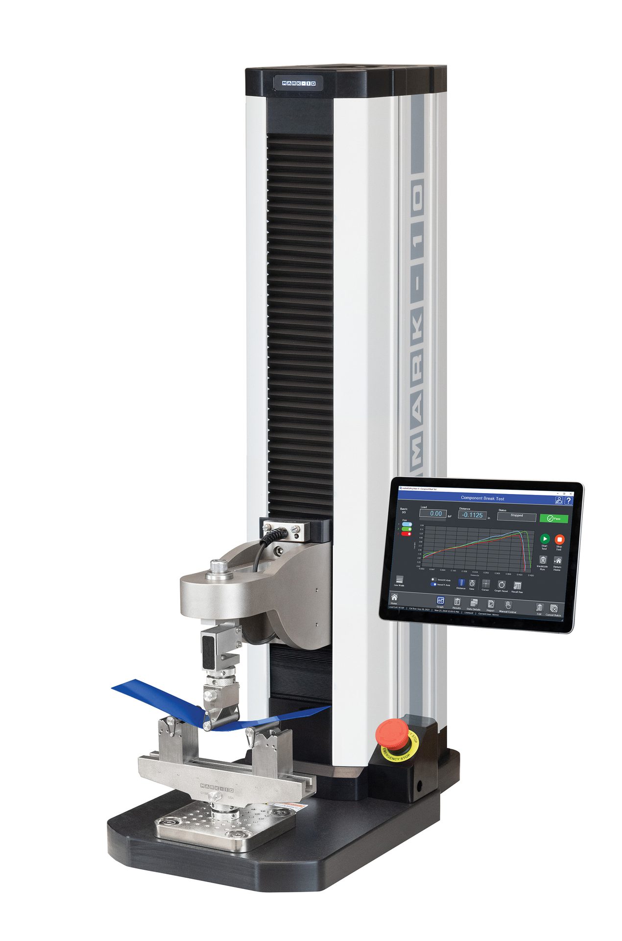

Also referred to as flexural testing, this process uses compression force loading to measure the behavior of material subjected to beam loading. Beam loading refers to the loading of a sample that is supported at one end or both ends. Bend tests typically involve compressing a sample to a specified load and measuring the distance or deflection of the sample at that load. In some cases, the load is applied until breakage occurs, with both peak load and displacement at break recorded. Common materials tested include ceramics, polymers, wood, composites, and concrete.

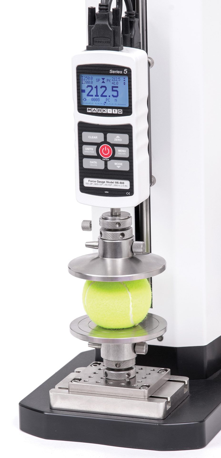

Applying and Measuring the Compressive Load - Equipment Needed
Force Test Frame
How will the load be applied to the sample and how much load needs to be applied? Force test frames are the most common type of actuator for controlled compression testing, allowing for fixed sample engagement not subject to the variability of handheld testing.
Motorized test frames are ideal for repeatable, accurate results due to their ability to maintain a constant rate of crosshead speed, a requirement of many testing standards. Motorized test frames can be programmed to compress automatically to a specified load or distance with minimal user interaction while it executes the test.
Manual test frames are economical and simple to use, but require the operator to apply the load manually via a handle or handwheel. They are less suitable for applications requiring guaranteed speed and travel distance. For example, top load testing requires a motorized system in order to automatically maintain a load for a period of time, while spring testing can be conducted with a manual frame.

How is the sample held in place during testing, and what grips or fixtures are necessary? For compression testing, the most basic setup is to place the sample between two compression plates. If the test is performed to a published standard, the test method may specify the characteristics of the required fixture. For example, in three- and four-point bend testing, fixtures involve upper and lower supports that make contact with the sample. In three-point tests, there are two contact points on the bottom and one on top, while four-point tests have two contact points on both top and bottom. Correct fixturing ensures uniform load application. Incorrect or off-center positioning can result in inaccurate data.
