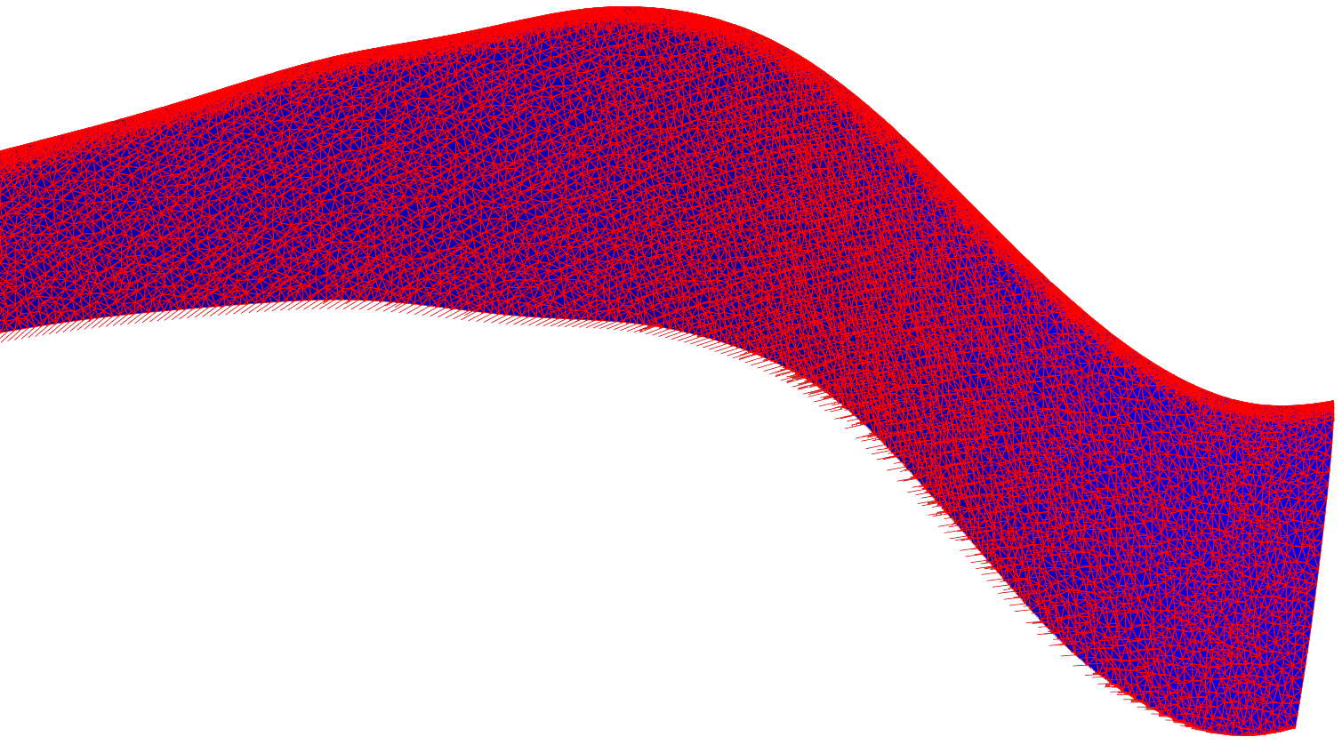

The developed advanced 3D scanning technique enhances this process by extracting the part geometry from CAD drawings, enabling precise C-Scan mapping that provides detailed information on both external and internal features of the inspected components. The motion control software associates the surfaces of the inspected part with the appropriate axes and creates virtual orthogonal scanning paths in a parametric space. This forms a rectangular grid where C-Scan pixels are recorded. The software then generates accurate trajectories for 3D phased array positioning along the calculated scanning paths, maintaining probe/array alignment with the calculated grid.
The following sequence illustrates the inspection of an aero-engine blade, starting with the sample surface extraction from the CAD model, followed by calculating the scanning trajectories to fully cover the part’s surface and produce the C-Scan inspection results.
Fig. 3: Surface extraction & creation of orthogonal axes trajectories from CAD sample
Caption
Font, Slope, Magenta, Plot
The final 3D scanning results provide detailed visualization of components and structure geometries, leading to more accurate flaw detection and characterization. This capability is particularly essential when inspecting complex composite materials and bonded structures, which are increasingly used in modern aircraft designs.
