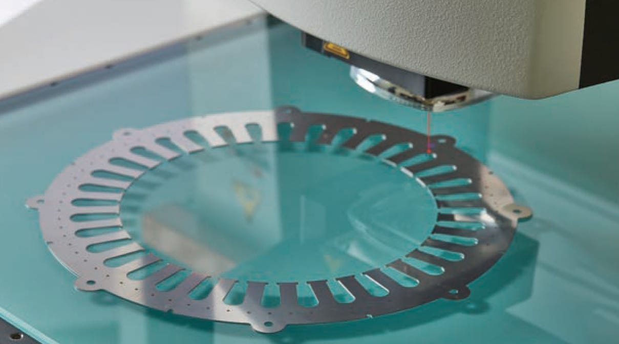

In place of traditional metrology tools, using an automated blue light 3D scanner to collect measurement data for verification further streamlines quality assurance for electric motor components through digitalization. For example, in modern electric motors, the electric conductors are assembled, bent and welded from solid copper wires to make a component known as a hairpin. The resulting geometries are challenging but necessary to inspect to ensure they conform to the correct specifications.
Hairpin-stator assemblies consist of more than 100 integrated hairpins that must be inspected accurately.Performing dimensional inspection to check that these components meet GD&T specifications is challenging with tactile measurement methods that must touch the part because these shiny, coated, and flexible components are touch-sensitive parts that deform easily. However, automated blue light 3D scanning is a high-precision noncontact solution for inspecting hairpins and other electric motor components. By automatically digitizing complete stators, single hairpins, and multiple hairpins simultaneously, EV manufacturers can quickly gain access to complete 3D measurement data from these components. Advanced 3D metrology software uses this data to generate an accurate geometric digital twin that can be used with MBD/PMI models to check GD&T specifications of electric motor components, including the complete hairpin-stator assembly, rotor and other parts requiring precision manufacturing.

Flatness: Evaluating the flatness of the end faces of the stator housing is critical. In the manufacturing process, the outer layers of the laminated sheet metal package may be bent upwards or displaced if there is a burr or an impurity pressed within the sheet, which causes deformation of the joining points on the sheet metal layout. Data visualization within advanced 3D metrology software allows the flatness to be evaluated across the entire surface, immediately revealing the areas failing to meet the quality requirements.
Cylindricity: The inner diameter of the stator and rotor is a vital characteristic of electric motors that can be examined within advanced 3D metrology software. The fit between the stator and rotor is critical to ensure the efficiency of the electric motor. With accurate digital twins derived from 3D scan data, the rotor and stator can be virtually assembled to verify the distance between the two components. Then the inside cylinder can be inspected for cylindricity or deviation from perfect form. Manufacturers can visualize the alignment or misalignment of individual sheets in the sheet metal package and understand where cylindricity is worsening or meeting specifications.
