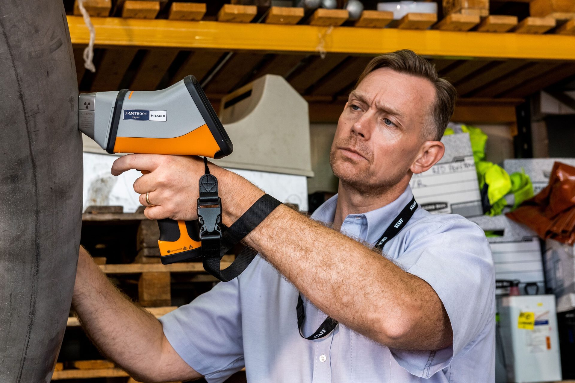

\u003cstrong >By Genevieve Diesing\u003c/strong>\u003c/h2>","children":[]},"type":"text","actions":["evzgM76O-vF"],"cl":"text pViDQGceF8e"},{"key":"ey8CZxxV-qO","content":{"children":[]},"type":"section","children":["ezsCGBtzoRu"],"cl":"section"},{"key":"e-70wxiFIUB","content":{"text":"\u003cp >Positive material identification, or PMI, is a method of nondestructive testing (NDT). It is as critical for quality control and assurance as it is for safety, says Matt Kreiner, head of global product management, Hitachi High-Tech.\u003c/p>\u003cp >The ability for producers to manufacture quality goods starts with having safe, reliable operations, and PMI is central to any mechanical integrity program, providing a quick way for inspectors to identify risk factors within the facility and avoid potentially hazardous situations, Kreiner says. \u003c/p>\u003cp >\u003cem >\u003c/em>\u003c/p>","children":[]},"type":"text","cl":"text pROFMlP3ix"},{"key":"etP7BtqELxp","content":{"text":"\u003ch3 >Positive Material Identification Made Easy\u003c/h3>\u003cp >Matt Kreiner, the head of Global Product Management at Hitachi High-Tech, discusses trends with PMI, how it can help manufacturers improve quality, and the benefits of on-site PMI.\u003c/p>","children":[]},"type":"text","cl":"text p9ADI1APNg"},{"key":"eC-5VNVhBRO","content":{"src":{"url":"https://cdn.vev.design/private/TrZjorIyzFVHDIUpGHunL0PSQdM2/images/RGoU4CVLwW/2100.png","key":"RGoU4CVLwW","ratio":2.7230392156862746},"children":[]},"type":"image","cl":"image"},{"key":"eVsCotRkxWS","content":{"controls":true,"auto":false,"variant":1,"rangeColor":"0c8484","rangeBg":"45506a","children":[],"upload":{"size":21230656,"name":"Matt-K.-Podcast.mp3","type":"audio/mpeg","url":"https://cdn.vev.design/private/MDn5NztIaBTfbgkYkIxdkiuvf5S2/k7t20-Matt-K.-Podcast.mp3"},"url":""},"type":"w781zgam","icons":{"play":[512,512,"M256 8C119 8 8 119 8 256s111 248 248 248 248-111 248-248S393 8 256 8zm115.7 272l-176 101c-15.8 8.8-35.7-2.5-35.7-21V152c0-18.4 19.8-29.8 35.7-21l176 107c16.4 9.2 16.4 32.9 0 42z"],"pause":[512,512,"M256 8C119 8 8 119 8 256s111 248 248 248 248-111 248-248S393 8 256 8zm-16 328c0 8.8-7.2 16-16 16h-48c-8.8 0-16-7.2-16-16V176c0-8.8 7.2-16 16-16h48c8.8 0 16 7.2 16 16v160zm112 0c0 8.8-7.2 16-16 16h-48c-8.8 0-16-7.2-16-16V176c0-8.8 7.2-16 16-16h48c8.8 0 16 7.2 16 16v160z"]},"cl":"w781zgam"},{"key":"ez71LKV8DUE","content":{"children":[],"cont":{"tablet":{"params":{"trigger":"Load","updated":1620835044440,"LoadAnimation":{"duration":3,"delay":0,"once":true,"translateX":["300px","0"],"preset":"slideInLeft","opacity":[0,1],"easing":"easeOutQuart"}}},"desktop":{"params":{"trigger":"Load","updated":1620835044440,"LoadAnimation":{"duration":3,"delay":0,"once":true,"translateX":["300px","0"],"preset":"slideInLeft","opacity":[0,1],"easing":"easeOutQuart"}}},"mobile":{"params":{"trigger":"Load","updated":1620835044440,"LoadAnimation":{"duration":3,"delay":0,"once":true,"translateX":["300px","0"],"preset":"slideInLeft","opacity":[0,1],"easing":"easeOutQuart"}}}}},"type":"w75y8u1c","cl":"w75y8u1c"},{"key":"eql94Ta9DZq","content":{"children":[]},"type":"frame","actions":["ez71LKV8DUE"],"children":["etP7BtqELxp","eC-5VNVhBRO","eVsCotRkxWS"],"cl":"frame"},{"key":"enDXno7VIxa","content":{"children":[]},"type":"section","children":["e-70wxiFIUB","eql94Ta9DZq"],"cl":"section"},{"key":"eqVcIzyHWdg","content":{"text":"\u003cp >“The materials comprising production equipment are carefully selected and specified to handle the process streams flowing through them at given temperatures and pressures,” Kreiner explains. “When there are mismatches between materials and chemicals, or when mistakes are made when replacing components, there is potential for accelerated corrosion and unintended chemical interactions that can result in physical or chemical properties being out of specification, or more violent reactions.”\u003c/p>\u003cp >Therefore, quality teams must establish a baseline of safety, using the right materials so that plant operators are able to run their processes as designed and produce goods to specifications at the expected volumes, with lower risk for unexpected failures, Kreiner adds.\u003c/p>\u003cp >PMI is employed in industries using metals and alloys to rapidly verify raw materials or check finished products, “ensuring materials comply with the specified grade or composition,” says Mathieu Bauer, senior application scientist and associate product manager for handheld XRF analyzers, Thermo Fisher Scientific.\u003c/p>\u003cp >PMI is essential in many industries where mission-critical metal alloys are used, such as in the power generation, oil and gas, aerospace and automotive industries, and the requirement for PMI of alloy materials has grown steadily. Today, PMI is a standard procedure in many industries for incoming inspections, material verification during manufacturing, and quality control of final products, says Esa Nummi, vice president, X-ray Mobile and Portable Analyzers, Bruker Nano GmbH.\u003c/p>\u003cp >There are several different techniques for the positive material identification (PMI) of metal alloys, with the most common being Handheld XRF (X-ray fluorescence), Optical Emission Spectroscopy (OES) and Laser Induced Breakdown Spectroscopy (LIBS), Nummi says.\u003c/p>\u003cp >The most widely used of these is XRF. Modern handheld XRF instruments are easy to use, provide fast and accurate analysis, and designed to withstand challenging industrial environments, Nummi says.\u003c/p>\u003cp >PMI using handheld XRF is critical for quality control, because it helps ensure that the correct alloys and grades are used. “PMI plays a critical role in quality control by verifying a material’s composition and ensuring product consistency,” Nummi says. “By confirmation of the desired material properties, PMI helps to guarantee product quality and reduce defects, rejections, and customer complaints.”\u003c/p>\u003cp >The absence of PMI in mission-critical industries can lead to several potential risks and consequences. These include safety, compliance, quality, reputation, and financial risks, experts say.\u003c/p>\u003cp >Omitting PMI can lead to the manufacture of parts comprised of inappropriate metals and alloys that could later fail, typically because they have lower corrosion resistance or inadequate physical properties, says Bauer. “This can result in serious consequences, especially when these parts are used in aircrafts or facilities such as nuclear power plants,” he says.\u003c/p>\u003cp >If you do not perform PMI, you are effectively flying blind, says Kreiner. “There may be hidden dangers directly in front of you and you wouldn’t even suspect it. Using the wrong material in the wrong place in an operation could result in premature failure of process equipment, products being out of specification, and safety hazards.”\u003c/p>\u003cp >The first two situations mostly carry monetary risks, but they are disruptive, slow down or stop production, and waste valuable resources in finding a resolution. And while it is easy to be alarmist about safety hazards, Kreiner says, material compatibility issues have been attributed to injuries, property damage, environmental impact and even death. \u003c/p>\u003cp >Depending on where in the world you operate, there are regulatory agencies – including OSHA– that establish behavioral requirements for plants to minimize these risks, he says. Not performing PMI risks non-conformance fines or other punishments.\u003c/p>\u003cp >Although they make look visually identical, different alloy grades can have significantly distinct properties, such as hardness, thermal differences, or corrosion resistance. This makes it, in many cases, impossible to differentiate between them without PMI, says Nummi.\u003c/p>\u003cp >“Using incorrect materials can pose significant risks in industries where safety is paramount,” Nummi says. “For example, in sectors such as aerospace, petrochemical and energy, the use of improper materials can compromise the structural integrity or functionality of components. This can result in catastrophic failures, accidents, or injuries. PMI helps ensure the right materials are used, minimizing these safety concerns.”\u003c/p>\u003cp >Without PMI, there is a higher risk of using incorrect or substandard materials in manufacturing processes. This can result in products not meeting the required quality standards, leading to performance issues, premature failure, or reduced durability. Quality control may be compromised, leading to product recalls or potential safety hazards. Implementing a PMI program helps mitigate these risks and ensures the use of correct and compliant materials.\u003c/p>\u003cp >\u003cem >Part 1 of 3 \u003c/em>\u003c/p>\u003cp >\u003ca target=\"_self\" tween=\"%7B%22tweenOut%22%3A%7B%22x%22%3A%5B-1%2C0%2C0%2C1%5D%2C%22time%22%3A0.5%7D%2C%22tweenIn%22%3A%7B%22x%22%3A%5B0.7%2C0%2C0%2C1%5D%2C%22time%22%3A0.5%7D%2C%22preset%22%3A%22parallax-to-left%22%7D\" href=\"/november-2023/ndt-feature-pmi-part-2/\">\u003cem >Part 2\u003c/em>\u003c/a>\u003c/p>\u003cp >\u003ca tween=\"%7B%22tweenOut%22%3A%7B%22x%22%3A%5B-1%2C0%2C0%2C1%5D%2C%22time%22%3A0.5%7D%2C%22tweenIn%22%3A%7B%22x%22%3A%5B0.7%2C0%2C0%2C1%5D%2C%22time%22%3A0.5%7D%2C%22preset%22%3A%22parallax-to-left%22%7D\" href=\"/november-2023/ndt-feature-pmi-part-3/\" target=\"_self\">\u003cem >Part 3\u003c/em>\u003c/a>\u003c/p>","children":[]},"type":"text","cl":"text pROFMlP3ix"},{"key":"eFzsVgCYKGd","content":{"children":[]},"type":"section","children":["eqVcIzyHWdg"],"cl":"section"},{"key":"eK1SVBAdBgT","content":{"text":"\u003ch4 >\u003cem >Opening Image \u003c/em>Source: Hitachi High-Tech \u003c/h4>","children":[]},"type":"text","cl":"text p9ADI1APNg"},{"key":"eHv338ah3i7","content":{"children":[]},"type":"section","children":["eK1SVBAdBgT"],"cl":"section"},{"key":"eivQFNtVoKU","content":{"children":[],"cont":{"tablet":{"params":{"trigger":"Load","updated":1617201661296,"LoadAnimation":{"duration":0.6,"delay":0,"once":true,"translateX":["300px","0"],"preset":"slideInLeft","opacity":[0,1],"easing":"easeOutQuart"}}},"desktop":{"params":{"trigger":"Load","updated":1617201661296,"LoadAnimation":{"duration":0.6,"delay":0,"once":true,"translateX":["300px","0"],"preset":"slideInLeft","opacity":[0,1],"easing":"easeOutQuart"}}},"mobile":{"params":{"trigger":"Load","updated":1617201661296,"LoadAnimation":{"duration":0.6,"delay":0,"once":true,"translateX":["300px","0"],"preset":"slideInLeft","opacity":[0,1],"easing":"easeOutQuart"}}}}},"type":"w75y8u1c","cl":"w75y8u1c"},{"key":"eFrcW4isP1c","content":{"text":"\u003ch1 >Genevieve Diesing is a contributing editor to Quality.\u003c/h1>","children":[]},"type":"text","actions":["eivQFNtVoKU"],"cl":"text pokWubE7CO"},{"key":"eR7lsfcah-w","content":{"shapeId":"riS-THb8c","children":[]},"type":"shape","cl":"shape"},{"key":"eie9M0lLv5a","content":{"shapeId":"7aRQpbvm9","children":[]},"type":"shape","cl":"shape"},{"key":"eOnrf1MEPgt","content":{"cont":{"tablet":{"params":{"trigger":"Load","updated":1617201191978,"LoadAnimation":{"duration":0.6,"delay":0,"once":true,"translateY":["0px","0px"],"translateX":["-300px","0px"],"scale":1.03,"preset":"staggerSlide","stagger":[0.15,"last"],"event":"bot","easing":"linear"}}},"desktop":{"params":{"trigger":"Load","updated":1617201191978,"LoadAnimation":{"duration":0.6,"delay":0,"once":true,"translateY":["0px","0px"],"translateX":["-300px","0px"],"scale":1.03,"preset":"staggerSlide","stagger":[0.15,"last"],"event":"bot","easing":"linear"}}},"mobile":{"params":{"trigger":"Load","updated":1617201191978,"LoadAnimation":{"duration":0.6,"delay":0,"once":true,"translateY":["0px","0px"],"translateX":["-300px","0px"],"scale":1.03,"preset":"staggerSlide","stagger":[0.15,"last"],"event":"bot","easing":"linear"}}}},"children":[]},"type":"w75y8u1c","cl":"w75y8u1c pgxkEqrg4x"},{"key":"eRehc47aZVZ","content":{"children":[]},"type":"frame","actions":["eOnrf1MEPgt"],"children":["eR7lsfcah-w","eie9M0lLv5a"],"cl":"frame"},{"key":"e3Q763WhzgE","content":{"children":[]},"type":"frame","children":["eFrcW4isP1c","eRehc47aZVZ"],"cl":"frame"},{"key":"ey2XBNHjMSp","content":{"children":[]},"type":"section","children":["e3Q763WhzgE"],"cl":"section"},{"key":"eIVwA1Sxf3O","content":{"children":[]},"type":"rectangle","cl":"rectangle"},{"key":"e3wG8Z5MryY","content":{"text":"\u003ch2 >UP NEXT\u003c/h2>","children":[]},"type":"text","cl":"text phkDpg-xDX"},{"key":"erkSj8WEk0r","content":{"text":"\u003ch2 >On-Site and Real-Time PMI Testing\u003c/h2>","children":[]},"type":"text","cl":"text phkDpg-xDX"},{"key":"eJELe10GDtX","content":{"children":[],"cont":{"tablet":{"params":{"trigger":"Load","updated":1696525323325,"LoadAnimation":{"duration":2,"delay":0,"once":true,"loop":false,"preset":"fadeIn","opacity":[0,1],"easing":"easeOutQuad"}}},"desktop":{"params":{"trigger":"Load","updated":1696525323325,"LoadAnimation":{"duration":2,"delay":0,"once":true,"loop":false,"preset":"fadeIn","opacity":[0,1],"easing":"easeOutQuad"}}},"mobile":{"params":{"trigger":"Load","updated":1696525323325,"LoadAnimation":{"duration":2,"delay":0,"once":true,"loop":false,"preset":"fadeIn","opacity":[0,1],"easing":"easeOutQuad"}}}}},"type":"w75y8u1c","cl":"w75y8u1c"},{"key":"eIAJyiNqje7","content":{"shapeId":"ZBBXEIlV6","children":[]},"type":"shape","actions":["eJELe10GDtX"],"cl":"shape"},{"key":"eCeGEWKPuYl","content":{"children":[]},"type":"frame","cl":"frame"},{"key":"ebsGa-GMvh4","content":{"children":[],"cont":{"tablet":{"params":{"trigger":"Load","updated":1696525257497,"LoadAnimation":{"duration":0.8,"delay":0,"once":false,"loop":"restart","translateX":["0px","11px"]}}},"desktop":{"params":{"trigger":"Load","updated":1696525257497,"LoadAnimation":{"duration":0.8,"delay":0,"once":false,"loop":"restart","translateX":["0px","11px"]}}},"mobile":{"params":{"trigger":"Load","updated":1696525257497,"LoadAnimation":{"duration":0.8,"delay":0,"once":false,"loop":"restart","translateX":["0px","11px"]}}}}},"type":"w75y8u1c","cl":"w75y8u1c"},{"key":"eLr5ffb0NA2","content":{"children":[]},"type":"frame","actions":["ebsGa-GMvh4"],"children":["eIAJyiNqje7","eCeGEWKPuYl"],"cl":"frame"},{"key":"eArAIc2ZaoM","content":{"src":{"key":"d6Iu6o7u8H","url":"https://cdn.vev.design/cdn-cgi/image/f=auto,q=82,w=1920/private/MDn5NztIaBTfbgkYkIxdkiuvf5S2/image/d6Iu6o7u8H.jpg","ratio":1.4999007345642248},"children":[]},"type":"image","cl":"image"},{"key":"eXLfXFVpTBE","content":{"children":[],"cont":{"tablet":{"params":{"trigger":"Load","updated":1696525209652,"LoadAnimation":{"duration":0.8,"delay":0,"once":true,"loop":false,"translateX":["-200px","0"],"preset":"slideInLeft","opacity":[0,1],"easing":"easeOutQuart"}}},"desktop":{"params":{"trigger":"Load","updated":1696525209652,"LoadAnimation":{"duration":0.8,"delay":0,"once":true,"loop":false,"translateX":["-200px","0"],"preset":"slideInLeft","opacity":[0,1],"easing":"easeOutQuart"}}},"mobile":{"params":{"trigger":"Load","updated":1696525209652,"LoadAnimation":{"duration":0.8,"delay":0,"once":true,"loop":false,"translateX":["-200px","0"],"preset":"slideInLeft","opacity":[0,1],"easing":"easeOutQuart"}}}}},"type":"w75y8u1c","cl":"w75y8u1c"},{"key":"eCRXc03DV-0","content":{"children":[],"link":{"mode":0,"tweenIn":{"x":[0.7,0,0,1],"time":0.5},"tweenOut":{"x":[-1,0,0,1],"time":0.5},"page":"pmblrtnY4Ea","preset":"parallax-to-left"}},"type":"external-link","cl":"external-link"},{"key":"edPTg-tHdn8","content":{"children":[]},"type":"frame","actions":["eXLfXFVpTBE","eCRXc03DV-0"],"children":["e3wG8Z5MryY","erkSj8WEk0r","eLr5ffb0NA2","eArAIc2ZaoM"],"cl":"frame"},{"key":"ejh8l-wLn23","content":{"shapeId":"ZeBVqduwS","children":[]},"type":"shape","cl":"shape"},{"key":"esd3Vyo6VyH","content":{"children":[]},"type":"section","children":["eIVwA1Sxf3O","edPTg-tHdn8","ejh8l-wLn23"],"cl":"section"},{"key":"e4SHH88tMxx","content":{"children":[]},"type":"section","cl":"section"},{"key":"eahlKPAd9-t","content":{"children":[]},"type":"section","cl":"section"},{"key":"pQ8YvlKNeQV","children":["eZZx1qasG4u","eh6IffIKIGc","ey8CZxxV-qO","enDXno7VIxa","eFzsVgCYKGd","eHv338ah3i7","ey2XBNHjMSp","esd3Vyo6VyH","e4SHH88tMxx","eahlKPAd9-t"]},{"key":"eULTaMCcJEW","content":{"children":[]},"type":"frame","cl":"frame"},{"key":"evW4BWpN8yT","content":{"children":[]},"type":"circle","cl":"circle"},{"key":"e5UR1eWOfhn","content":{"shapeId":"OQtPR0LzTK","children":[]},"type":"shape","cl":"shape"},{"key":"eUVxgIJzbQG","content":{"children":[],"link":{"mode":0,"tweenIn":{"x":[0.7,0,0,1],"time":0.5},"tweenOut":{"x":[-1,0,0,1],"time":0.5},"page":"pEGekpZOdJE"}},"type":"external-link","cl":"external-link"},{"key":"eWW-XKxQfQi","content":{"children":[]},"type":"frame","actions":["eUVxgIJzbQG"],"children":["evW4BWpN8yT","e5UR1eWOfhn"],"cl":"frame"},{"key":"eVLHJBu9Xt5","type":"circle","cl":"circle"},{"key":"eWQmR-WuEO9","content":{"shapeId":"zLg6eSYyGX"},"type":"shape","cl":"shape"},{"key":"e4HTE4unJUd","content":{"link":{"mode":2,"href":"https://www.dropbox.com/scl/fi/mtpc7denzj5rms4rrwo4g/QM1123.pdf?rlkey=c7xfvph7xcvgyb7j8uk1j5sqy&dl=1","target":false}},"type":"external-link","cl":"external-link"},{"key":"eagHxfa9Bhp","type":"frame","actions":["e4HTE4unJUd"],"children":["eVLHJBu9Xt5","eWQmR-WuEO9"],"cl":"frame"},{"key":"eXNKZJxJnaO","type":"circle","cl":"circle"},{"key":"ewn6gUILL_p","content":{"shapeId":"CnDmqlb26N"},"type":"shape","cl":"shape"},{"key":"ecaa7NdzzRf","content":{"link":{"mode":2,"href":"https://www.qualitymag.com/emagazine","target":true}},"type":"external-link","cl":"external-link"},{"key":"e89JsNEp4P9","type":"frame","actions":["ecaa7NdzzRf"],"children":["eXNKZJxJnaO","ewn6gUILL_p"],"cl":"frame"},{"key":"eXMj4xXKqII","type":"circle","cl":"circle"},{"key":"e13jvbYt7L2","content":{"text":"\u003cp >TOC\u003c/p>","children":[]},"type":"text","cl":"text"},{"key":"ehM-ucV0HuJ","content":{"link":{"mode":0,"tweenIn":{"x":[0.7,0,0,1],"time":0.5},"tweenOut":{"x":[-1,0,0,1],"time":0.5},"page":"pz_OlA9KBGa"}},"type":"external-link","cl":"external-link"},{"key":"eM7qy_-9ugr","type":"frame","actions":["ehM-ucV0HuJ"],"children":["eXMj4xXKqII","e13jvbYt7L2"],"cl":"frame"},{"key":"eB9230b8CRL","content":{"pageMenu":"Fg_FnAsIGL"},"type":"w1br1l0lsu-u06","icons":{"menu":[448,512,"M16 132h416c8.837 0 16-7.163 16-16V76c0-8.837-7.163-16-16-16H16C7.163 60 0 67.163 0 76v40c0 8.837 7.163 16 16 16zm0 160h416c8.837 0 16-7.163 16-16v-40c0-8.837-7.163-16-16-16H16c-8.837 0-16 7.163-16 16v40c0 8.837 7.163 16 16 16zm0 160h416c8.837 0 16-7.163 16-16v-40c0-8.837-7.163-16-16-16H16c-8.837 0-16 7.163-16 16v40c0 8.837 7.163 16 16 16z"]},"cl":"w1br1l0lsu-u06"},{"key":"eRLXxdFHVit","content":{"children":[]},"type":"circle","cl":"circle"},{"key":"ep3yxeKLASA","content":{"shapeId":"home-lg-alt-regular","children":[]},"type":"shape","cl":"shape"},{"key":"eM2p_Ew3IQX","content":{"children":[],"link":{"mode":0,"tweenIn":{"x":[0.7,0,0,1],"time":0.5},"tweenOut":{"x":[-1,0,0,1],"time":0.5},"page":"pEcfwj7pShT"}},"type":"external-link","cl":"external-link"},{"key":"evggzdnxz8E","content":{"children":[]},"type":"frame","actions":["eM2p_Ew3IQX"],"children":["eRLXxdFHVit","ep3yxeKLASA"],"cl":"frame"},{"key":"eW0tLxbysKR","content":{"shapeId":"6bDZsh2ar"},"type":"shape","cl":"shape"},{"key":"eXYU3ZsB8IH","content":{"text":"\u003cdiv>\u003cp >Scroll Down\u003c/p>\u003c/div>"},"type":"text","cl":"text"},{"key":"eqvo8Gz7lEl","content":{"cont":{"tablet":{"params":{"trigger":"Load","updated":1623176332445,"LoadAnimation":{"duration":1,"delay":1.5,"loop":true,"translateY":["-11px","11px"],"scale":1.05,"preset":"pulsate","opacity":[0,0.3],"easing":"easeInOutQuad"}}},"desktop":{"params":{"trigger":"Load","updated":1623176332445,"LoadAnimation":{"duration":1,"delay":1.5,"translateY":["-11px","11px"],"loop":true,"scale":1.05,"preset":"pulsate","opacity":[0,0.3],"easing":"easeInOutQuad"}}},"mobile":{"params":{"trigger":"Load","updated":1623176332445,"LoadAnimation":{"duration":1,"delay":1.5,"translateY":["-11px","11px"],"loop":true,"scale":1.05,"preset":"pulsate","opacity":[0,0.3],"easing":"easeInOutQuad"}}}}},"type":"w75y8u1c","cl":"w75y8u1c pyAxV2d2jzV"},{"key":"egRG5_et3Gn","type":"frame","actions":["eqvo8Gz7lEl"],"children":["eW0tLxbysKR","eXYU3ZsB8IH"],"cl":"frame"},{"key":"eggnD7Ye1fM","content":{"shapeId":"6bDZsh2ar"},"type":"shape","cl":"shape"},{"key":"e_9HNCZhbz5","content":{"text":"\u003cdiv>\u003cp >Scroll Down\u003c/p>\u003c/div>"},"type":"text","cl":"text"},{"key":"e6Snj2d2C-6","content":{"cont":{"tablet":{"params":{"trigger":"Load","updated":1623176320261,"LoadAnimation":{"duration":1,"delay":1.5,"translateY":["-11px","11px"],"loop":true,"scale":1.05,"preset":"pulsate","opacity":[0,0.3],"easing":"easeInOutQuad"}}},"desktop":{"params":{"trigger":"Load","updated":1623176320261,"LoadAnimation":{"duration":1,"delay":1.5,"translateY":["-11px","11px"],"loop":true,"scale":1.05,"preset":"pulsate","opacity":[0,0.3],"easing":"easeInOutQuad"}}},"mobile":{"params":{"trigger":"Load","updated":1623176320261,"LoadAnimation":{"duration":1,"delay":1.5,"loop":true,"translateY":["-11px","11px"],"scale":1.05,"preset":"pulsate","opacity":[0,0.3],"easing":"easeInOutQuad"}}}}},"type":"w75y8u1c","cl":"w75y8u1c pyAxV2d2jzV"},{"key":"eQadI1bnLec","type":"frame","actions":["e6Snj2d2C-6"],"children":["eggnD7Ye1fM","e_9HNCZhbz5"],"cl":"frame"},{"key":"esgNCKNoSo-","type":"frame","children":["egRG5_et3Gn","eQadI1bnLec"],"cl":"frame"},{"key":"e-KlN-Y7_S_","content":{"text":"\u003cp>Back To Quality Contents\u003c/p>"},"type":"text","cl":"text"},{"key":"eHd1JH2VxGl","content":{"shapeId":"6QUqbkTHm"},"type":"shape","cl":"shape"},{"key":"eLNaRsSraDo","content":{"link":{"mode":0,"tweenIn":{"y":[1,0,0,1],"time":0.5},"inFront":null,"tweenOut":{"y":[-1,0,0,1],"time":0.5},"page":"pz_OlA9KBGa"}},"type":"external-link","cl":"external-link"},{"key":"epfllWPeAVJ","type":"frame","actions":["eLNaRsSraDo"],"children":["e-KlN-Y7_S_","eHd1JH2VxGl"],"cl":"frame"},{"key":"e-P0bLVDgZ3","content":{"text":"\u003cdiv>\u003cp >Back To NDT Contents\u003c/p>\u003c/div>"},"type":"text","cl":"text"},{"key":"eFoMpOvCGE0","content":{"shapeId":"6QUqbkTHm"},"type":"shape","cl":"shape"},{"key":"eUY_3toUsZu","content":{"link":{"mode":0,"tweenIn":{"y":[1,0,0,1],"time":0.5},"tweenOut":{"y":[-1,0,0,1],"time":0.5},"page":"pgOvwlqM6Di"}},"type":"external-link","cl":"external-link"},{"key":"euWp8NQ4R5e","type":"frame","actions":["eUY_3toUsZu"],"children":["e-P0bLVDgZ3","eFoMpOvCGE0"],"cl":"frame"},{"key":"eliOB_Q5Zlr","content":{"text":"\u003cp>Back To Quality Contents\u003c/p>"},"type":"text","cl":"text"},{"key":"ea08PwckC9n","content":{"shapeId":"6QUqbkTHm"},"type":"shape","cl":"shape"},{"key":"eiwVh6rI2lw","content":{"link":{"mode":0,"tweenIn":{"y":[1,0,0,1],"time":0.5},"inFront":null,"tweenOut":{"y":[-1,0,0,1],"time":0.5},"page":"pz_OlA9KBGa"}},"type":"external-link","cl":"external-link"},{"key":"eBDqBQjBq5m","type":"frame","actions":["eiwVh6rI2lw"],"children":["eliOB_Q5Zlr","ea08PwckC9n"],"cl":"frame"},{"key":"e55cRDuZp0D","type":"frame","children":["euWp8NQ4R5e","eBDqBQjBq5m"],"cl":"frame"},{"key":"ecbHvrMmcjV","content":{"text":"\u003cdiv>\u003cp >Back To V&S Contents\u003c/p>\u003c/div>"},"type":"text","cl":"text"},{"key":"eJ-cSg0NHdf","content":{"shapeId":"6QUqbkTHm"},"type":"shape","cl":"shape"},{"key":"ejqDSChdieH","content":{"link":{"mode":0,"tweenIn":{"y":[1,0,0,1],"time":0.5},"inFront":null,"tweenOut":{"y":[-1,0,0,1],"time":0.5},"page":"p1_2miSt_Sl"}},"type":"external-link","cl":"external-link"},{"key":"ekc02ggG-Iz","type":"frame","actions":["ejqDSChdieH"],"children":["ecbHvrMmcjV","eJ-cSg0NHdf"],"cl":"frame"},{"key":"eGCEZFagO7x","content":{"text":"\u003cp>Back To Quality Contents\u003c/p>"},"type":"text","cl":"text"},{"key":"eby5Au6YVcd","content":{"shapeId":"6QUqbkTHm"},"type":"shape","cl":"shape"},{"key":"ej9G5pY5N3d","content":{"link":{"mode":0,"tweenIn":{"y":[1,0,0,1],"time":0.5},"inFront":null,"tweenOut":{"y":[-1,0,0,1],"time":0.5},"page":"pz_OlA9KBGa"}},"type":"external-link","cl":"external-link"},{"key":"ezaYDmdP8lB","type":"frame","actions":["ej9G5pY5N3d"],"children":["eGCEZFagO7x","eby5Au6YVcd"],"cl":"frame"},{"key":"eYLOGyrNnWb","type":"frame","children":["ekc02ggG-Iz","ezaYDmdP8lB"],"cl":"frame"},{"key":"eVAy2wrD7js","content":{"children":[],"nextText":"NEXT","prevText":"BACK","menu":"Fg_FnAsIGL"},"type":"w7Ty9ifjBD","icons":{"left":[512,512,"M256 504C119 504 8 393 8 256S119 8 256 8s248 111 248 248-111 248-248 248zm28.9-143.6L209.4 288H392c13.3 0 24-10.7 24-24v-16c0-13.3-10.7-24-24-24H209.4l75.5-72.4c9.7-9.3 9.9-24.8.4-34.3l-11-10.9c-9.4-9.4-24.6-9.4-33.9 0L107.7 239c-9.4 9.4-9.4 24.6 0 33.9l132.7 132.7c9.4 9.4 24.6 9.4 33.9 0l11-10.9c9.5-9.5 9.3-25-.4-34.3z"],"right":[512,512,"M256 8c137 0 248 111 248 248S393 504 256 504 8 393 8 256 119 8 256 8zm-28.9 143.6l75.5 72.4H120c-13.3 0-24 10.7-24 24v16c0 13.3 10.7 24 24 24h182.6l-75.5 72.4c-9.7 9.3-9.9 24.8-.4 34.3l11 10.9c9.4 9.4 24.6 9.4 33.9 0L404.3 273c9.4-9.4 9.4-24.6 0-33.9L271.6 106.3c-9.4-9.4-24.6-9.4-33.9 0l-11 10.9c-9.5 9.6-9.3 25.1.4 34.4z"]},"cl":"w7Ty9ifjBD"},{"key":"ekfJsRTS0dh","content":{"text":"\u003cp >November 2023 | Volume 62 | Number 11\u003c/p>"},"type":"text","cl":"text p6HrlJAsNN"},{"key":"eZY1deDWt01","content":{"link":{"mode":2,"href":"https://www.qualitymag.com/","target":true}},"type":"external-link","cl":"external-link"},{"key":"e_vvJb6Zz5Z","content":{"src":{"url":"https://cdn.vev.design/private/TrZjorIyzFVHDIUpGHunL0PSQdM2/images/w5UWC2HKL/2100.png","key":"w5UWC2HKL","ratio":null}},"type":"image","actions":["eZY1deDWt01"],"cl":"image"},{"key":"eb4NCUYNEfN","type":"frame","children":["ekfJsRTS0dh","e_vvJb6Zz5Z"],"cl":"frame"},{"key":"enb4-VJzaWL","type":"section","children":["eb4NCUYNEfN"],"cl":"section"},{"key":"eokUWuJ6YSH","content":{"where":"top","pos":0,"layer":0,"type":0,"dist":1000,"children":[]},"type":"w1cal72054-hh4","cl":"w1cal72054-hh4"},{"key":"eSycZiWhwJK","type":"section","actions":["eokUWuJ6YSH"],"cl":"section"},{"key":"fixed","visibility":{"eAuTGZt4TnY":true,"eM7qy_-9ugr":true,"eVAy2wrD7js":true,"eYLOGyrNnWb":{"pEpzTMtLF_u":true},"eWuxCqZpyCg":{},"enb7x6xihFG":{"pineHTGMASX":true,"pKkDvX_ZBUc":true,"pP7OBKqSChZ":true,"p9oM7F5iZ97":true,"p5sIjPTiJbQ":true,"pEGekpZOdJE":true,"pukde0n6got":true,"pkkwLC4EJ3U":true},"epfllWPeAVJ":{"pBD7-3bHnXr":true,"psLy5UL-wGa":true,"pN6dO3ZWGmw":true,"pMgEMTGJnHi":true,"pEGekpZOdJE":true,"pkkwLC4EJ3U":true,"pZ8h_Y8K7mS":true,"p0RGDAeoLCM":true,"piBmsoaM9eh":true,"pineHTGMASX":true,"pKkDvX_ZBUc":true,"pHDWi1-CrFW":true,"pv7dPBw0F8b":true,"pPfvJBwXGbO":true,"pMqxLMjVqEA":true,"pP7OBKqSChZ":true,"pQTy2TJHeMX":true,"pPWqYUHsuUx":true,"pEpzTMtLF_u":true,"p5sIjPTiJbQ":true,"pJ7il7rnNDv":true,"pODnpXM70Lw":true,"pBQBvDOYVos":true,"p5y_tVt18f4":true,"pn0FpS-xel_":true,"pgx3XeL6Djf":true,"pqSe-N-SL2t":true,"pAdtBsJrZvF":true,"pg3Nze5zdhh":true,"pe_BqtCjy_i":true,"plUR4As9Jg7":true,"pno2IP7OmkJ":true,"pj4zSLTHLvS":true,"pCkZt_r0Foc":true,"pEjRCV-VhHE":true,"p9oM7F5iZ97":true,"p1vtWDvfw6V":true,"pbSev6X6sRu":true},"eULTaMCcJEW":true,"esgNCKNoSo-":{"pEGekpZOdJE":true,"piBmsoaM9eh":true,"pHDWi1-CrFW":true,"plx8zAoyo53":true,"pPfvJBwXGbO":true,"pQTy2TJHeMX":true,"pEpzTMtLF_u":true,"pgOvwlqM6Di":true,"p5sIjPTiJbQ":true,"pJ7il7rnNDv":true,"pODnpXM70Lw":true,"pBQBvDOYVos":true,"pn0FpS-xel_":true,"pqSe-N-SL2t":true,"pAdtBsJrZvF":true,"pg3Nze5zdhh":true,"pQ8YvlKNeQV":true,"pj4zSLTHLvS":true,"pz_OlA9KBGa":true,"p9oM7F5iZ97":true,"p1vtWDvfw6V":true,"pRHcED2jjTq":true,"pBD7-3bHnXr":true,"pWCyJs__q54":true,"psLy5UL-wGa":true,"pN6dO3ZWGmw":true,"pS78MSQHEKK":true,"pTjQBEiKvrU":true,"pMgEMTGJnHi":true,"pkkwLC4EJ3U":true,"pZ8h_Y8K7mS":true,"p0RGDAeoLCM":true,"pKkDvX_ZBUc":true,"pineHTGMASX":true,"pv7dPBw0F8b":true,"p0mu_6NCg3t":true,"pFA3tiXnKFM":true,"pMqxLMjVqEA":true,"pP7OBKqSChZ":true,"pPWqYUHsuUx":true,"pJn4eWmeHt0":true,"p5y_tVt18f4":true,"pgx3XeL6Djf":true,"pe_BqtCjy_i":true,"plUR4As9Jg7":true,"pno2IP7OmkJ":true,"pCkZt_r0Foc":true,"pEjRCV-VhHE":true,"pbSev6X6sRu":true},"eWW-XKxQfQi":true,"eSycZiWhwJK":{"pRHcED2jjTq":"header","pWCyJs__q54":"header","psLy5UL-wGa":"header","pN6dO3ZWGmw":"header","pTjQBEiKvrU":"header","pS78MSQHEKK":"header","pI3UDQICcz9":"header","pEGekpZOdJE":"header","pt5t7h7JNR9":"header","pkkwLC4EJ3U":"header","pKkDvX_ZBUc":"header","pineHTGMASX":"header","pHDWi1-CrFW":"header","p0mu_6NCg3t":"header","pBt6-Qk_GqL":"header","plx8zAoyo53":"header","pMqxLMjVqEA":"header","pP7OBKqSChZ":"header","pQTy2TJHeMX":"header","pgOvwlqM6Di":"header","pEpzTMtLF_u":"header","pJn4eWmeHt0":"header","pWBdY7pTea0":"header","pJ7il7rnNDv":"header","pn0FpS-xel_":"header","pYWyZtc9SMS":"header","pg3Nze5zdhh":"header","pEcfwj7pShT":"header","pQ8YvlKNeQV":"header","pTtjSDgEEVm":"header","pCkZt_r0Foc":"header","pEjRCV-VhHE":"header","pz_OlA9KBGa":"header","p9oM7F5iZ97":"header","p1vtWDvfw6V":"header","pbSev6X6sRu":"header"},"eagHxfa9Bhp":true,"e5kNYPDwWv5":true,"ee_butjkkaG":true,"eB9230b8CRL":true,"efky3uToNeM":{},"e89JsNEp4P9":true,"edtc1d2SfMR":{"p8jn9ToAq5G":true,"p6Fc7Mutsw8":true,"pvK6-25loXq":true,"pv3zEpKsmxe":true,"pOJCRxYh_lZ":true,"pEGekpZOdJE":true,"pTyDPxbxMp8":true,"pukde0n6got":true,"pkkwLC4EJ3U":true,"pWVTLm5toot":true,"pKkDvX_ZBUc":true,"pineHTGMASX":true,"pP7OBKqSChZ":true,"pJ_OhtfMAuM":true,"p5sIjPTiJbQ":true,"pXjH-WWRLoW":true,"pEH9xUEnDz2":true,"plWDZKhp1k2":true,"pc4V4Jfq1JG":true,"plni1YaItpB":true,"pnRHLE-sHB8":true,"pAZ_jD7Tg8I":true,"pz_OlA9KBGa":true,"p9oM7F5iZ97":true,"p4BmFUB0xrr":true},"evggzdnxz8E":true,"e55cRDuZp0D":{"pRHcED2jjTq":true,"pQ8YvlKNeQV":true,"p0mu_6NCg3t":true,"pWCyJs__q54":true,"plx8zAoyo53":true,"pTjQBEiKvrU":true,"pS78MSQHEKK":true,"pYWyZtc9SMS":true,"pEpzTMtLF_u":true,"pJn4eWmeHt0":true},"efBfuRbn3pR":{"pEcfwj7pShT":true,"pKkDvX_ZBUc":true,"pineHTGMASX":true,"pz_OlA9KBGa":true,"pP7OBKqSChZ":true,"p9oM7F5iZ97":true,"p5sIjPTiJbQ":true,"pEGekpZOdJE":true,"pukde0n6got":true,"pkkwLC4EJ3U":true},"enb4-VJzaWL":{"pRHcED2jjTq":"footer","psLy5UL-wGa":"footer","pWCyJs__q54":"footer","pN6dO3ZWGmw":"footer","pS78MSQHEKK":"footer","pTjQBEiKvrU":"footer","pEGekpZOdJE":"footer","pt5t7h7JNR9":"footer","pkkwLC4EJ3U":"footer","pKkDvX_ZBUc":"footer","pineHTGMASX":"footer","pHDWi1-CrFW":"footer","p0mu_6NCg3t":"footer","plx8zAoyo53":"footer","pMqxLMjVqEA":"footer","pP7OBKqSChZ":"footer","pQTy2TJHeMX":"footer","pEpzTMtLF_u":"footer","pgOvwlqM6Di":"footer","pWBdY7pTea0":"footer","pJn4eWmeHt0":"footer","pJ7il7rnNDv":"footer","pn0FpS-xel_":"footer","pYWyZtc9SMS":"footer","pg3Nze5zdhh":"footer","pQ8YvlKNeQV":"footer","pTtjSDgEEVm":"footer","pCkZt_r0Foc":"footer","pEjRCV-VhHE":"footer","pz_OlA9KBGa":"footer","p9oM7F5iZ97":"footer","p1vtWDvfw6V":"footer","pbSev6X6sRu":"footer"},"eComjENRMPZ":true},"children":["eULTaMCcJEW","eWW-XKxQfQi","eagHxfa9Bhp","e89JsNEp4P9","eM7qy_-9ugr","eB9230b8CRL","evggzdnxz8E","esgNCKNoSo-","epfllWPeAVJ","e55cRDuZp0D","eYLOGyrNnWb","eVAy2wrD7js","enb4-VJzaWL","eSycZiWhwJK"]}],"pages":[{"key":"p0mu_6NCg3t","title":"NDT Feature PMI Part 2","desc":"Learn more about CNC and CMM machine trainer simulators.","cover":"https://cdn.vev.design/cdn-cgi/image/f=auto,q=82,h=628,w=1200,fit=crop/private/MDn5NztIaBTfbgkYkIxdkiuvf5S2/image/HTCOxiWNFp.jpg","path":"ndt-feature-pmi-part-2"},{"key":"p1vtWDvfw6V","title":"Quality 101","desc":"GD&T for EV - GD&T allows engineers to define feature relationships, ensuring proper alignment and interchangeability.","cover":"https://cdn.vev.design/cdn-cgi/image/f=auto,q=82,h=628,w=1200,fit=crop/private/TrZjorIyzFVHDIUpGHunL0PSQdM2/image/77-mm8l-C-.jpg","path":"quality-101"},{"key":"p9oM7F5iZ97","title":"Other Dimensions","desc":"","cover":"https://cdn.vev.design/private/TrZjorIyzFVHDIUpGHunL0PSQdM2/page-cover/pJJF96mwDbo/1629379989/1200.jpg","path":"other-dimensions"},{"key":"pBt6-Qk_GqL","title":"NDT Cover","desc":"","cover":"https://cdn.vev.design/cdn-cgi/image/f=auto,q=82,h=628,w=1200,fit=crop/private/MDn5NztIaBTfbgkYkIxdkiuvf5S2/image/gaoHlVrpP3.png","path":"ndt-cover"},{"key":"pCkZt_r0Foc","title":"Products","desc":"","cover":"https://cdn.vev.design/cdn-cgi/image/f=auto,q=82,h=628,w=1200,fit=crop/private/TrZjorIyzFVHDIUpGHunL0PSQdM2/image/l6V3kubJi3.jpg","path":"products"},{"key":"pEGekpZOdJE","title":"Navigation Guide","cover":"undefined/image/social/undefined/pEGekpZOdJE/v/0.jpg","path":"navigation-guide"},{"key":"pEcfwj7pShT","title":"Cover","desc":"Quality Magazine - Improving Your Manufacturing Process","cover":"https://cdn.vev.design/cdn-cgi/image/f=auto,q=82,h=628,w=1200,fit=crop/private/TrZjorIyzFVHDIUpGHunL0PSQdM2/image/vd6cwC7XRx.jpg","path":"","index":true},{"key":"pEjRCV-VhHE","title":"Column","desc":"Sampling Strategy — Manufacturing organizations find the following sampling strategies to be useful.\n","cover":"https://cdn.vev.design/cdn-cgi/image/f=auto,q=82,h=628,w=1200,fit=crop/private/TrZjorIyzFVHDIUpGHunL0PSQdM2/image/6ajX7qLMoe.jpg","path":"column"},{"key":"pEpzTMtLF_u","title":"-Feature","cover":"undefined/image/social/undefined/pEpzTMtLF_u/v/0.jpg","path":"-feature"},{"key":"pFA3tiXnKFM","title":"NDT Ad Carestream","desc":"","cover":"https://cdn.vev.design/cdn-cgi/image/f=auto,q=82,h=628,w=1200,fit=crop/private/MDn5NztIaBTfbgkYkIxdkiuvf5S2/image/7ylowLcK5-.png","path":"ndt-ad-carestream"},{"key":"pHDWi1-CrFW","title":"Contact Us","desc":"","cover":"https://cdn.vev.design/private/TrZjorIyzFVHDIUpGHunL0PSQdM2/images/rz9sbaCuX/500.jpg","path":"contact-us-copy"},{"key":"pI3UDQICcz9","title":"-Ad","desc":"","cover":"undefined/image/social/8KKeUeSU0C/pI3UDQICcz9/v/0.jpg","path":"-ad"},{"key":"pJ7il7rnNDv","title":"Management","desc":"A machine trainer: Safe and efficient shop floor training management","cover":"https://cdn.vev.design/cdn-cgi/image/f=auto,q=82,h=628,w=1200,fit=crop/private/TrZjorIyzFVHDIUpGHunL0PSQdM2/image/6LbA5eS4RS.jpg","path":"management"},{"key":"pJn4eWmeHt0","title":"NDT Feature Phased Array","desc":"One of PCI’s main strengths is detecting cracks that are vertical to the surface of the component.","cover":"https://cdn.vev.design/cdn-cgi/image/f=auto,q=82,h=628,w=1200,fit=crop/private/MDn5NztIaBTfbgkYkIxdkiuvf5S2/image/3Ua8ZOuPmd.jpg","path":"ndt-feature-phased-array"},{"key":"pKkDvX_ZBUc","title":"From the Editor","desc":"Where Does It End?","cover":"https://cdn.vev.design/private/TrZjorIyzFVHDIUpGHunL0PSQdM2/page-cover/p_m488rpbr-/1629378540/1200.jpg","path":"from-the-editor"},{"key":"pKqKM5JtUON","title":"Ad-House-The-Quality-Show","desc":"","cover":"https://cdn.vev.design/cdn-cgi/image/f=auto,q=82,h=628,w=1200,fit=crop/private/TrZjorIyzFVHDIUpGHunL0PSQdM2/image/Zh_CBiIJpb.jpg","path":"ad-house-the-quality-show"},{"key":"pMqxLMjVqEA","title":"Fellow Traveler","desc":"Stakeholders: Adroit Navigation for Managing Up and Across","cover":"https://cdn.vev.design/cdn-cgi/image/f=auto,q=82,h=628,w=1200,fit=crop/private/TrZjorIyzFVHDIUpGHunL0PSQdM2/image/fvdVdHUUhS.jpg","path":"fellow-traveler"},{"key":"pN6dO3ZWGmw","title":"Software & Analysis","desc":"Harnessing ChatGPT to Develop Calibration Procedures for Test and Measurement Equipment","cover":"https://cdn.vev.design/cdn-cgi/image/f=auto,q=82,h=628,w=1200,fit=crop/private/TrZjorIyzFVHDIUpGHunL0PSQdM2/image/S6-F3bp8Xo.jpg","path":"software--analysis"},{"key":"pP7OBKqSChZ","title":"Industry News","desc":"The latest news in the industry.","cover":"https://cdn.vev.design/private/TrZjorIyzFVHDIUpGHunL0PSQdM2/page-cover/pJY8hMSSPEL/1629221581/1200.jpg","path":"industry-news"},{"key":"pQ8YvlKNeQV","title":"NDT Feature PMI Part 1","desc":"PMI is a vital nondestructive testing method for quality assurance and safety.","cover":"https://cdn.vev.design/cdn-cgi/image/f=auto,q=82,h=628,w=1200,fit=crop/private/MDn5NztIaBTfbgkYkIxdkiuvf5S2/image/qMOme3omQx.jpg","path":"ndt-feature-pmi-part-1"},{"key":"pQTy2TJHeMX","title":"Directory Premium Sponsorships Index","desc":"","cover":"https://cdn.vev.design/private/TrZjorIyzFVHDIUpGHunL0PSQdM2/images/AuEtoxGCTJ/500.jpg","path":"directory-premium-sponsorships-index"},{"key":"pRHcED2jjTq","title":"NDT ASNT Column","desc":"As an inspector at the Johnson Space Center (JSC) there are opportunities to perform inspections on unique and one-of-a-kind products that make one feel special and proud to be part of such a great team.","cover":"https://cdn.vev.design/cdn-cgi/image/f=auto,q=82,h=628,w=1200,fit=crop/private/MDn5NztIaBTfbgkYkIxdkiuvf5S2/image/0JOwsB37Xl.jpg","path":"ndt-asnt-column"},{"key":"pS78MSQHEKK","title":"NDT Feature Compression","desc":"Understanding Compression Testing and Flexural Modulus, a Crucial Aspect of Material Strength Evaluation","cover":"https://cdn.vev.design/cdn-cgi/image/f=auto,q=82,h=628,w=1200,fit=crop/private/MDn5NztIaBTfbgkYkIxdkiuvf5S2/image/H91VQOQma5.jpg","path":"ndt-feature-compression"},{"key":"pTjQBEiKvrU","title":"NDT Feature Back 2 Basics","desc":"How the NDT legacy of liquid penetrant testing continues to thrive. ","cover":"https://cdn.vev.design/cdn-cgi/image/f=auto,q=82,h=628,w=1200,fit=crop/private/MDn5NztIaBTfbgkYkIxdkiuvf5S2/image/aSjraCmxn2.jpg","path":"ndt-feature-back-2-basics"},{"key":"pTtjSDgEEVm","title":"Advertiser Case Studies","desc":"This Case Studies Special Advertising Section features manufacturing companies with real-world challenges using quality equipment, software and services to solve their problems and improve their processes.","cover":"https://cdn.vev.design/cdn-cgi/image/f=auto,q=82,h=628,w=1200,fit=crop/private/TrZjorIyzFVHDIUpGHunL0PSQdM2/image/ZNySSDKKqd.jpg","path":"advertiser-case-studies"},{"key":"pUORgvfntjl","title":"Ad-House-Bookstore","desc":"","cover":"https://cdn.vev.design/cdn-cgi/image/f=auto,q=82,h=628,w=1200,fit=crop/private/TrZjorIyzFVHDIUpGHunL0PSQdM2/image/CgYMp_oVWT.jpg","path":"ad-house-bookstore"},{"key":"pWBdY7pTea0","title":"Corporate Profiles","desc":"This Corporate Profile Special Advertising Section features companies that offer quality equipment, software and services to help you solve problems and improve processes. ","cover":"https://cdn.vev.design/cdn-cgi/image/f=auto,q=82,h=628,w=1200,fit=crop/private/TrZjorIyzFVHDIUpGHunL0PSQdM2/image/zQOm3Zqfnt.jpg","path":"corporate-profiles"},{"key":"pWCyJs__q54","title":"NDT Feature PMI Part 3","desc":"The suite of tools available for PMI has grown. ","cover":"https://cdn.vev.design/cdn-cgi/image/f=auto,q=82,h=628,w=1200,fit=crop/private/MDn5NztIaBTfbgkYkIxdkiuvf5S2/image/F5gt5hhYhZ.jpg","path":"ndt-feature-pmi-part-3"},{"key":"pYWyZtc9SMS","title":"-NDT Feature","desc":"","cover":"undefined/image/social/7aWXSA4GPw/pYWyZtc9SMS/v/0.jpg","path":"-ndt-feature"},{"key":"paLHCSH6sQp","title":"Ad-House-Directories","desc":"","cover":"https://cdn.vev.design/cdn-cgi/image/f=auto,q=82,h=628,w=1200,fit=crop/private/TrZjorIyzFVHDIUpGHunL0PSQdM2/image/aw7W8Yd7yg.jpg","path":"ad-house-directories"},{"key":"pbSev6X6sRu","title":"Test & Inspection","desc":"What Product Quality Testing is Made of","cover":"https://cdn.vev.design/cdn-cgi/image/f=auto,q=82,h=628,w=1200,fit=crop/private/TrZjorIyzFVHDIUpGHunL0PSQdM2/image/_tVepuu-JQ.jpg","path":"test--inspection"},{"key":"pdPzhfpT6jB","title":"NDT Ad Quality Thank You","desc":"","cover":"https://cdn.vev.design/cdn-cgi/image/f=auto,q=82,h=628,w=1200,fit=crop/private/MDn5NztIaBTfbgkYkIxdkiuvf5S2/image/99ffjckWWC.png","path":"ndt-ad-quality-thank-you"},{"key":"pdQirWHH1tZ","title":"Ad-House-eNewsletters","desc":"","cover":"https://cdn.vev.design/cdn-cgi/image/f=auto,q=82,h=628,w=1200,fit=crop/private/TrZjorIyzFVHDIUpGHunL0PSQdM2/image/F60UNn_iVa.jpg","path":"ad-house-enewsletters"},{"key":"pg3Nze5zdhh","title":"Exit Strategy Series","desc":"How to Navigate the Path, Part 2","cover":"https://cdn.vev.design/cdn-cgi/image/f=auto,q=82,h=628,w=1200,fit=crop/private/TrZjorIyzFVHDIUpGHunL0PSQdM2/image/ktItjhSBKy.jpg","path":"exit-strategy-series"},{"key":"pgOvwlqM6Di","title":"NDT Table of Contents","desc":"","cover":"https://cdn.vev.design/cdn-cgi/image/f=auto,q=82,h=628,w=1200,fit=crop/private/TrZjorIyzFVHDIUpGHunL0PSQdM2/image/4pfDmsG73H.jpg","path":"ndt-table-of-contents"},{"key":"ph0f2E8-Ad6","title":"Ad-House-The-Quality-Show-South","desc":"","cover":"https://cdn.vev.design/cdn-cgi/image/f=auto,q=82,h=628,w=1200,fit=crop/private/TrZjorIyzFVHDIUpGHunL0PSQdM2/image/vcM_YKGOjB.jpg","path":"ad-house-the-quality-show-south"},{"key":"pineHTGMASX","title":"Face of Quality","desc":"","cover":"https://cdn.vev.design/private/TrZjorIyzFVHDIUpGHunL0PSQdM2/page-cover/pl9MW22VuYQ/1628604804/1200.jpg","path":"face-of-quality"},{"key":"pkkwLC4EJ3U","title":"Speaking of Quality","desc":"","cover":"https://cdn.vev.design/private/TrZjorIyzFVHDIUpGHunL0PSQdM2/page-cover/pKwc-T6tJV6/1631204523/1200.jpg","path":"speaking-of-quality"},{"key":"plx8zAoyo53","title":"NDT Feature Training","desc":"Industry veteran Charles Hellier discusses how to improve training within NDT.","cover":"https://cdn.vev.design/cdn-cgi/image/f=auto,q=82,h=628,w=1200,fit=crop/private/MDn5NztIaBTfbgkYkIxdkiuvf5S2/image/eDxtbRSvrt.jpg","path":"ndt-feature-training"},{"key":"pn0FpS-xel_","title":"ESG Part 2","desc":"How Manufacturing Organizations Can Meet Their ESG Goals: The Role of Quality Departments","cover":"https://cdn.vev.design/cdn-cgi/image/f=auto,q=82,h=628,w=1200,fit=crop/private/TrZjorIyzFVHDIUpGHunL0PSQdM2/image/cBKCxPeq4O.jpg","path":"esg-part-2"},{"key":"psLy5UL-wGa","title":"Measurement","desc":"Why More Manufacturers Should Consider Implementing a Vision Measurement System","cover":"https://cdn.vev.design/cdn-cgi/image/f=auto,q=82,h=628,w=1200,fit=crop/private/TrZjorIyzFVHDIUpGHunL0PSQdM2/image/2Ls7AseHtz.jpg","path":"measurement"},{"key":"psoI97ytXGT","title":"Ad-Mark-10-Corporation","desc":"","cover":"https://cdn.vev.design/cdn-cgi/image/f=auto,q=82,h=628,w=1200,fit=crop/private/TrZjorIyzFVHDIUpGHunL0PSQdM2/image/2bfXuatNa0.jpg","path":"ad-mark-10-corporation"},{"key":"pt5t7h7JNR9","title":"-VS Feature","desc":"","cover":"undefined/image/social/O2Fi2y-xm7/pt5t7h7JNR9/v/0.jpg","path":"-vs-feature-copy"},{"key":"pwE_Jb2Nmyr","title":"NDT Ad Quality House ad","desc":"","cover":"https://cdn.vev.design/cdn-cgi/image/f=auto,q=82,h=628,w=1200,fit=crop/private/MDn5NztIaBTfbgkYkIxdkiuvf5S2/image/aqO58YOCz2.jpg","path":"ndt-ad-quality-house-ad"},{"key":"pz_OlA9KBGa","title":"Table of Contents","cover":"https://cdn.vev.design/private/TrZjorIyzFVHDIUpGHunL0PSQdM2/page-cover/pAezecFzyC3/1632238161/1200.jpg","path":"table-of-contents"}],"shapes":{"6QUqbkTHm":[512,512,"M504 256C504 119 393 8 256 8S8 119 8 256s111 248 248 248 248-111 248-248zm-448 0c0-110.5 89.5-200 200-200s200 89.5 200 200-89.5 200-200 200S56 366.5 56 256zm189.1 129.9L123.7 264.5c-4.7-4.7-4.7-12.3 0-17l121.4-121.4c4.7-4.7 12.3-4.7 17 0l19.6 19.6c4.8 4.8 4.7 12.5-.2 17.2L211.2 230H372c6.6 0 12 5.4 12 12v28c0 6.6-5.4 12-12 12H211.2l70.3 67.1c4.9 4.7 5 12.4.2 17.2l-19.6 19.6c-4.7 4.7-12.3 4.7-17 0z"],"6bDZsh2ar":[448,512,"M207 477.5L12.7 283.1c-9.4-9.4-9.4-24.6 0-33.9l22.7-22.7c9.4-9.4 24.5-9.4 33.9 0l154.7 154 154.7-154c9.4-9.3 24.5-9.3 33.9 0l22.7 22.7c9.4 9.4 9.4 24.6 0 33.9L241 477.5c-9.4 9.3-24.6 9.3-34 0zm34-192L435.3 91.1c9.4-9.4 9.4-24.6 0-33.9l-22.7-22.7c-9.4-9.4-24.5-9.4-33.9 0L224 188.5 69.3 34.5c-9.4-9.3-24.5-9.3-33.9 0L12.7 57.2c-9.4 9.4-9.4 24.6 0 33.9L207 285.5c9.4 9.3 24.6 9.3 34 0z"],"7aRQpbvm9":[180.47,177.7,"M12.9 25.5A12.8 12.8 0 0 0 25.7 12.7 12.9 12.9 0 0 0 0 12.7 12.8 12.8 0 0 0 12.9 25.5","M12.9 177.7A12.7 12.7 0 1 0 0 165 12.8 12.8 0 0 0 12.9 177.7","M51.5 25.5A12.8 12.8 0 0 0 64.4 12.7a12.9 12.9 0 0 0-25.7 0A12.8 12.8 0 0 0 51.5 25.5","M51.5 63.5A12.7 12.7 0 1 0 38.7 50.8 12.8 12.8 0 0 0 51.5 63.5","M51.5 139.6a12.7 12.7 0 1 0-12.8-12.7 12.8 12.8 0 0 0 12.8 12.7","M51.5 177.7A12.7 12.7 0 1 0 38.7 165 12.8 12.8 0 0 0 51.5 177.7","M90.2 25.5A12.8 12.8 0 0 0 103.1 12.7a12.9 12.9 0 0 0-25.7 0A12.8 12.8 0 0 0 90.2 25.5","M90.2 63.5A12.7 12.7 0 1 0 77.4 50.8 12.8 12.8 0 0 0 90.2 63.5","M90.2 101.6A12.7 12.7 0 1 0 77.4 88.8a12.8 12.8 0 0 0 12.8 12.8","M90.2 139.6a12.7 12.7 0 1 0-12.8-12.7 12.8 12.8 0 0 0 12.8 12.7","M90.2 177.7A12.7 12.7 0 1 0 77.4 165 12.8 12.8 0 0 0 90.2 177.7","M128.9 63.5a12.7 12.7 0 1 0-12.8-12.7 12.8 12.8 0 0 0 12.8 12.7","M128.9 101.6a12.7 12.7 0 1 0-12.8-12.7 12.8 12.8 0 0 0 12.8 12.7","M128.9 139.6a12.7 12.7 0 1 0-12.8-12.7 12.8 12.8 0 0 0 12.8 12.7","M167.6 101.6a12.7 12.7 0 1 0-12.8-12.7 12.8 12.8 0 0 0 12.8 12.7"],"CnDmqlb26N":[576,512,"M575.33 456.43L399 8.02C397.28 3.1 392.61 0 387.65 0c-3.01 0-4.97 1.03-11.49 3.31-6.46 2.26-9.82 8.24-6.27 18.38-16.46 9.69-59.15 24.09-75.5 26.42-1.33-3.78-1.97-6.62-6.4-9.23V32c0-17.67-14.33-32-32-32h-96c-5.96 0-11.22 2.07-16 4.9C139.22 2.07 133.96 0 128 0H32C14.33 0 0 14.33 0 32v448c0 17.67 14.33 32 32 32h96c5.96 0 11.22-2.07 16-4.9 4.78 2.84 10.04 4.9 16 4.9h96c17.67 0 32-14.33 32-32V118.88l151.43 385.1c1.73 4.92 6.4 8.02 11.35 8.02 3 0 4.96-1.03 11.49-3.31 6.44-2.25 9.83-8.23 6.27-18.38 16.46-9.69 59.15-24.09 75.5-26.42 3.65 10.4 10.13 12.65 16.38 10.46l7.55-2.64c6.23-2.19 9.54-9.07 7.36-15.28zM128 480H32v-64h96v64zm0-96H32V128h96v256zm0-288H32V32h96v64zm128 384h-96v-64h96v64zm0-96h-96V128h96v256zm0-288h-96V32h96v64zm203.15 367.54L303.79 74.88c25.22-4.74 64.01-20.33 75.5-26.42l155.36 388.65c-25.23 4.75-64.01 20.33-75.5 26.43z"],"OQtPR0LzTK":[384,512,"M202.021 0C122.202 0 70.503 32.703 29.914 91.026c-7.363 10.58-5.093 25.086 5.178 32.874l43.138 32.709c10.373 7.865 25.132 6.026 33.253-4.148 25.049-31.381 43.63-49.449 82.757-49.449 30.764 0 68.816 19.799 68.816 49.631 0 22.552-18.617 34.134-48.993 51.164-35.423 19.86-82.299 44.576-82.299 106.405V320c0 13.255 10.745 24 24 24h72.471c13.255 0 24-10.745 24-24v-5.773c0-42.86 125.268-44.645 125.268-160.627C377.504 66.256 286.902 0 202.021 0zM192 373.459c-38.196 0-69.271 31.075-69.271 69.271 0 38.195 31.075 69.27 69.271 69.27s69.271-31.075 69.271-69.271-31.075-69.27-69.271-69.27z"],"ZBBXEIlV6":[384,512,"M363.8 264.5L217 412.5c-4.7 4.7-12.3 4.7-17 0l-19.8-19.8c-4.7-4.7-4.7-12.3 0-17L298.7 256 180.2 136.3c-4.7-4.7-4.7-12.3 0-17L200 99.5c4.7-4.7 12.3-4.7 17 0l146.8 148c4.7 4.7 4.7 12.3 0 17zm-160-17L57 99.5c-4.7-4.7-12.3-4.7-17 0l-19.8 19.8c-4.7 4.7-4.7 12.3 0 17L138.7 256 20.2 375.7c-4.7 4.7-4.7 12.3 0 17L40 412.5c4.7 4.7 12.3 4.7 17 0l146.8-148c4.7-4.7 4.7-12.3 0-17z"],"ZeBVqduwS":[320,512,"M288.662 352H31.338c-17.818 0-26.741-21.543-14.142-34.142l128.662-128.662c7.81-7.81 20.474-7.81 28.284 0l128.662 128.662c12.6 12.599 3.676 34.142-14.142 34.142z"],"home-lg-alt-regular":[576,512,"M570.24 215.42L323.87 13a56 56 0 0 0-71.75 0L5.76 215.42a16 16 0 0 0-2 22.54L14 250.26a16 16 0 0 0 22.53 2L64 229.71V288h-.31v208a16.13 16.13 0 0 0 16.1 16H496a16 16 0 0 0 16-16V229.71l27.5 22.59a16 16 0 0 0 22.53-2l10.26-12.3a16 16 0 0 0-2.05-22.58zM464 224h-.21v240H352V320a32 32 0 0 0-32-32h-64a32 32 0 0 0-32 32v144H111.69V194.48l.31-.25v-4L288 45.65l176 144.62z"],"riS-THb8c":[180.47,177.7,"M12.9 63.5A12.7 12.7 0 1 0 0 50.8 12.8 12.8 0 0 0 12.9 63.5","M12.9 101.6A12.7 12.7 0 1 0 0 88.8a12.8 12.8 0 0 0 12.9 12.8","M12.9 139.6A12.7 12.7 0 1 0 0 126.9a12.8 12.8 0 0 0 12.9 12.7","M51.5 101.6A12.7 12.7 0 1 0 38.7 88.8a12.8 12.8 0 0 0 12.8 12.8","M128.9 25.5a12.7 12.7 0 1 0-12.8-12.8 12.8 12.8 0 0 0 12.8 12.8","M128.9 177.7A12.7 12.7 0 1 0 116.1 165a12.8 12.8 0 0 0 12.8 12.7","M167.6 25.5a12.7 12.7 0 1 0-12.8-12.8 12.8 12.8 0 0 0 12.8 12.8","M167.6 63.5a12.7 12.7 0 1 0-12.8-12.7 12.8 12.8 0 0 0 12.8 12.7","M167.6 139.6a12.7 12.7 0 1 0-12.8-12.7 12.8 12.8 0 0 0 12.8 12.7","M167.6 177.7A12.7 12.7 0 1 0 154.8 165a12.8 12.8 0 0 0 12.8 12.7"],"zLg6eSYyGX":[384,512,"M369.9 97.9L286 14C277 5 264.8-.1 252.1-.1H48C21.5 0 0 21.5 0 48v416c0 26.5 21.5 48 48 48h288c26.5 0 48-21.5 48-48V131.9c0-12.7-5.1-25-14.1-34zm-22.6 22.7c2.1 2.1 3.5 4.6 4.2 7.4H256V32.5c2.8.7 5.3 2.1 7.4 4.2l83.9 83.9zM336 480H48c-8.8 0-16-7.2-16-16V48c0-8.8 7.2-16 16-16h176v104c0 13.3 10.7 24 24 24h104v304c0 8.8-7.2 16-16 16zm-22-171.2c-13.5-13.3-55-9.2-73.7-6.7-21.2-12.8-35.2-30.4-45.1-56.6 4.3-18 12-47.2 6.4-64.9-4.4-28.1-39.7-24.7-44.6-6.8-5 18.3-.3 44.4 8.4 77.8-11.9 28.4-29.7 66.9-42.1 88.6-20.8 10.7-54.1 29.3-58.8 52.4-3.5 16.8 22.9 39.4 53.1 6.4 9.1-9.9 19.3-24.8 31.3-45.5 26.7-8.8 56.1-19.8 82-24 21.9 12 47.6 19.9 64.6 19.9 27.7.1 28.9-30.2 18.5-40.6zm-229.2 89c5.9-15.9 28.6-34.4 35.5-40.8-22.1 35.3-35.5 41.5-35.5 40.8zM180 175.5c8.7 0 7.8 37.5 2.1 47.6-5.2-16.3-5-47.6-2.1-47.6zm-28.4 159.3c11.3-19.8 21-43.2 28.8-63.7 9.7 17.7 22.1 31.7 35.1 41.5-24.3 4.7-45.4 15.1-63.9 22.2zm153.4-5.9s-5.8 7-43.5-9.1c41-3 47.7 6.4 43.5 9.1z"]},"images":{"RGoU4CVLwW":{"meta":{"width":1111,"description":"Q-Cast","photographer":"","height":408},"src":"https://cdn.vev.design/private/TrZjorIyzFVHDIUpGHunL0PSQdM2/images/RGoU4CVLwW/2100.png","srcset":[["https://cdn.vev.design/private/TrZjorIyzFVHDIUpGHunL0PSQdM2/images/RGoU4CVLwW/500.png",500],["https://cdn.vev.design/private/TrZjorIyzFVHDIUpGHunL0PSQdM2/images/RGoU4CVLwW/1080.png",1080],["https://cdn.vev.design/private/TrZjorIyzFVHDIUpGHunL0PSQdM2/images/RGoU4CVLwW/2100.png",1600],["https://cdn.vev.design/private/TrZjorIyzFVHDIUpGHunL0PSQdM2/images/RGoU4CVLwW/2100.png",2100]]},"W0ZdeWuIEX":{"meta":{"width":5779,"height":3852,"description":"Hard hat, High-visibility clothing, Helmet, Workwear, Engineer, Yellow, Sleeve"},"src":"https://cdn.vev.design/cdn-cgi/image/f=auto,q=82,w=1920/private/MDn5NztIaBTfbgkYkIxdkiuvf5S2/image/W0ZdeWuIEX.jpg","srcset":[["https://cdn.vev.design/cdn-cgi/image/f=auto,q=82,w=320/private/MDn5NztIaBTfbgkYkIxdkiuvf5S2/image/W0ZdeWuIEX.jpg",320],["https://cdn.vev.design/cdn-cgi/image/f=auto,q=82,w=640/private/MDn5NztIaBTfbgkYkIxdkiuvf5S2/image/W0ZdeWuIEX.jpg",640],["https://cdn.vev.design/cdn-cgi/image/f=auto,q=82,w=960/private/MDn5NztIaBTfbgkYkIxdkiuvf5S2/image/W0ZdeWuIEX.jpg",960],["https://cdn.vev.design/cdn-cgi/image/f=auto,q=82,w=1280/private/MDn5NztIaBTfbgkYkIxdkiuvf5S2/image/W0ZdeWuIEX.jpg",1280],["https://cdn.vev.design/cdn-cgi/image/f=auto,q=82,w=2560/private/MDn5NztIaBTfbgkYkIxdkiuvf5S2/image/W0ZdeWuIEX.jpg",2560]]},"d6Iu6o7u8H":{"meta":{"width":7555,"height":5037,"description":"Product, Workwear"},"src":"https://cdn.vev.design/cdn-cgi/image/f=auto,q=82,w=1920/private/MDn5NztIaBTfbgkYkIxdkiuvf5S2/image/d6Iu6o7u8H.jpg","srcset":[["https://cdn.vev.design/cdn-cgi/image/f=auto,q=82,w=320/private/MDn5NztIaBTfbgkYkIxdkiuvf5S2/image/d6Iu6o7u8H.jpg",320],["https://cdn.vev.design/cdn-cgi/image/f=auto,q=82,w=640/private/MDn5NztIaBTfbgkYkIxdkiuvf5S2/image/d6Iu6o7u8H.jpg",640],["https://cdn.vev.design/cdn-cgi/image/f=auto,q=82,w=960/private/MDn5NztIaBTfbgkYkIxdkiuvf5S2/image/d6Iu6o7u8H.jpg",960],["https://cdn.vev.design/cdn-cgi/image/f=auto,q=82,w=1280/private/MDn5NztIaBTfbgkYkIxdkiuvf5S2/image/d6Iu6o7u8H.jpg",1280],["https://cdn.vev.design/cdn-cgi/image/f=auto,q=82,w=2560/private/MDn5NztIaBTfbgkYkIxdkiuvf5S2/image/d6Iu6o7u8H.jpg",2560]]},"w5UWC2HKL":{"meta":{"description":"Line, Trademark, Brand, Logo, Text, Font"},"src":"https://cdn.vev.design/private/TrZjorIyzFVHDIUpGHunL0PSQdM2/images/w5UWC2HKL/2100.png","srcset":[["https://cdn.vev.design/private/TrZjorIyzFVHDIUpGHunL0PSQdM2/images/w5UWC2HKL/500.png",500],["https://cdn.vev.design/private/TrZjorIyzFVHDIUpGHunL0PSQdM2/images/w5UWC2HKL/2100.png",1080],["https://cdn.vev.design/private/TrZjorIyzFVHDIUpGHunL0PSQdM2/images/w5UWC2HKL/2100.png",1600],["https://cdn.vev.design/private/TrZjorIyzFVHDIUpGHunL0PSQdM2/images/w5UWC2HKL/2100.png",2100]]}},"interactions":[],"pkg":{"text":"basic","section":"basic","external-link":"basic","frame":"basic","shape":"basic","rectangle":"basic","w75y8u1c":"basic","circle":"basic","image":"basic","w1cal72054-hh4":"pL-YXwgdPSb8","w1c3kqru4r-1p7v":"p9y4TTngH8m","w7Ty9ifjBD":"pEIMfUpQ6oy","w1br1l0lsu-u06":"pgxSSDpDPRe","w781zgam":"p781xluu"},"menus":{"Fg_FnAsIGL":{"title":"Main menu","children":[{"link":{"mode":0,"tweenIn":{"x":[0.7,0,0,1],"time":0.5},"tweenOut":{"x":[-1,0,0,1],"time":0.5},"page":"pEcfwj7pShT"},"title":"Cover","key":"TVLkl1DTa"},{"link":{"mode":0,"tweenIn":{"x":[0.7,0,0,1],"time":0.5},"tweenOut":{"x":[-1,0,0,1],"time":0.5},"preset":"parallax-to-left","page":"psoI97ytXGT"},"title":"Ad-Mark-10-Corporation","key":"C8Hj__-YhP"},{"link":{"mode":0,"tweenIn":{"x":[0.7,0,0,1],"time":0.5},"tweenOut":{"x":[-1,0,0,1],"time":0.5},"page":"pz_OlA9KBGa"},"title":"Table of Contents","key":"T9zD5haT_w"},{"link":{"mode":0,"tweenIn":{"x":[0.7,0,0,1],"time":0.5},"tweenOut":{"x":[-1,0,0,1],"time":0.5},"page":"pKkDvX_ZBUc"},"title":"Where Does It End?","key":"-nuoNN6B0P"},{"link":{"mode":0,"tweenIn":{"x":[0.7,0,0,1],"time":0.5},"tweenOut":{"x":[-1,0,0,1],"time":0.5},"preset":"parallax-to-left","page":"pKqKM5JtUON"},"title":"Ad-House-The-Quality-Show","key":"OU1ZRPpyDk"},{"link":{"mode":0,"tweenIn":{"x":[0.7,0,0,1],"time":0.5},"tweenOut":{"x":[-1,0,0,1],"time":0.5},"page":"pineHTGMASX","preset":"parallax-to-left"},"title":"Marketplace Projection is a Minefield","key":"I7uXUBCKxd"},{"link":{"mode":0,"tweenIn":{"x":[0.7,0,0,1],"time":0.5},"tweenOut":{"x":[-1,0,0,1],"time":0.5},"preset":"parallax-to-left","page":"pkkwLC4EJ3U"},"title":"How I got into Quality","key":"xCW81-XoQq"},{"link":{"mode":0,"tweenIn":{"x":[0.7,0,0,1],"time":0.5},"tweenOut":{"x":[-1,0,0,1],"time":0.5},"page":"ph0f2E8-Ad6","preset":"parallax-to-left"},"title":"Ad-House-The-Quality-Show-South","key":"kHjaNBhfYv"},{"link":{"mode":0,"tweenIn":{"x":[0.7,0,0,1],"time":0.5},"tweenOut":{"x":[-1,0,0,1],"time":0.5},"page":"pMqxLMjVqEA","preset":"parallax-to-left"},"title":"Adroit Navigation","key":"4pXzAYtYOF"},{"link":{"mode":0,"tweenIn":{"x":[0.7,0,0,1],"time":0.5},"tweenOut":{"x":[-1,0,0,1],"time":0.5},"preset":"parallax-to-left","page":"pEjRCV-VhHE"},"title":"Sampling Strategy","key":"KJ1ZtVRPMq"},{"link":{"mode":0,"tweenIn":{"x":[0.7,0,0,1],"time":0.5},"tweenOut":{"x":[-1,0,0,1],"time":0.5},"page":"pdQirWHH1tZ","preset":"parallax-to-left"},"title":"Ad-House-eNewsletters","key":"nS3gqoTxex"},{"link":{"mode":0,"tweenIn":{"x":[0.7,0,0,1],"time":0.5},"tweenOut":{"x":[-1,0,0,1],"time":0.5},"preset":"parallax-to-left","page":"pg3Nze5zdhh"},"title":"How to Navigate the Path","key":"RT4Hl_omtD"},{"link":{"mode":0,"tweenIn":{"x":[0.7,0,0,1],"time":0.5},"tweenOut":{"x":[-1,0,0,1],"time":0.5},"page":"pP7OBKqSChZ"},"title":"Industry News","key":"J_CNbgmh3t"},{"link":{"mode":0,"tweenIn":{"x":[0.7,0,0,1],"time":0.5},"tweenOut":{"x":[-1,0,0,1],"time":0.5},"preset":"parallax-to-left","page":"paLHCSH6sQp"},"title":"Ad-House-Directories","key":"hea9PxDa9k"},{"link":{"mode":0,"tweenIn":{"x":[0.7,0,0,1],"time":0.5},"tweenOut":{"x":[-1,0,0,1],"time":0.5},"page":"p1vtWDvfw6V"},"title":"GD&T for EV","key":"uq4PkhXrgQ"},{"link":{"mode":0,"tweenIn":{"x":[0.7,0,0,1],"time":0.5},"tweenOut":{"x":[-1,0,0,1],"time":0.5},"page":"psLy5UL-wGa"},"title":"Vision Measurement System","key":"QOWp2pSZMe"},{"link":{"mode":0,"tweenIn":{"x":[0.7,0,0,1],"time":0.5},"tweenOut":{"x":[-1,0,0,1],"time":0.5},"page":"pbSev6X6sRu"},"title":"Product Quality Testing","key":"J_j0tJFMwI"},{"link":{"mode":0,"tweenIn":{"x":[0.7,0,0,1],"time":0.5},"tweenOut":{"x":[-1,0,0,1],"time":0.5},"page":"pUORgvfntjl","preset":"parallax-to-left"},"title":"Ad-House-Bookstore","key":"LPUelX7acc"},{"link":{"mode":0,"tweenIn":{"x":[0.7,0,0,1],"time":0.5},"tweenOut":{"x":[-1,0,0,1],"time":0.5},"page":"pN6dO3ZWGmw"},"title":"Harnessing ChatGPT","key":"43UbzWFAji"},{"link":{"mode":0,"tweenIn":{"x":[0.7,0,0,1],"time":0.5},"tweenOut":{"x":[-1,0,0,1],"time":0.5},"page":"pJ7il7rnNDv"},"title":"A Machine Trainer","key":"uOEHHLxlou"},{"link":{"mode":0,"tweenIn":{"x":[0.7,0,0,1],"time":0.5},"tweenOut":{"x":[-1,0,0,1],"time":0.5},"page":"pn0FpS-xel_","preset":"parallax-to-left"},"title":"ESG Goals","key":"ZyFs_NH57V"},{"link":{"mode":0,"tweenIn":{"x":[0.7,0,0,1],"time":0.5},"tweenOut":{"x":[-1,0,0,1],"time":0.5},"preset":"parallax-to-left","page":"pCkZt_r0Foc"},"title":"Products","key":"7LLgkKJRAr"},{"link":{"mode":0,"tweenIn":{"x":[0.7,0,0,1],"time":0.5},"tweenOut":{"x":[-1,0,0,1],"time":0.5},"page":"pBt6-Qk_GqL","preset":"parallax-to-left"},"title":"NDT Cover","key":"IyLtBhTZiW"},{"link":{"mode":0,"tweenIn":{"x":[0.7,0,0,1],"time":0.5},"tweenOut":{"x":[-1,0,0,1],"time":0.5},"page":"pFA3tiXnKFM","preset":"parallax-to-left"},"title":"NDT Ad Carestream","key":"Qpn7nIaL-g"},{"link":{"mode":0,"tweenIn":{"x":[0.7,0,0,1],"time":0.5},"tweenOut":{"x":[-1,0,0,1],"time":0.5},"preset":"parallax-to-left","page":"pgOvwlqM6Di"},"title":"NDT Table of Contents","key":"GdIrpzLKQW"},{"link":{"mode":0,"tweenIn":{"x":[0.7,0,0,1],"time":0.5},"tweenOut":{"x":[-1,0,0,1],"time":0.5},"page":"pwE_Jb2Nmyr","preset":"parallax-to-left"},"title":"NDT Ad Quality House ad","key":"EG-k-9nHIG"},{"link":{"mode":0,"tweenIn":{"x":[0.7,0,0,1],"time":0.5},"tweenOut":{"x":[-1,0,0,1],"time":0.5},"page":"pRHcED2jjTq","preset":"parallax-to-left"},"title":"Space Waste","key":"SMnzAaezxO"},{"link":{"mode":0,"tweenIn":{"x":[0.7,0,0,1],"time":0.5},"tweenOut":{"x":[-1,0,0,1],"time":0.5},"preset":"parallax-to-left","page":"pJn4eWmeHt0"},"title":"Phased Array Ultrasound","key":"M4rbyct0To"},{"link":{"mode":0,"tweenIn":{"x":[0.7,0,0,1],"time":0.5},"tweenOut":{"x":[-1,0,0,1],"time":0.5},"page":"pS78MSQHEKK","preset":"parallax-to-left"},"title":"Understanding Compression Testing","key":"pf1k2IhLMo"},{"link":{"mode":0,"tweenIn":{"x":[0.7,0,0,1],"time":0.5},"tweenOut":{"x":[-1,0,0,1],"time":0.5},"page":"plx8zAoyo53","preset":"parallax-to-left"},"title":"NDT Feature Training","key":"Iio7a-Qcfg"},{"link":{"mode":0,"tweenIn":{"x":[0.7,0,0,1],"time":0.5},"tweenOut":{"x":[-1,0,0,1],"time":0.5},"page":"pdPzhfpT6jB","preset":"parallax-to-left"},"title":"NDT Ad Quality Thank You","key":"Fq0-c-PlqF"},{"link":{"mode":0,"tweenIn":{"x":[0.7,0,0,1],"time":0.5},"tweenOut":{"x":[-1,0,0,1],"time":0.5},"page":"pQ8YvlKNeQV","preset":"parallax-to-left"},"title":"Ensuring Quality and Safety","key":"r7nU8mhkjD"},{"link":{"mode":0,"tweenIn":{"x":[0.7,0,0,1],"time":0.5},"tweenOut":{"x":[-1,0,0,1],"time":0.5},"preset":"parallax-to-left","page":"p0mu_6NCg3t"},"title":"On-Site and Real-Time PMI Testing","key":"SSiYf3RtR6"},{"link":{"mode":0,"tweenIn":{"x":[0.7,0,0,1],"time":0.5},"tweenOut":{"x":[-1,0,0,1],"time":0.5},"page":"pWCyJs__q54","preset":"parallax-to-left"},"title":"Evolution of PMI Technology","key":"uaZbdRSgC8"},{"link":{"mode":0,"tweenIn":{"x":[0.7,0,0,1],"time":0.5},"tweenOut":{"x":[-1,0,0,1],"time":0.5},"page":"pTjQBEiKvrU","preset":"parallax-to-left"},"title":"Sometimes, The Old Dog Doesn’t Need to Learn New Tricks","key":"kp5iS6aeZ6"},{"link":{"mode":0,"tweenIn":{"x":[0.7,0,0,1],"time":0.5},"tweenOut":{"x":[-1,0,0,1],"time":0.5},"page":"pQTy2TJHeMX","preset":"parallax-to-left"},"title":"Directory Premium Sponsorships Index","key":"9NUPW8swi2"},{"link":{"mode":0,"tweenIn":{"x":[0.7,0,0,1],"time":0.5},"tweenOut":{"x":[-1,0,0,1],"time":0.5},"page":"pHDWi1-CrFW","preset":"parallax-to-left"},"title":"Contact Us","key":"aYc0YNcsxx"}],"key":"Fg_FnAsIGL"}},"primaryMenu":"Fg_FnAsIGL","settings":{"devices":[{"mode":"desktop","minMax":true,"columnWidth":[1024,1024],"canvasSize":[1440,900]},{"mode":"tablet","minMax":true,"columnWidth":[600,600],"canvasSize":[768,1024]},{"mode":"mobile","minMax":true,"columnWidth":[320,320],"canvasSize":[375,667]}]},"masterMode":"desktop"}
