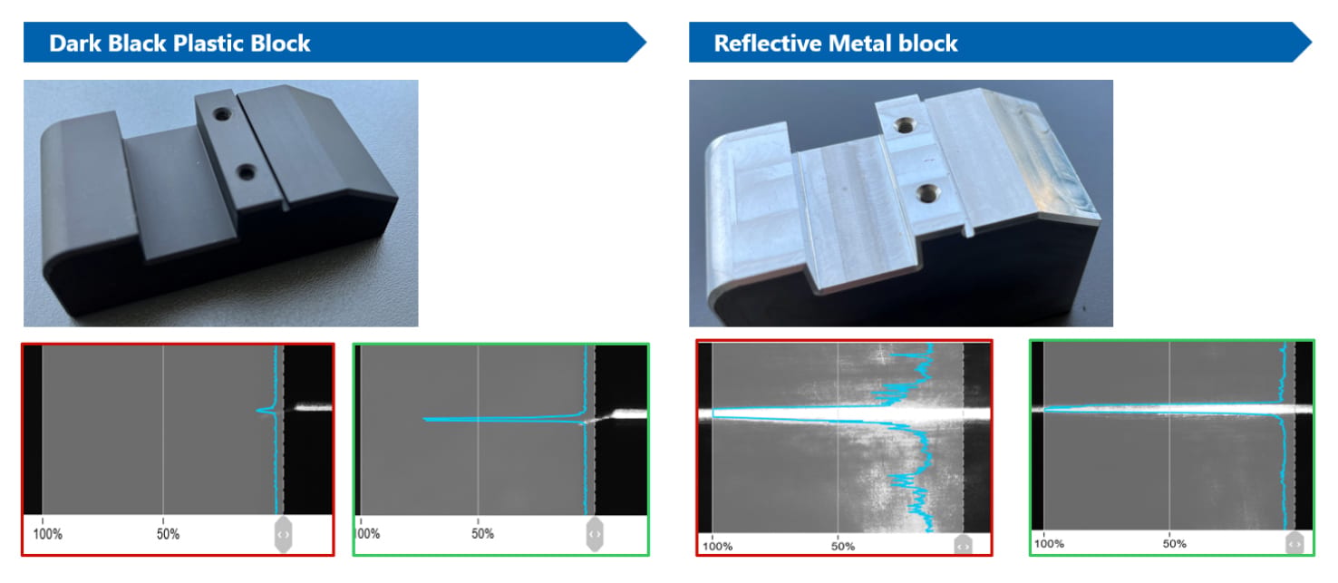

The reliability of any optical inspection system is determined by how light interacts with the material being measured, with measurement accuracy driven by a combination of absorption, reflection, and scattering. Surface characteristics such as color, finish, and microstructure all influence these interactions. Dark materials like black plastics or rubber absorb a large portion of incident light, reducing signal strength and increasing measurement noise, particularly at longer distances or higher speeds. Polished or glossy surfaces, including machined aluminum or stainless steel, tend to reflect light, acting like mirrors and potentially directing the beam away from the sensor if the angle of incidence is not carefully controlled, which can result in signal dropouts or saturation. In contrast, matte surfaces scatter light more diffusely, generally making them easier for triangulation-based systems to measure reliably, although surface microstructures can still introduce unpredictable scattering effects. Transparent and translucent materials present an additional challenge, as light can penetrate below the surface and reflect from subsurface layers, sometimes causing the sensor to detect an incorrect surface height and leading to inaccurate measurements.

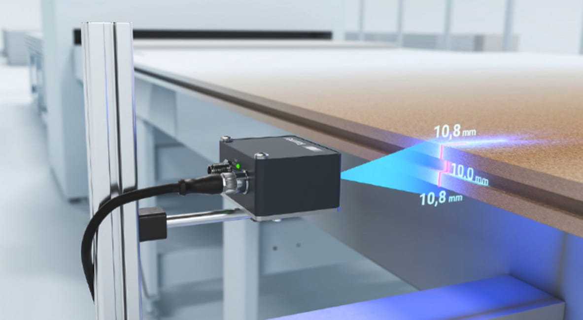

Laser sensor measures the thickness of a material panel, displaying "10.0 mm" and "10.8 mm" values.

Wavelength selection is a key factor in addressing these challenges. Most industrial laser sensors historically use red diodes, around 650 nanometers, due to their cost efficiency and visibility during installation. However, red light interacts differently with materials than shorter wavelengths. Blue lasers, in the range of 405 to 450 nanometers, have become increasingly common in precision inspection because they reduce some of the measurement problems caused by surface absorption, reflectivity, and scattering.
Blue light has a shorter wavelength, which reduces its penetration into transparent and semi-transparent materials. Red light tends to travel deeper into plastics or films, which can result in returns from subsurface layers and cause unstable readings. By using blue light, most of the reflection occurs at the surface, improving edge definition and providing a more stable height measurement. For shiny metals, blue lasers also reduce speckle effects and produce a more consistent return signal. This is particularly important for applications that require precise edge profiling, such as accurate measurements of machined components. The smaller diffraction-limited spot size of blue light can also contribute to finer measurement resolution, although system optics and sensor design ultimately determine the achievable precision.

Comparison of depth measurements for dark plastic and reflective metal blocks with corresponding graphs.

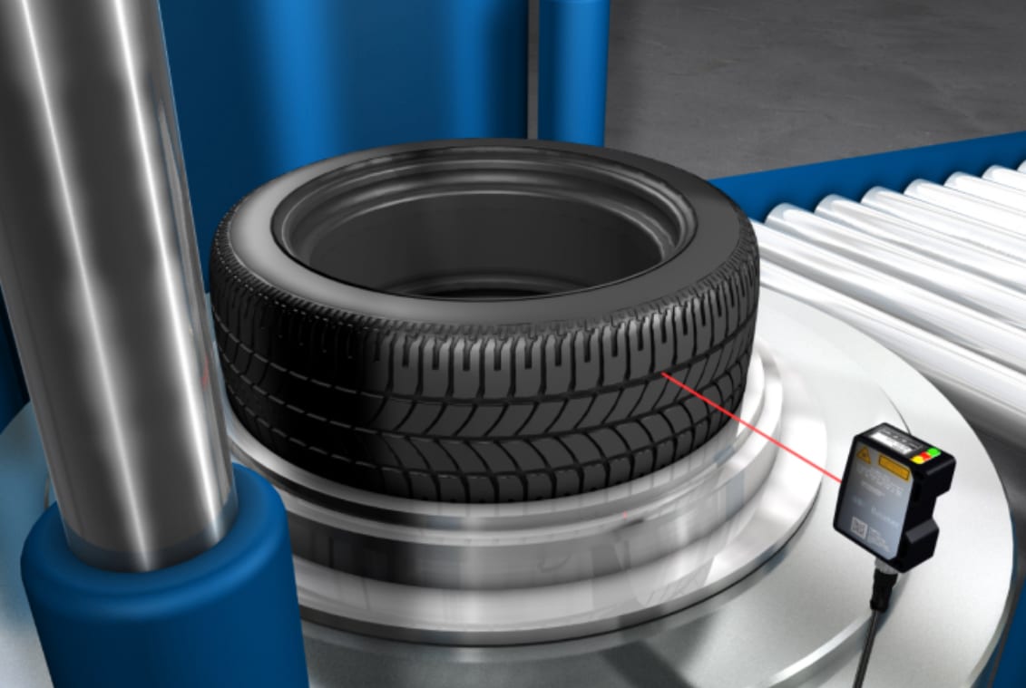

Different surfaces present specific challenges that require tailored approaches. Polished metals, for example, can produce specular reflections or signal saturation. These challenges can often be mitigated by adjusting the triangulation angle, using optical filters, or selecting shorter wavelengths. Mounting stability is also critical; vibrations or misalignment can translate directly into measurement noise. Black rubber and dark plastics, which absorb more light, benefit from sensors with high dynamic range and careful selection of standoff distance, along with wavelength optimization to ensure sufficient signal return. Transparent or translucent materials require attention to penetration depth and reflection from subsurface layers. Shorter wavelengths can improve surface measurement accuracy, and optical filtering or angle adjustments can further reduce unwanted reflections. Hot materials, such as steel in processing lines, add another layer of complexity, as thermal radiation can interfere with optical measurements. Narrow-band optical filters and careful sensor placement can help minimize these effects.

An industrial laser sensor inspecting the tread of a tire on an automated production line.

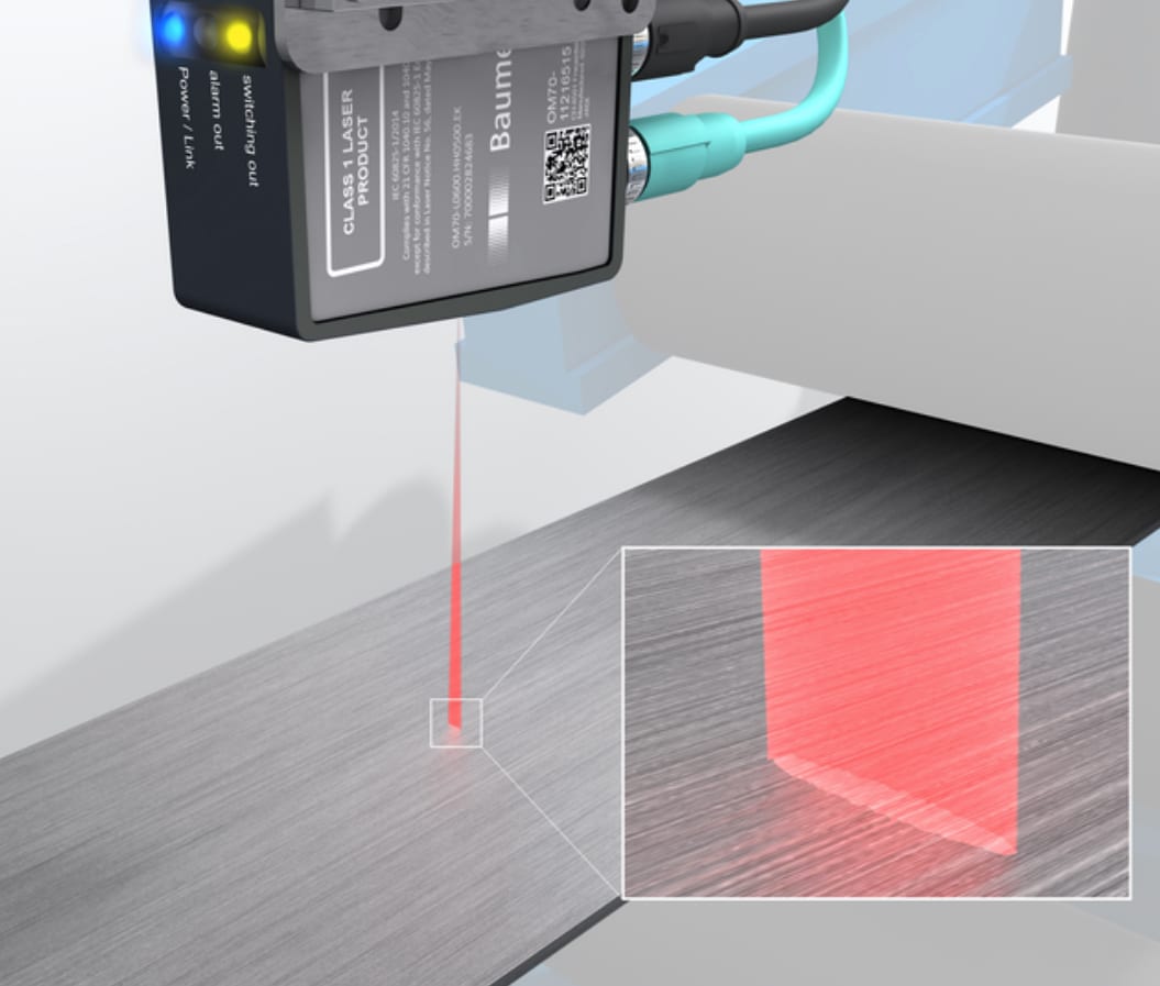

Mechanical and environmental factors are just as important as optical considerations. Triangulation sensors, for instance, convert positional changes in reflected light into distance measurements, so any vibration at the sensor mount can directly affect measurement stability. Robust mechanical design, damping, and careful mounting are essential, particularly in stamping, machining, or roll-forming environments. The angle of incidence must be considered carefully for specular surfaces, as small angular misalignments can lead to large measurement errors. Even ambient lighting can influence smart cameras and certain optical sensors. Using narrow-band optical filters matched to the laser wavelength can dramatically reduce interference and improve consistency in challenging factory environments.
A laser sensor emitting a red beam onto a gray textured surface, with a magnified inset showing the laser's impact.
