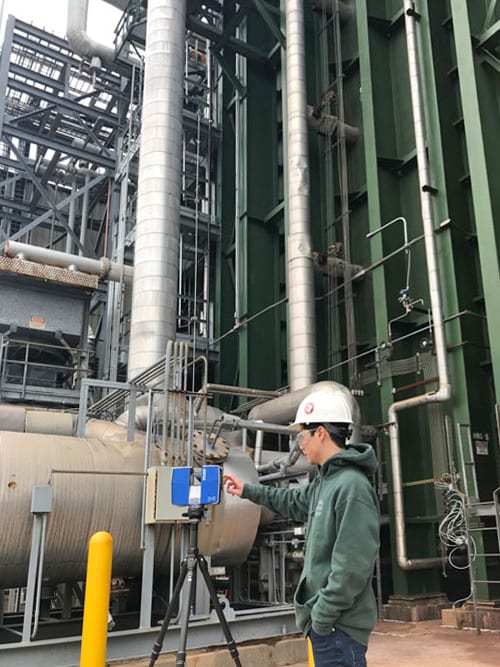

Man pointing at a 3D scanner in an industrial plant.
Long-range scanning system capturing dimensional data from large industrial equipment in a production facility.
Laser Trackers
As manufactured components and assemblies continue to grow in scale, the limitations of stationary metrology systems become increasingly apparent. Traditional coordinate measuring machines (CMMs) are typically confined to laboratory environments and limited measurement volumes. When dealing with large structures or assemblies that span several meters, or even tens of meters, portable metrology solutions become essential.
Laser trackers address this need by providing highly accurate, portable coordinate measurement capability for large-scale measurement and alignment applications. These instruments are designed to measure the three-dimensional position of targets across large volumes, often covering measurement ranges of 30 meters or more from a single setup. Their portability allows measurements to be performed directly on the shop floor, in assembly bays, or in field environments where large components cannot easily be moved.
Rather than contacting the part directly with a probe, a laser tracker measures the position of a reflective target known as a spherically mounted retroreflector (SMR). The SMR contains precision optics that return the incoming laser beam directly back to the tracker regardless of its orientation, allowing the system to determine the exact spatial location of the target.

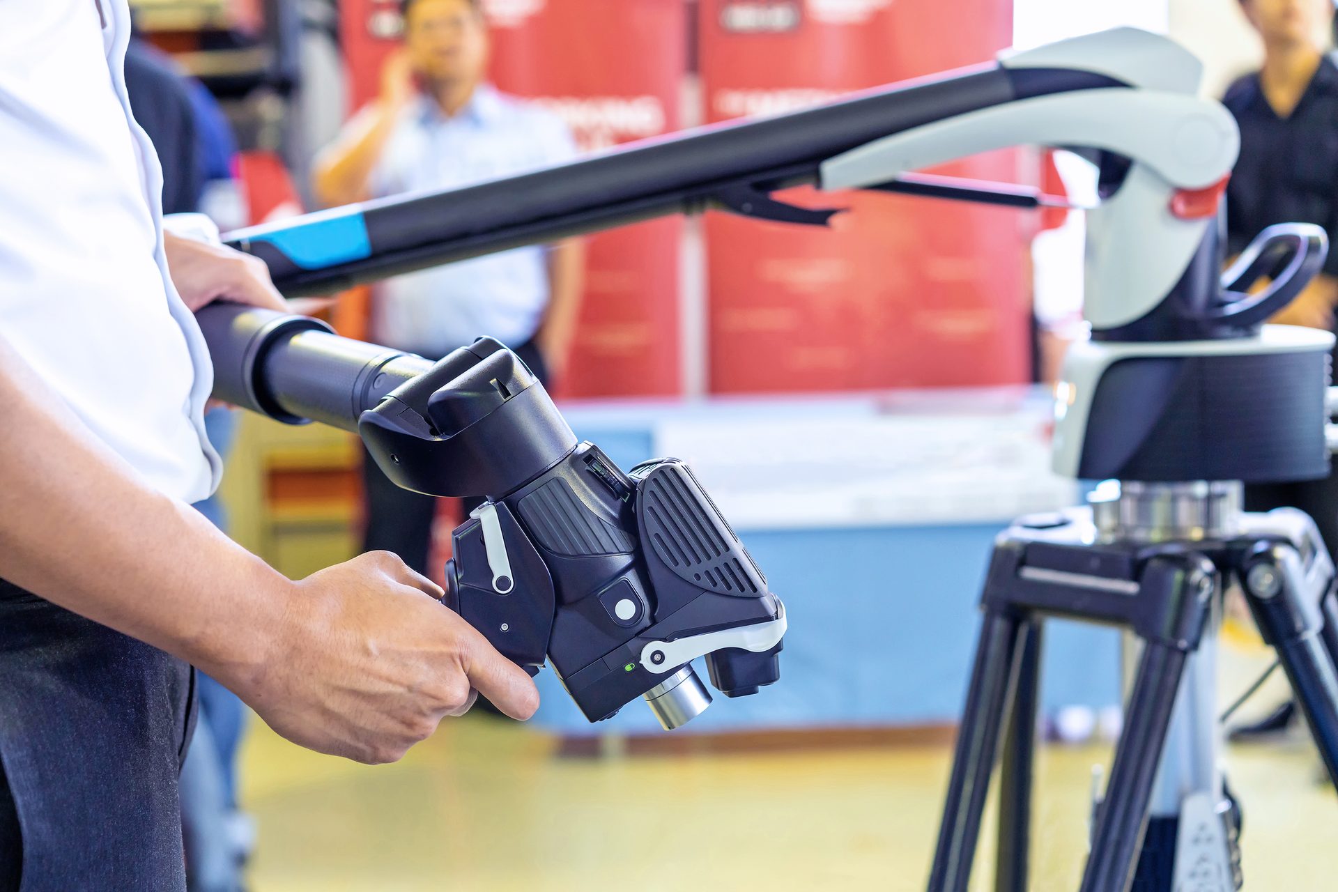

Person operating a portable 3D scanner or CMM arm, with the device's base on a tripod.
Portable articulated measuring arm performing dimensional inspection directly on the manufacturing floor.
Portable Measuring Arms
Portable measuring arms, often referred to as articulated arms or portable coordinate measuring machines (PCMMs), also provide a flexible alternative to traditional stationary metrology systems. These devices combine the coordinate measurement capability of a CMM with the mobility required for shop floor environments, making them particularly useful for inspecting parts that are difficult to bring into a dedicated metrology lab.
A portable arm consists of multiple articulated joints connected by rigid arm segments. Each joint contains high-resolution rotary encoders that continuously track the angular position of the arm. As the operator moves the arm through space, the system calculates the exact position of the probe tip relative to the arm base.
When the probe touches the surface of a part, the software uses the encoder data to determine the precise three-dimensional coordinates of the measurement point. By collecting a series of points across a component, the system can evaluate geometric features such as holes, slots, edges, planes, and complex contours.

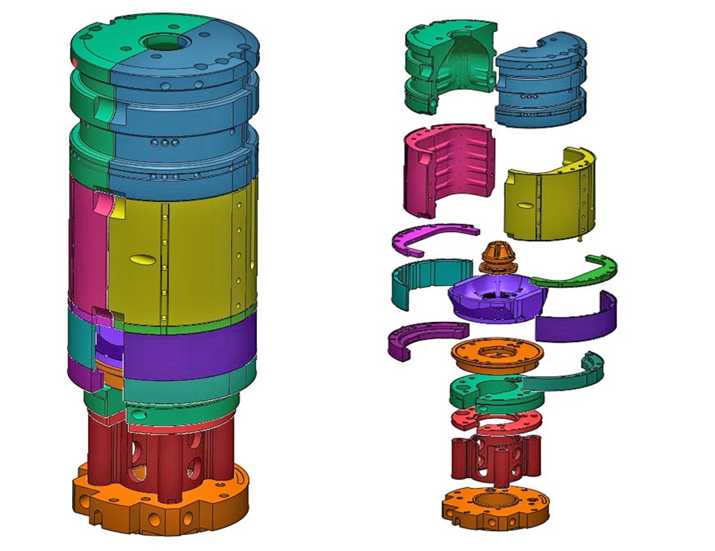

A 3D CAD model showing a multi-colored cylindrical assembly in assembled and exploded views.
Reverse engineered CAD model of a mechanical assembly.
