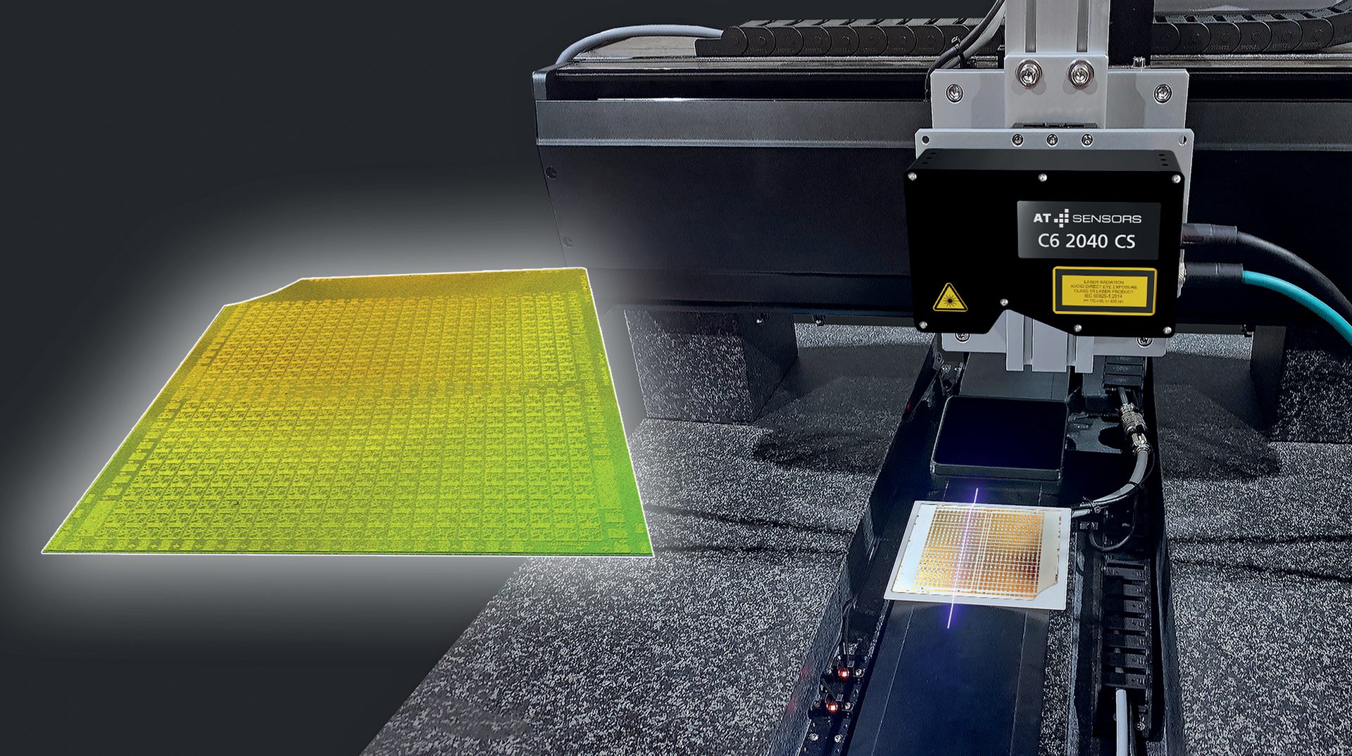

An AT Sensors C6 2040 CS device scans a semiconductor wafer with a laser, next to a large glowing chip array.
Semiconductor device inline planarity check with AT-Sensors 3D laser profilers
