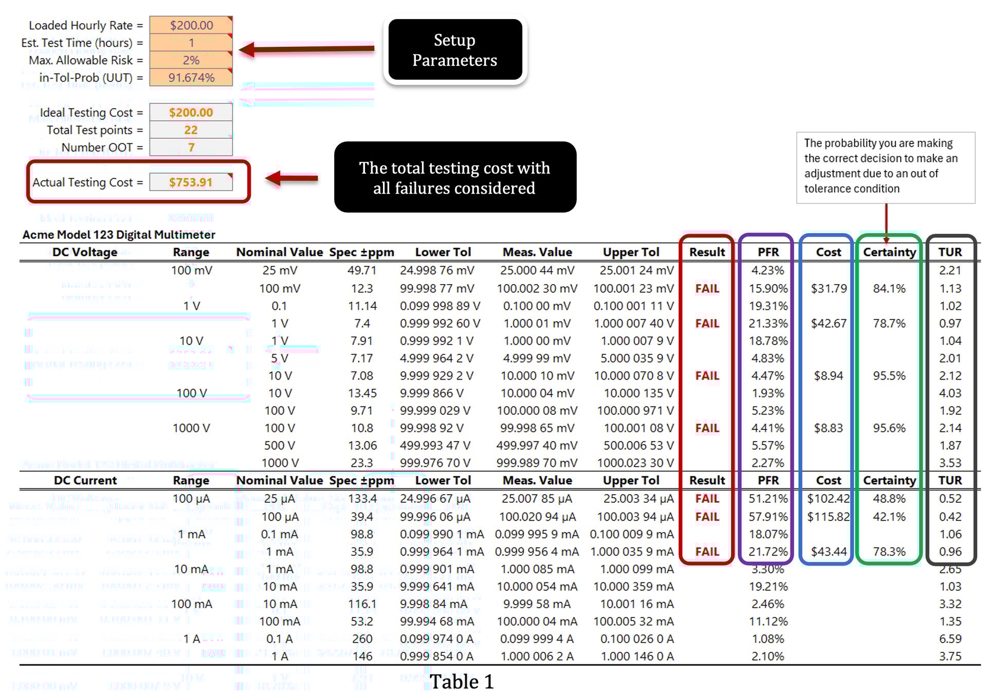

In this example, we analyze a recalibration test of an “Acme” model 123 Digital Multimeter (DMM) using an “Acme” Multifunction Meter Calibrator (MMC) as the reference standard. The test includes 22 Test Points (TP) with a maximum Probability of False Accept (PFA) of 2%. It takes one hour, costing $200 (including salary and benefits). We focus on the Probability of False Reject (PFR) risk, as the lab cannot quantify the cost of falsely accepting an item, but PFR can be measured and tracked for a more accurate understanding of recalibration costs.

The downloadable Excel workbook contains all setup formulas and a random function, NORM.INV(RAND(), Nominal Value, Expanded Measurement Uncertainty), to simulate UUT failures. Only results and costs are shown here. Press “F9” to update OOT values.
The results for our test data are shown below in Table 1
Table 1
Source: Greg Cenker
Table 1 Explanation:
  • Result Column: 'FAIL' indicates the test point (TP) is out of tolerance.
  • PFR Column: Shows the Probability of False Reject (PFR) for each TP, indicating risk level.
  • Cost Column: Calculates cost for each failed TP as $200 × PFR.
  • Certainty Column: Reflects confidence in correctly identifying an out-of-tolerance (OOT) condition and deciding to adjust (e.g., 48.8% for 25µA and 42.1% for 100µA on the 100µA range).

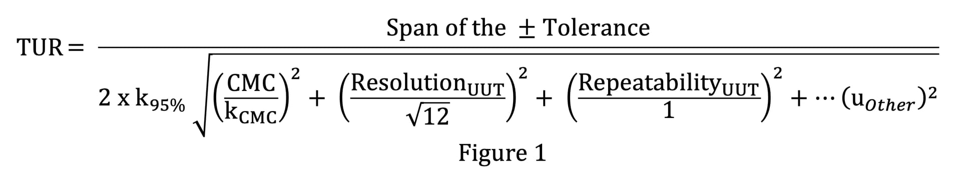

  • TUR Column: Test Uncertainty Ratio (TUR) = (UUT tolerance span) / (2 × expanded uncertainty), as shown in Figure 1.

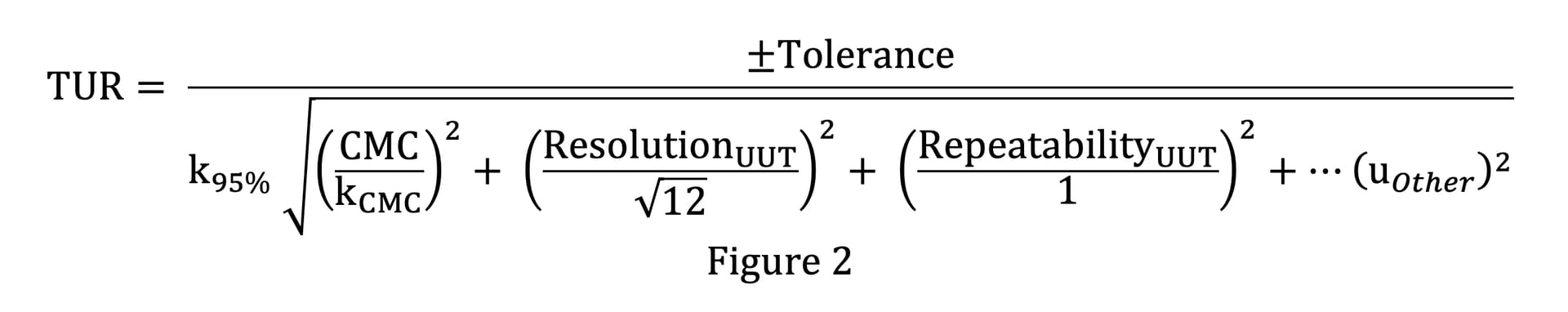

The divisor consists of all the applicable uncertainty contributors. For symmetrical specifications, it can be expressed as shown in figure 2 and provides the same result (the span being replaced by a single ± tolerance and divided by the expanded uncertainty).

Ideally, the TUR should be held at a value of 4.0 or greater as this provides the highest confidence if any TP is OOT. This higher value provides ~98% certainty the OOT condition is truly OOT and likely requires adjustment.
The Actual Testing Cost (top left area) consists of the initial calibration cost + sum of costs due to failed TPs (calibration cost x PFR) + As-Left verification. The ideal calibration cost went from $200 to an actual $753.91.
Should any out-of-tolerance (OOT) conditions arise, the recalibration cost will double to $400; however, the primary focus remains on failed test points (TPs) with low confidence in identifying OOT status and determining necessary adjustments. These failed TPs represent a hidden cost that many lab managers and sales representatives often overlook when providing recalibration service quotes.
