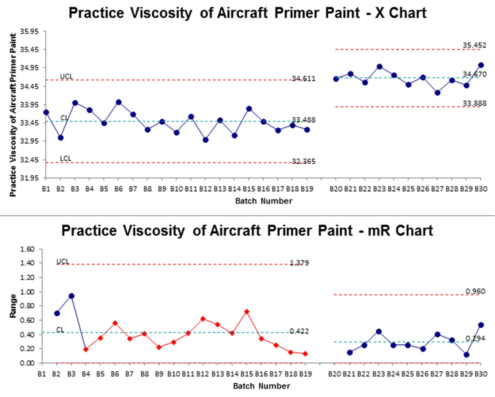

In control charts, you can show process changes so that you can see what it was like before and what it was like after the improvement. If the limits don’t move, you didn’t make an improvement. To show process changes, it’s really by adjusting the values in the center line (average, median, etc.) that changes the limits.
Figure 1 shows an example of a control chart with before and after improvement. Either a run (eight points in a row above or below the center line) or a trend (six points in a row ascending or descending) signal a process shift. With software, you can separate the data by spaces or you can just create the chart and then use the Process Change Wizard to automatically identify trends or runs—the shifts in the process. Great thing about this is people can clearly see yes, it was low before and afterwards it improved.

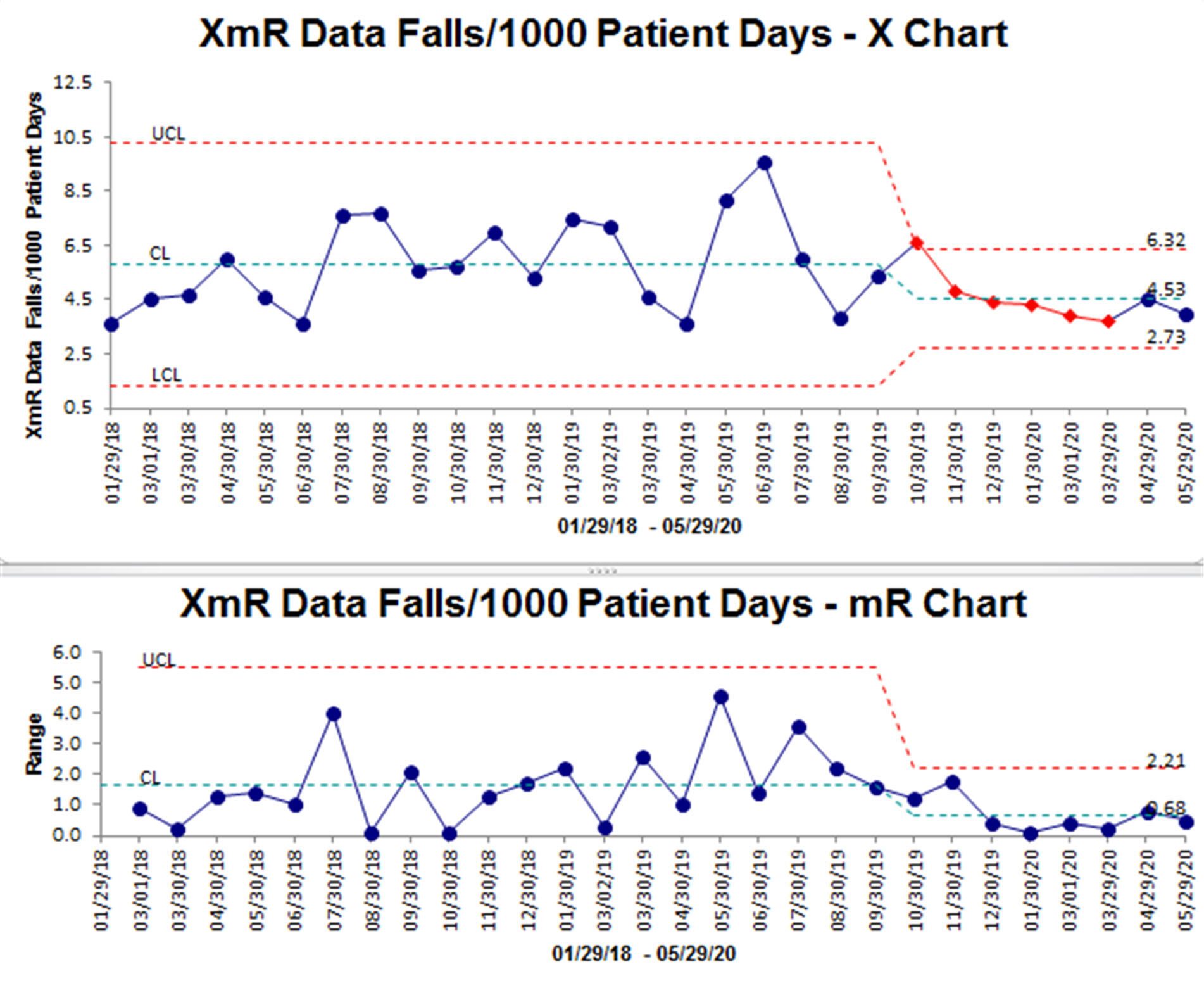

Healthcare and other service industries can use control charts with process changes. Figure 2 shows a process shift in patient falls after an improvement project.
Figure 2 control chart

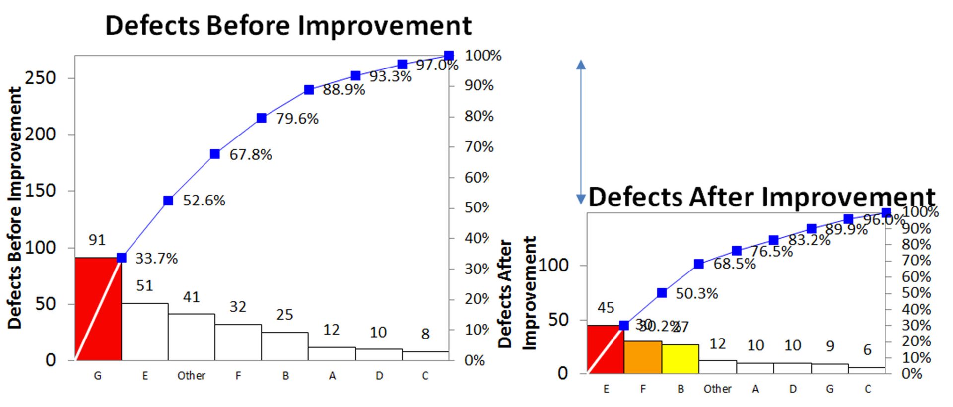

You can also do the same with Pareto charts Figure 3. You can measure all of the contributors the problem beforehand, and then we can measure all the contributors after. Then you can draw Pareto chart of each one and show them side by side. Then you can collapse the Y axis of the after chart to show how much it reduced the problem. In this example, the big bar, “G” reduced from 91 to 9, a significant improvement.

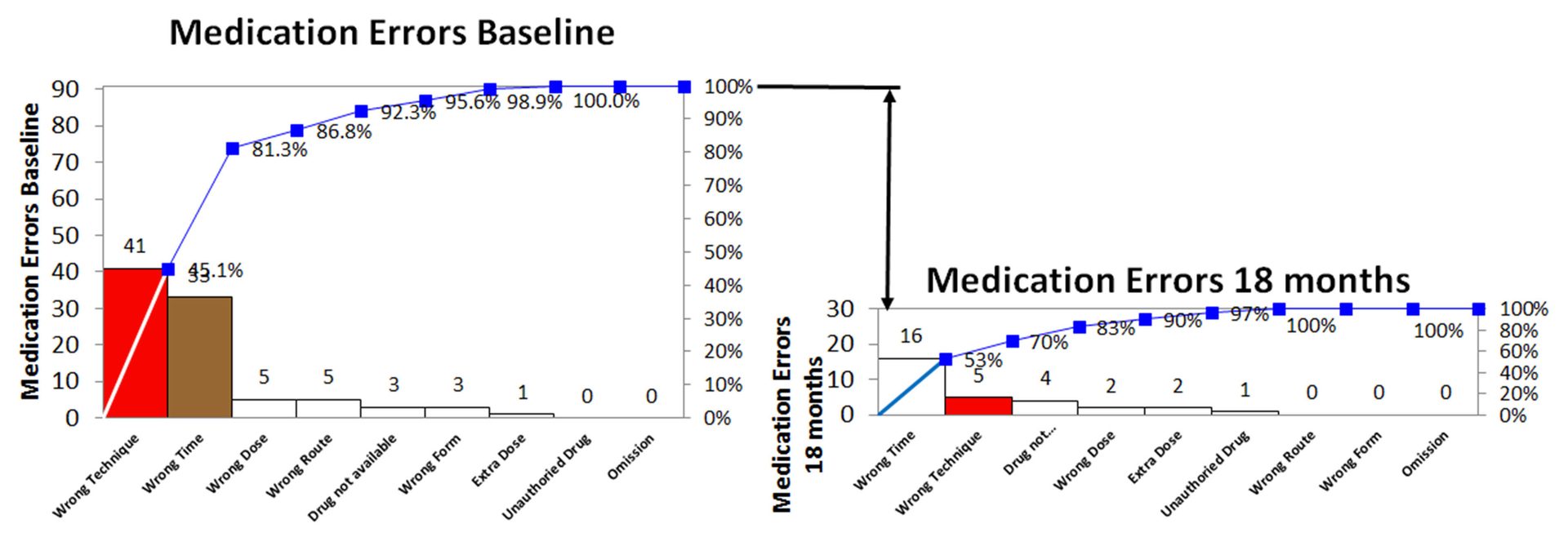

This can also be done with healthcare data about common problems such as medication errors before and after improvement (Figure 4). In this case, wrong technique fell into second place. Next the team can work on reducing “wrong time” problems.

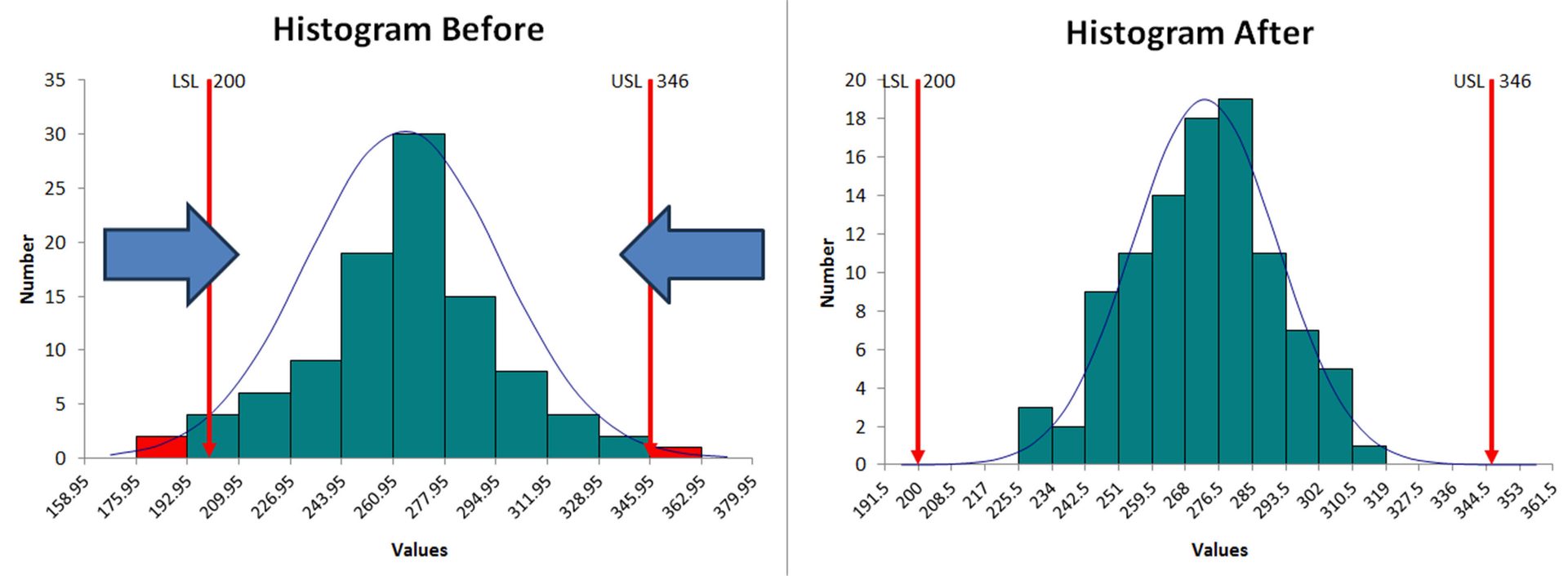

You can also do this with histogram. You can draw histogram before improvement, where things were out spec, beyond the upper or lower specification limit. And then you can change the process and show it again afterwards showing that all the data is now inside of the spec limit. And you can stand these side-by-side and show how it’s actually been improved Figure 5.

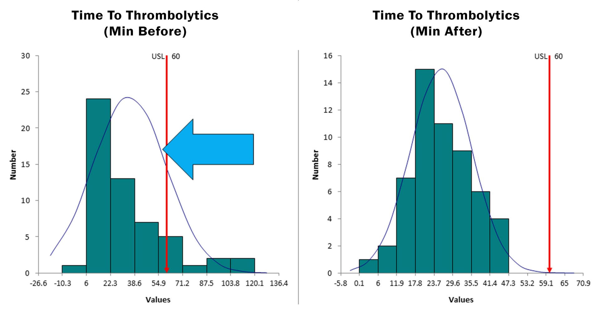

Similarly, this can be done with one-sided specification limits such as time to thrombolytics (a clot busting drug) used in healthcare (Figure 6).
