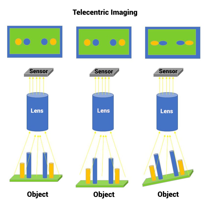

Telecentric imaging: Ensuring precision
Telecentric lenses are designed so that light rays are parallel to the optical axis, eliminating perspective distortion. This design ensures consistent image scaling along the axial direction (Z-axis), which means that measurements remain accurate even if the distance of the object from the camera varies slightly. For example, the distance between two holes is consistently measured regardless of small positional shifts. However, these lenses can be bulky and expensive, especially for larger fields of view. Their size and weight can be a challenge in dynamic applications such as robotic systems.
Telecentric Imaging
Telecentric Imaging

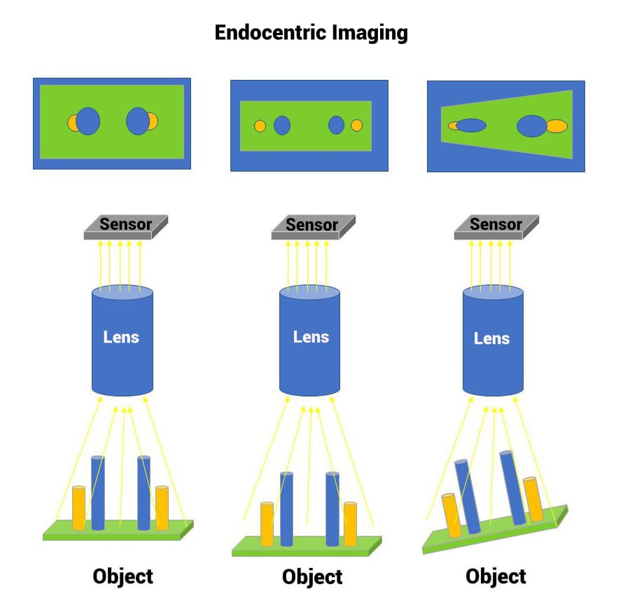

Endocentric imaging: A cost-effective alternative
Endocentric or conventional lenses present a perspective-based image where object size varies with distance from the camera. While this presents measurement challenges due to perspective distortion, endocentric lenses are more compact and affordable. With proper calibration and software correction, they can provide satisfactory measurement accuracy, especially in applications where small variations are acceptable.

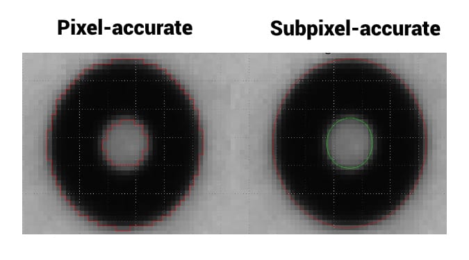

When measuring objects optically, the accuracy of edge detection is one of the biggest challenges. Unlike human vision, which can intuitively recognize edges even in complex environments, cameras rely on sensors with a finite number of pixels.
The accuracy of the measurement is therefore limited by:
  • Pixel resolution: The ability of the sensor to distinguish small details depends on the size and number of pixels.
  • Edge detection algorithms: Software must compensate for limitations in contrast, noise, and blur to correctly define object boundaries.
  • Optical distortions: The choice of lens can introduce perspective errors or magnification inconsistencies that affect measurement accuracy.
Choosing the right optical setup is critical to minimizing errors and ensuring that dimensional measurements are repeatable and reliable.
Pixel exact vs. subpixel exact
Telecentric imaging: High-precision measurement
Telecentric lenses are a special type of optical system designed so that light rays entering the lens travel parallel to the optical axis. This unique property eliminates perspective distortion, making telecentric optics ideal for precise dimensional measurement.
Advantages of telecentric imaging
  • Elimination of perspective errors: Unlike standard lenses, telecentric lenses ensure that objects appear the same size regardless of their distance from the camera. This is critical when measuring dimensions such as hole distances, widths, and diameters.
  • Consistent measurement scaling: Since magnification does not change with depth, measurements remain accurate even if the object is not perfectly aligned.
  • High edge definition: Because telecentric lenses reduce distortion, they provide sharper, more reliable edge detection, leading to improved accuracy in metrology applications.
  • Minimized parallax effect: Objects with depth, such as drilled holes, are imaged without the parallax error seen with standard lenses, ensuring accurate dimensional analysis.
Limitations of telecentric optics
  • Size and weight: Telecentric lenses are physically larger and heavier than standard lenses, making them unsuitable for space-constrained environments or mobile applications (e.g., robotic vision).
  • Higher cost: Due to their complex optical design, telecentric lenses are significantly more expensive than conventional endocentric lenses. This cost may not be justified for all applications.
  • Limited field of view: The field of view (FOV) of telecentric lenses is generally smaller than that of standard lenses, requiring careful selection to match the size of the object to be measured.
Best use cases for telecentric imaging
  • High-precision measurement of finished parts
  • Inline inspection systems where small deviations matter
  • Quality control applications requiring sub-pixel accuracy
  • Optical measurement of hole spacing, gears, or PCB components
Endocentric imaging: A flexible and cost-effective solution
Endocentric lenses, or standard camera lenses, function similarly to human vision—objects appear smaller as they move further from the camera. This introduces perspective distortion, where objects closer to the lens appear larger than those further away.
Advantages of endocentric imaging
  • Compact and lightweight: Standard lenses are smaller and easier to integrate into space-constrained environments, including robotic applications.
  • Lower cost: Compared to telecentric lenses, endocentric optics are significantly less expensive, making them an attractive option for cost-sensitive applications.
  • Larger field of view: Standard lenses allow for larger fields of view, making them ideal for capturing larger objects or scenes.
  • Flexible working distances: Unlike telecentric lenses, endocentric optics can adjust focus at different object distances, providing greater adaptability.
Limitations of endocentric optics
  • Perspective distortion: Objects appear different sizes depending on their distance from the camera, leading to potential measurement inaccuracies.
  • Magnification variability: Because magnification changes with object position, consistent measurements require precise calibration and software correction.
  • Edge ambiguity: Lack of telecentricity can lead to measurement errors, especially when dealing with parts that vary in depth.
Best use cases for endocentric imaging
  • General machine vision applications where slight measurement deviations are acceptable
  • Object classification and defect detection
  • Applications requiring working distance flexibility
  • Large area inspections with moderate measurement accuracy
