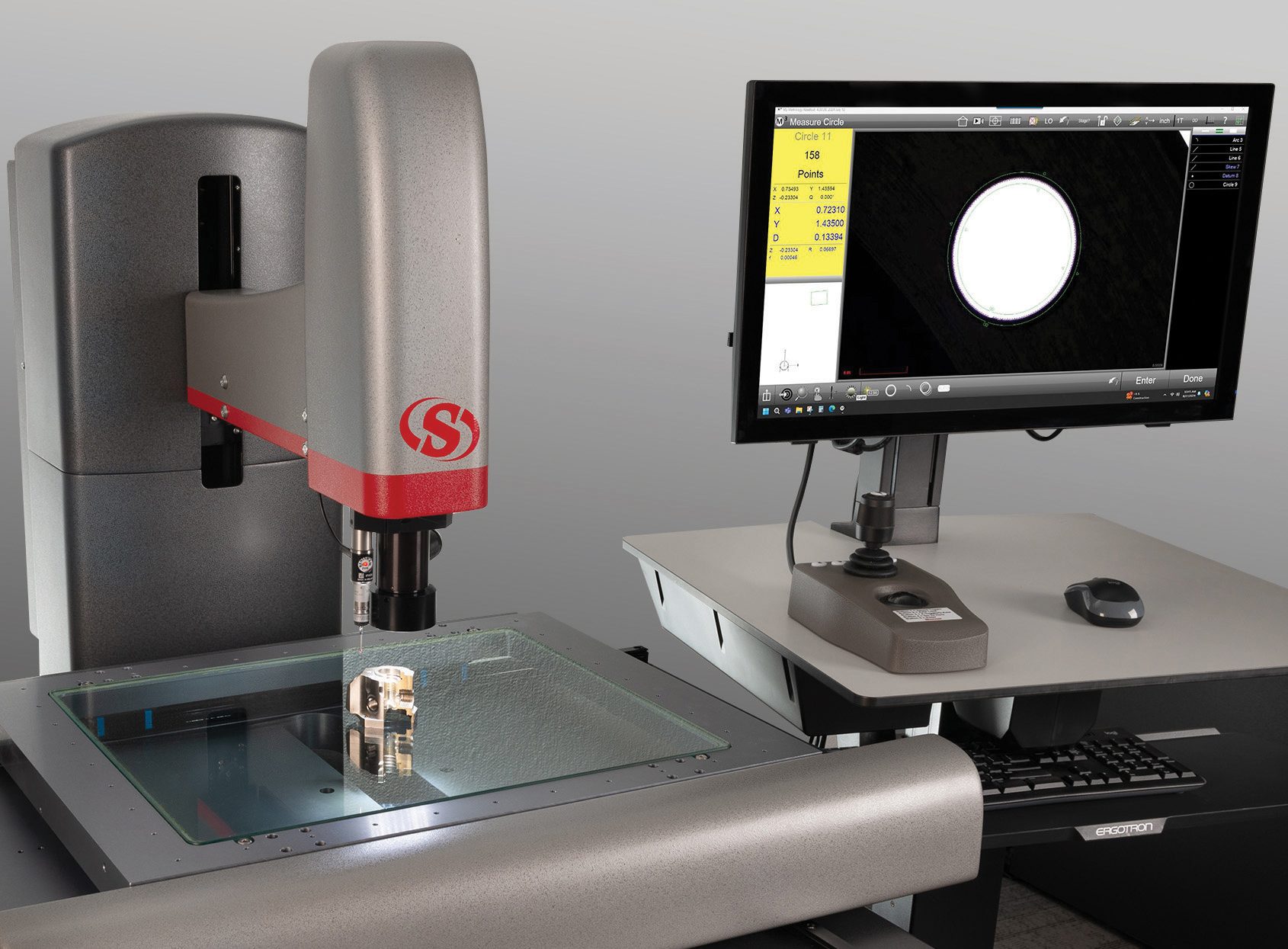

CNC Vision System equipped with powerful software for automatic part recognition
Multisensor systems should be equipped with user interfaces that make the system’s capabilities approachable and easy-to-use. One of the top benefits of modern metrology software programs is the speed of throughput due to features such as automatic part recognition. Users can create a part measurement program that comprises the desired features of a part for inspection, which can automatically be saved in the system or to a network.
Automatic pattern recognition can be extremely productive, especially for a high volume, low mix of parts. Pattern recognition is where inspection routines are created for workpieces based upon the master template, complete with tolerances. Precise stage motion and lighting control can be built-in as programmable steps to ensure maximum repeatability, regardless of operator skill. Once the program is created, an operator can place a sample on the stage and initiate the routine. When the routine is initiated, the system will automatically run the inspection, taking all relevant data points and providing accurate results in seconds.
Programmable light output options can also be built into the program as defined steps, including being called up as the part recognition program initiates. Once the program is created, placing that part within the camera’s field-of-view allows for the saved program to initiate and run the inspection. This enables fast, accurate and repeatable results.  Features such as a “Superimage” function allow a user to piece together multiple camera frames in order to view a large part in one single image. Optional touch probe capability is now better than ever, providing quick acquisition of discrete points along a part’s profile. Touch probe supporting 3-D geometry mapping has been improved and advanced as well.

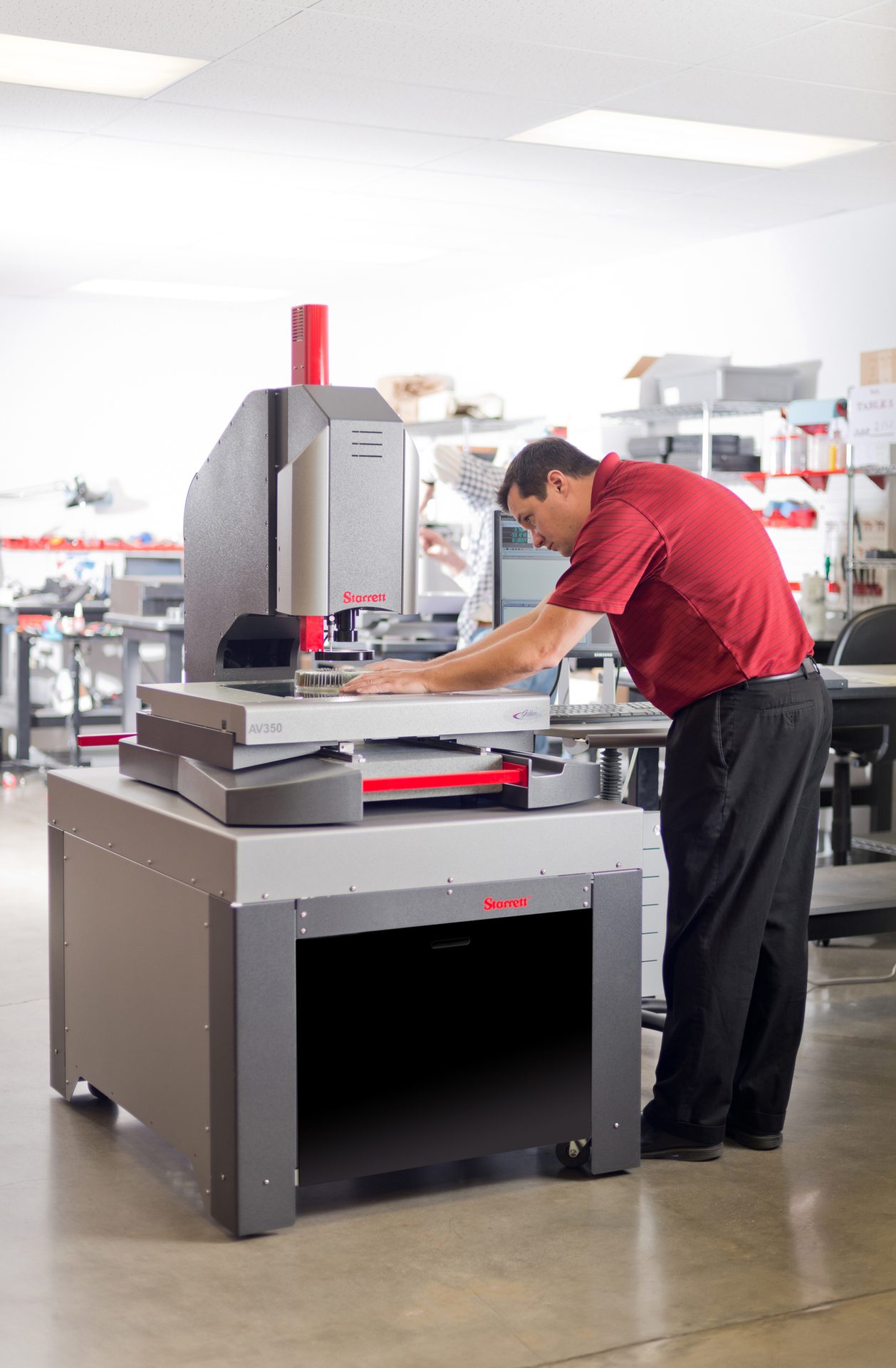

Walk-up metrology enables multiple operators, including those right on the shop floor, to utilize the same system for a variety of applications

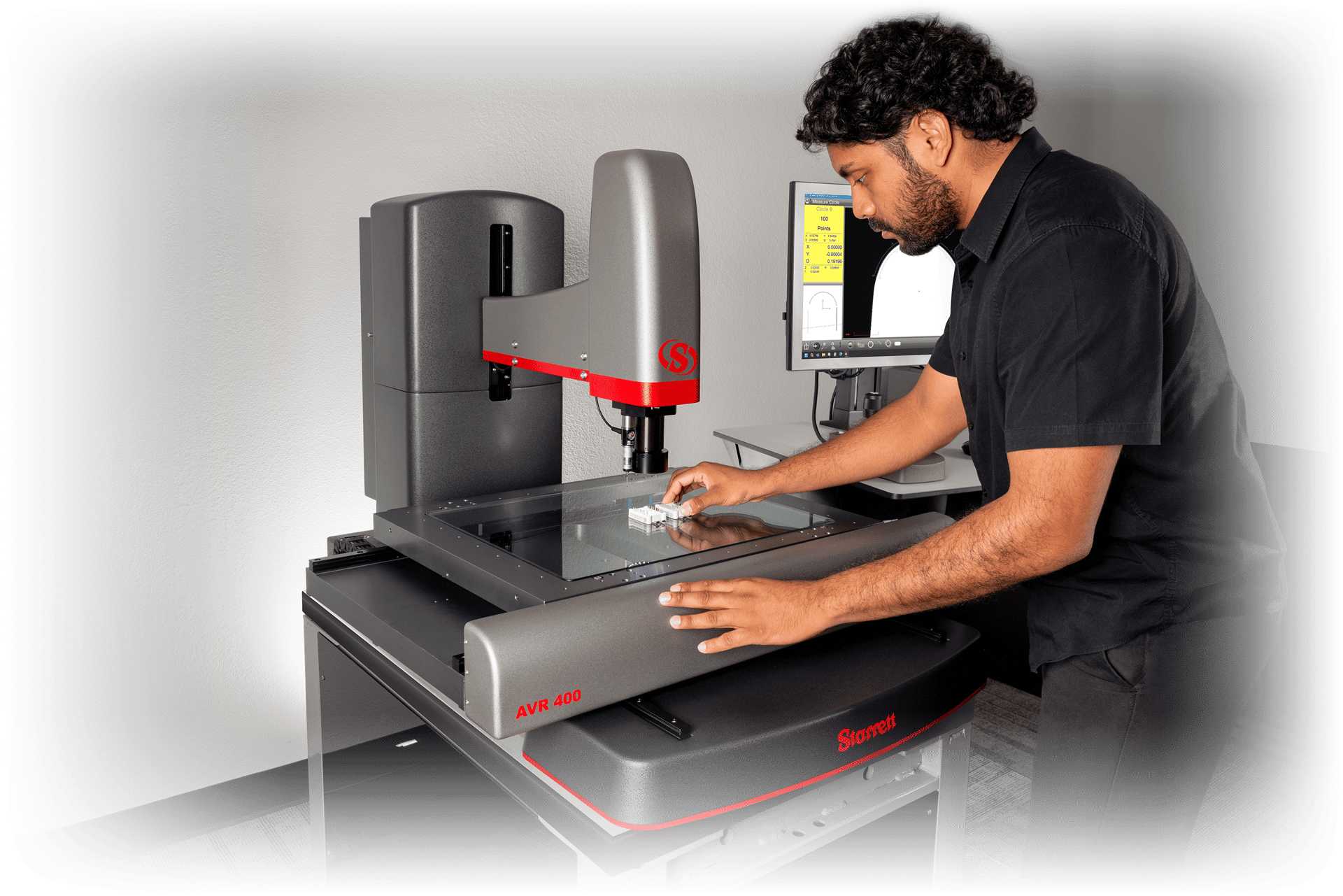

Opening Image: Starrett AVR400 Multisensor Vision System featuring a touch probe utilized for quick acquisition of discrete points along a part’s profile as well as Z-axis measurements.
