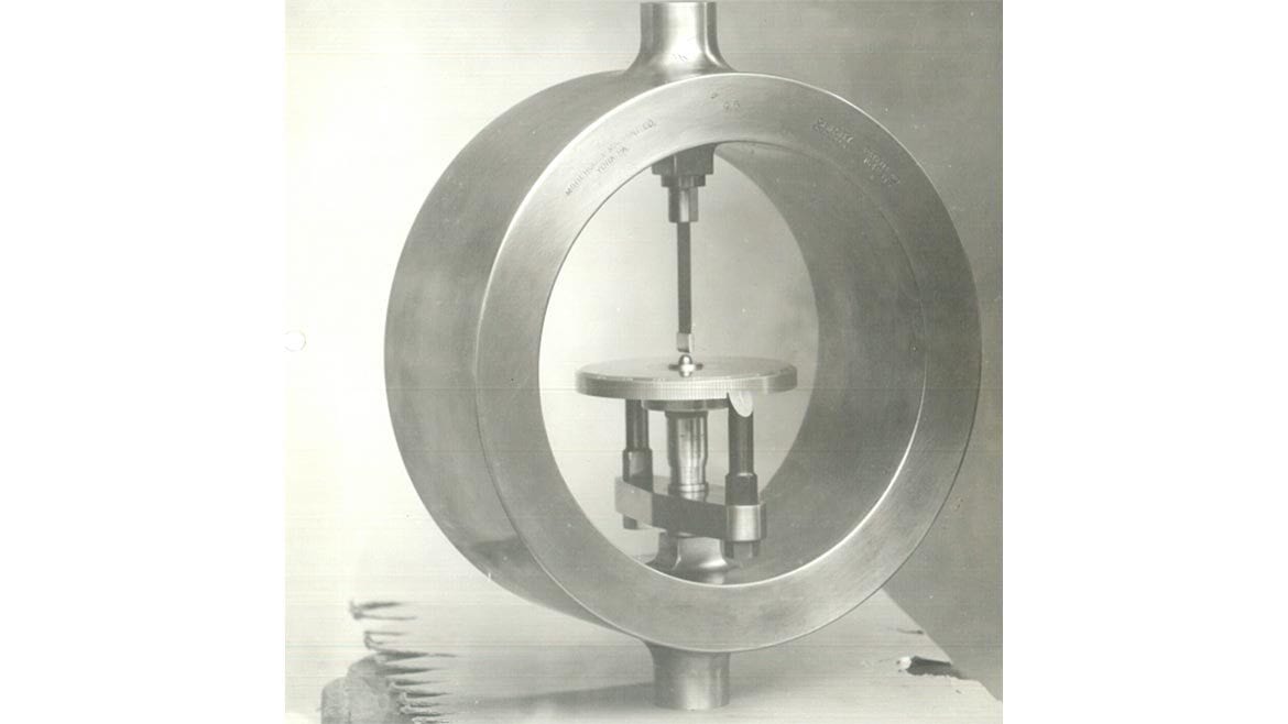

Building on this success, Petrenko developed an improved machine with cast iron weights and enhanced loading techniques. To address the challenge of transferring laboratory accuracy to field testing, Petrenko conceived the idea of a metal ring that could measure deflection under load. H.L. Whittemore, head of the Engineering Mechanics Section, suggested incorporating a vibrating reed and micrometer screw, giving birth to the Whittemore-Petrenko Proving Ring.
The NBS workshops produced the first Proving Ring devices in the early 1920s, and they were looking for a company to collaborate with them in manufacturing the Proving Ring.

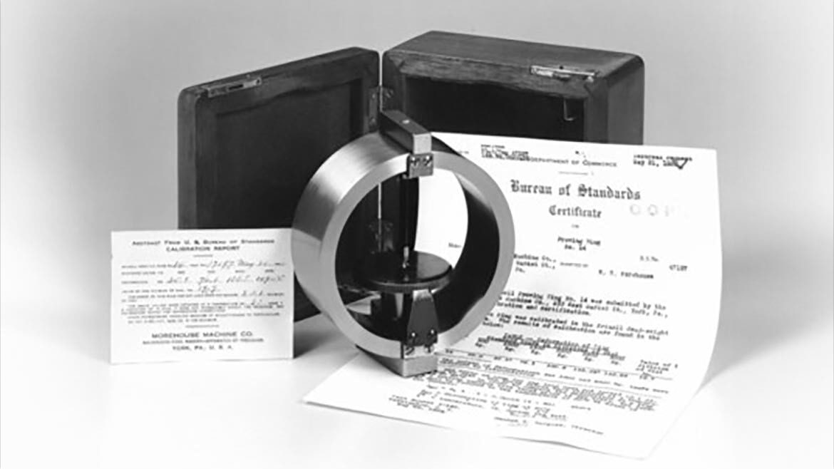

Figure 2 Morehouse Early Brinell Proving Ring S/N 14 Calibrated by U.S. Bureau of Standards test # 47197 May 24, 1926.

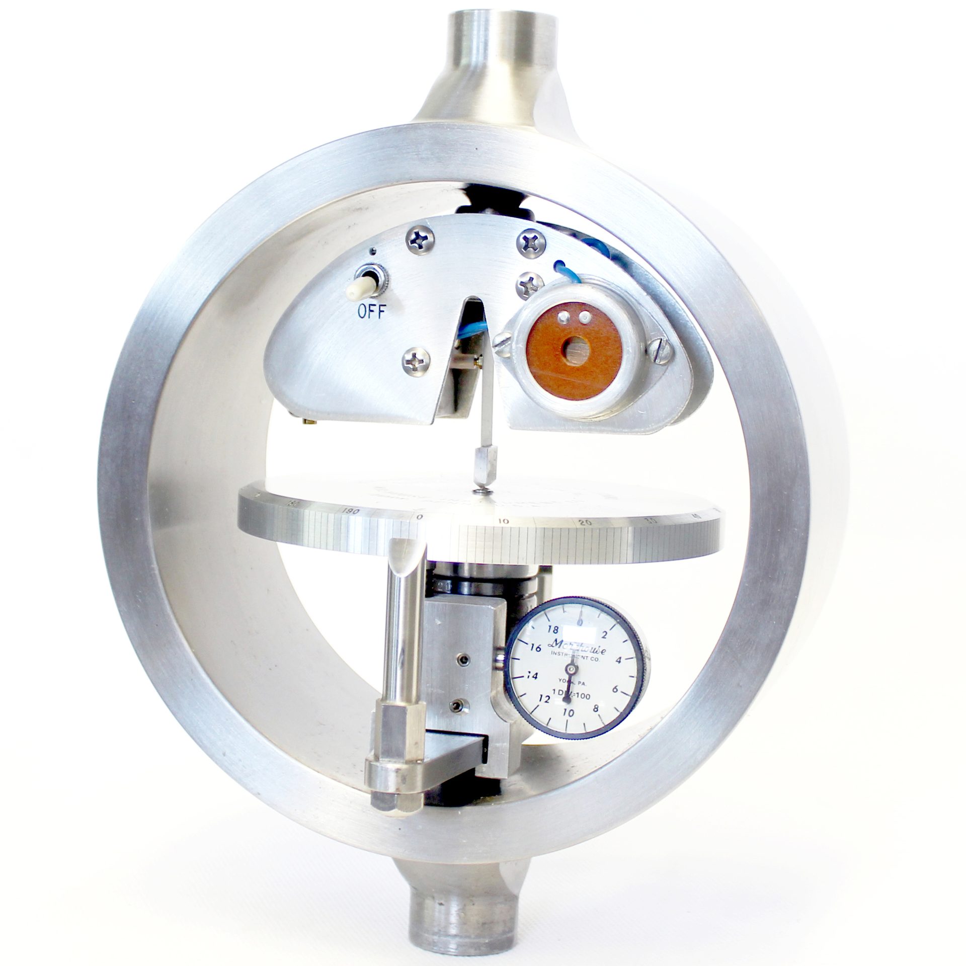

The Morehouse Proving Ring consists of a carefully machined ring of high-quality steel, a precision micrometer, a dial, and a vibrating reed. When a force is applied to the ring, the ring deformation is measured using a reed with a contact point against a button mounted to a screw with a dial that is used to know the number of divisions at each given force point.
The key to the Proving Ring’s accuracy lies in its design and construction:
Material Selection: The ring is made from specially selected steel with consistent and well-understood properties.
Precise Machining: The ring is machined so the bending moment does not vary significantly in the region of the horizontal diameter, which leads to a nearly uniform strain distribution.
The Micrometer and Dial: The process of machining and lapping a screw in which the entire mechanism can accurately turn to provide a consistent reading.
Calibration: Each ring is individually calibrated against known standards, often deadweight standards, to ensure consistent and repeatable readings.

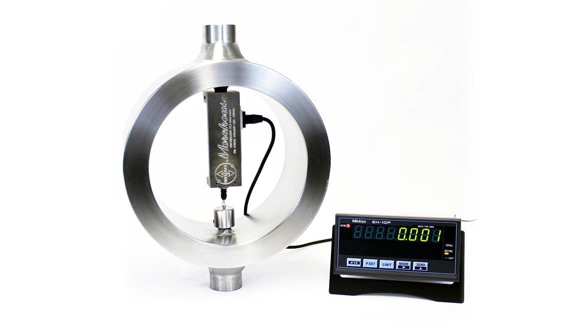

Over the past century, the basic principle of the Morehouse Proving Ring has remained largely unchanged, a testament to the soundness of its original design. However, advancements in materials science, electronics, and data processing have allowed for continual refinements and improvements. Modern Proving Rings often remove the screw and dial in favor of a linear gage and digital displays for easier and more precise readings.
The Morehouse Proving Ring is known for its stability, longevity, accuracy, and reliability. Proving rings, renowned for their exceptional stability and accuracy, have demonstrated remarkable longevity since their development in the 1920s, with some built in the 1930s still in active use today. This enduring reliability is attributed to their robust design and proper maintenance. These factors result in very little drift over extended periods, ensuring consistent and precise force measurements nearly a century after their initial fabrication. They often maintain uncertainties of 0.0125 - 0.025 % of full scale, making them incredibly precise instruments. Their reliability is so well-established that there’s even a Morehouse Proving Ring on the International Space Station.

Figure 7: Morehouse Digital Proving Ring
