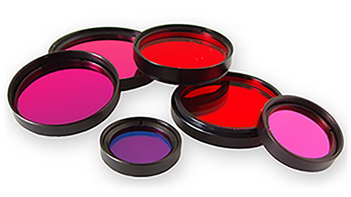

threaded band pass filter for red 660 nm light

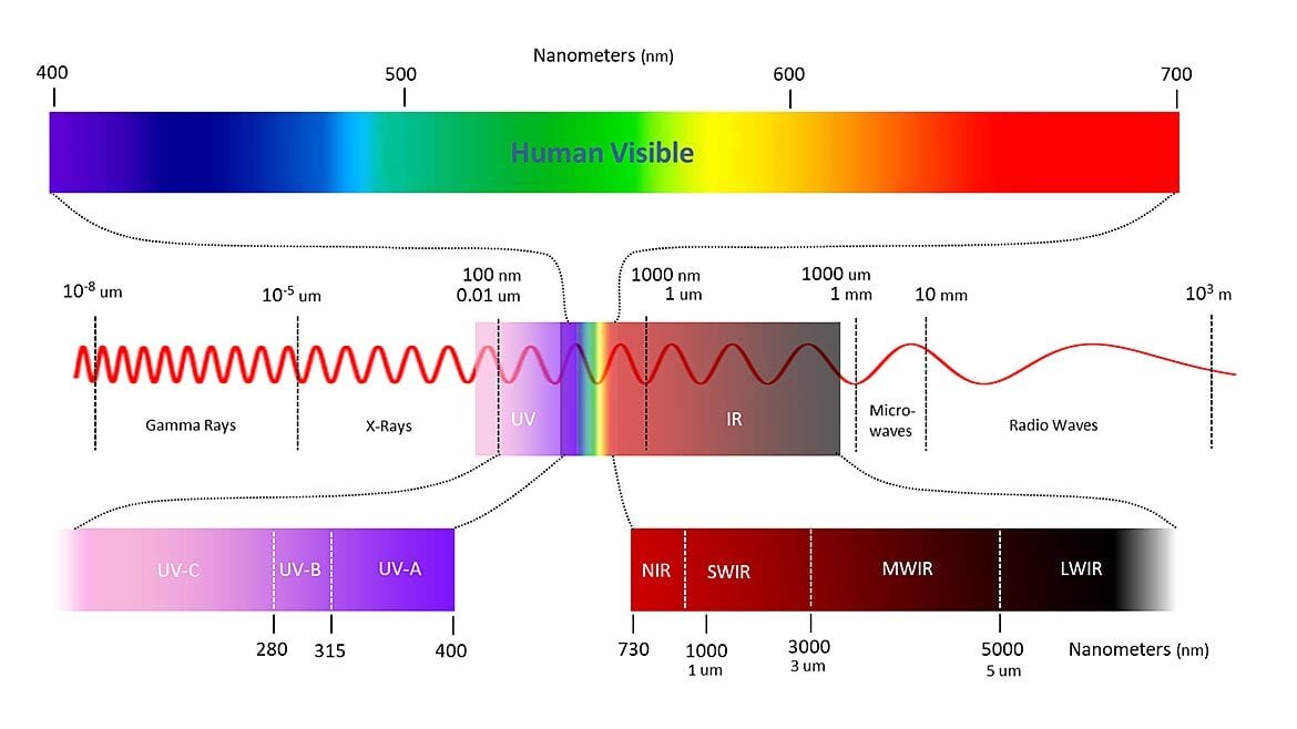

Multidisciplinary applications, such as machine vision, spectroscopy, and imaging, require a comprehensive understanding of how different materials interact with light at various wavelengths. A material’s chemical composition and structure determine the characteristics of interactions such as reflection, absorption, transmission, and fluorescence.
Figure 1: An illustration of the electromagnetic spectrum, highlighting wavelength boundaries and showing the UV, visible, and infrared portions.

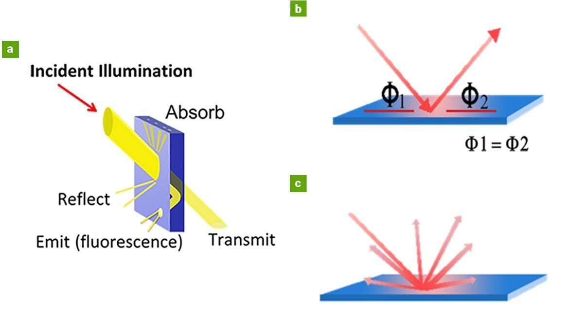

It is fundamental to machine vision lighting that materials reflect and absorb various wavelengths of light differently. This phenomenon occurs in both monochrome and color imaging. By using specific wavelengths of illumination, it is possible to enhance the contrast between a part or feature of interest and its background.
Figure 2: (a) Light interaction on surfaces. (b) Specular surfaces; angle of reflection equals angle of incidence (phi1 = phi2). (c) Non-specular (diffuse) surfaces.

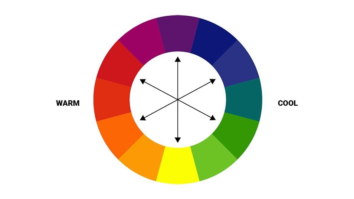

When dealing with colored objects or backgrounds, using colors opposite one another on the color wheel generates the greatest contrast. For example, green light suppresses red reflection more than blue or violet does. With a limited palette of known colors, the technique can even be used to differentiate colored parts using a monochrome camera.
Figure 3: With a limited palette of colors and a color wheel of warm versus cool colors, a monochrome camera can generate differential image contrast and even differentiate colors.

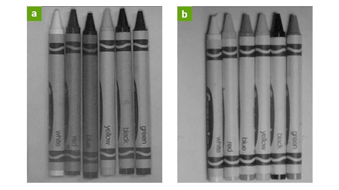

Near-infrared (NIR) illumination offers unique advantages in some applications. NIR reflectivity is more dependent on material texture and composition than pigmentation. So NIR light effectively neutralizes contrast differences based on visible color.
This property can be useful when less contrast is desired, such as when inspecting multicolored objects like crayons, where color reflectance from white light can make it difficult to read print due to contrast differences. NIR lighting can help even out these contrast differences and allow black text to be read consistently on variously colored backgrounds
Figure 4: The evening out of contrast differences among the color papers on crayons, under white light (a) and under NIR light (b), allows the blue crayon print to be more easily read and verified.

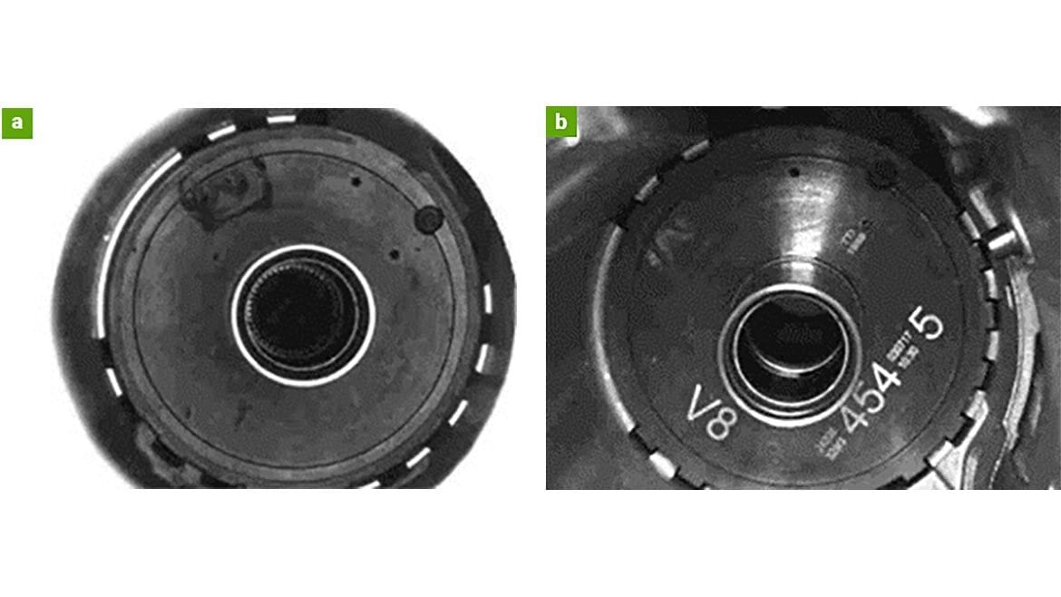

Conversely, shorter wavelengths such as ultraviolet (UV) and blue light interact with surfaces differently. For shorter wavelengths, surface scattering is proportional to the fourth power of the frequency. So blue light is more effective for imaging shallow surface features on materials such as black rubber or enhancing laser etching visibility.
Figure 5: Laser etch on gear face, limited to high angle of incidence. (a) No response to red light, 660 nm. (b) Significant scattering from blue light, 470 nm.

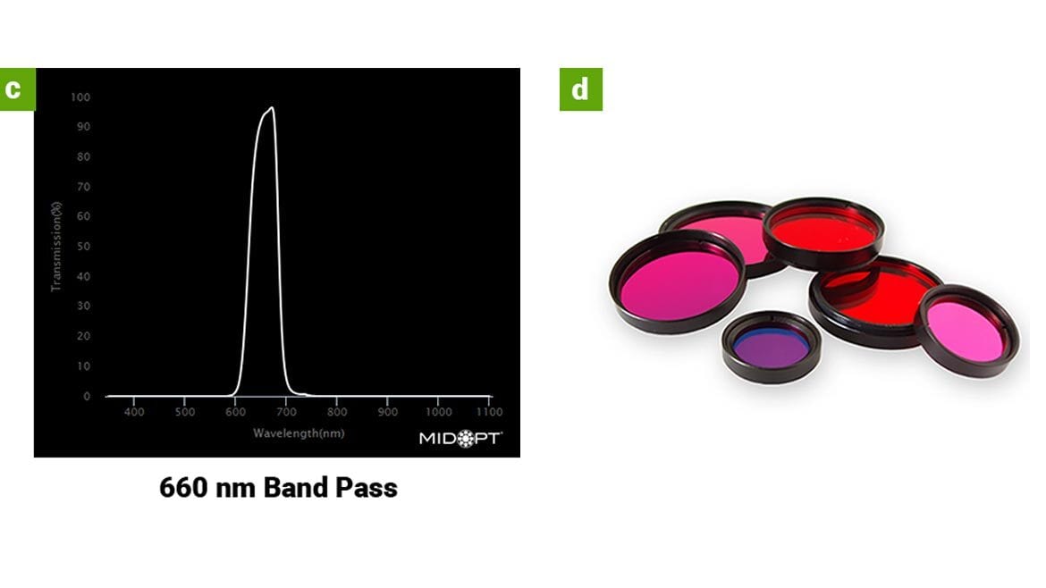

Because optical filters selectively transmit or block specific wavelengths of light, they are useful tools for mitigating the effects of ambient light. Filters can dramatically improve image contrast. When properly applied, filters also enable the use of specialized imaging techniques, such as fluorescence imaging. Common optical filters used in machine vision include:

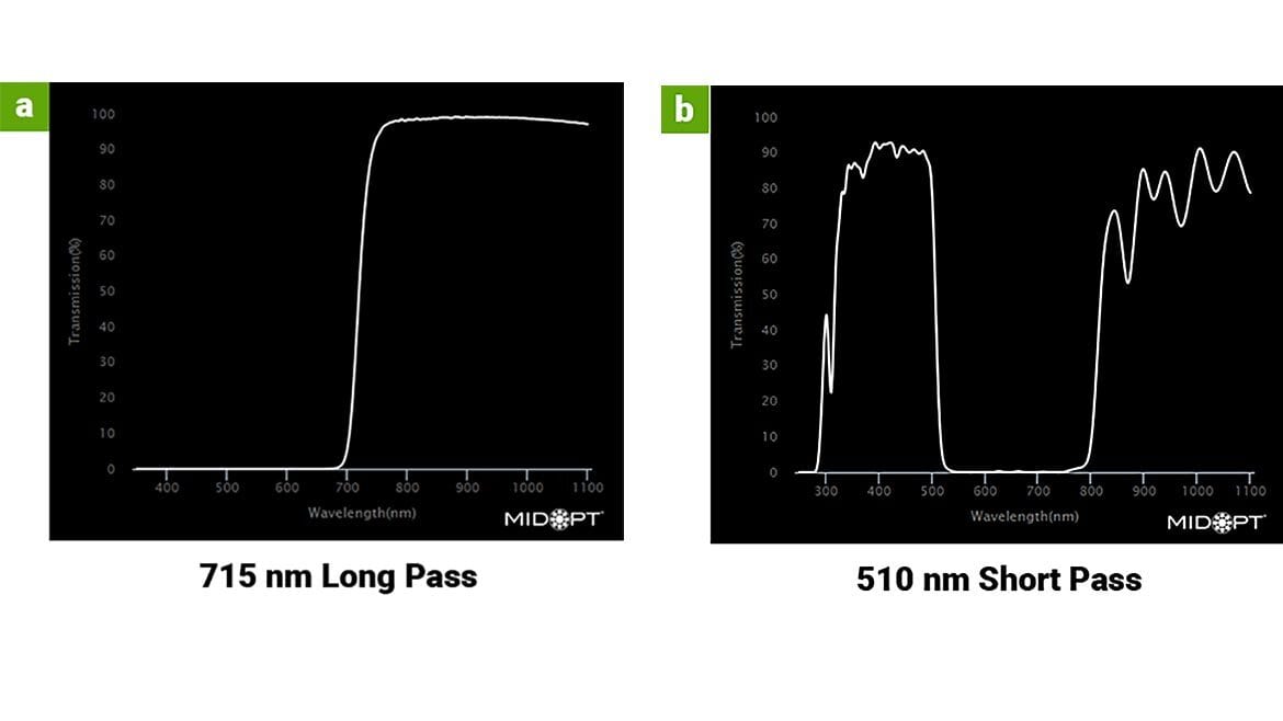

  1. Band Pass Filters: These filters transmit a specific range of wavelengths while blocking others and are useful for isolating particular spectral features or working with monochromatic light sources.
  2. Long Pass Filters: Transmitting wavelengths longer than a specific cutoff point, long pass filters are often used with NIR imaging to block visible light.
  3. Short Pass Filters: Transmitting wavelengths shorter than a specific cutoff point, short pass filters can be used to block NIR when only visible light response is desired.
A typical spectral transmission curve for a long pass filter (a), a short pass filter (b)
a typical threaded band pass filter for red 660 nm light (d).
Figure 6: A typical spectral transmission curve for a long pass filter (a), a short pass filter (b), and a band pass filter (c) and a typical threaded band pass filter for red 660 nm light (d). (Graphics Courtesy of Midwest Optical, Palatine, IL.)

One main application for optical filters is ambient light mitigation to prevent uncontrolled ambient illumination from ruining the consistency and reliability of machine vision inspections. A band pass filter matched to the wavelength of the primary illumination source can block most ambient light while still allowing the camera to receive the desired signal.
A camera lens fitted with a red band pass filter will transmit red light from a red LED light source while blocking most ambient light from fluorescent lights or mercury vapor lamps. Pulsed LED lighting makes this technique particularly effective.

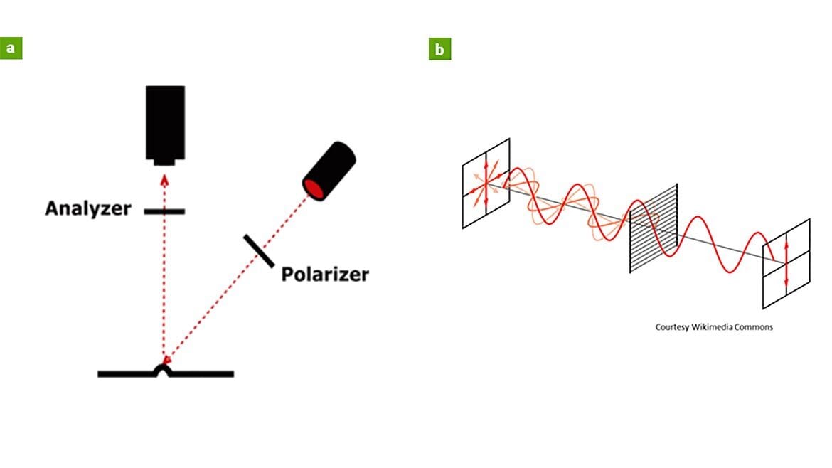

Machine vision applications often suffer from glare and reflections, which obscure critical features. Polarizing filters offer a powerful tool for reducing these problems. Light becomes partially polarized when it reflects off a nonmetallic surface. It is possible to eliminate much of the glare by using a polarizing filter oriented perpendicular to the reflected polarization.
Figure 7: An arrangement of relative optical paths between a polarizer and an analyzer. (a) Front lighting arrangement. (b) Single-wave oscillation through a linear polarizer.
It is usually best to use polarizing filters in pairs — one on the light source and one on the camera lens — for maximum effectiveness. Glare reduction can be finetuned by rotating these filters relative to each other. Materials with high reflection or transparency can be examined using this technique.
Although polarization can significantly improve image quality in many situations, it does come at the cost of overall light transmission. It is common for polarizing filters to reduce light intensity by 50% or more, which may necessitate longer exposure times or more intense illumination.

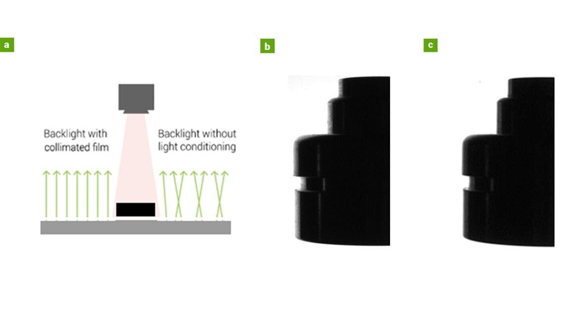

Enhancing Edge Detection With Collimation
Although light collimation is not strictly a filtering technique, it does share some similarities in its application and benefits. In collimation, light rays are made parallel with the help of specialized films or lenses. Machine vision applications that require high-precision measurements and edge detection benefit greatly from collimated backlighting.
Figure 8: (a) Light ray tracing with collimation on the left side versus the more random ray exit angles of the non-collimated backlight. (b) A curved part in front of a non-collimated backlight with better edge definition. (c) The same part in front of a film-collimated backlight showing greater edge definition on the true maximum projection of the part.
Compared to diffuse illumination, collimated light produces sharper shadows and more defined edges. For gaging and measuring tasks, this leads to more accurate edge locations in captured images. Moreover, collimation reduces uncertainty in measurements caused by light diffraction around object edges.
