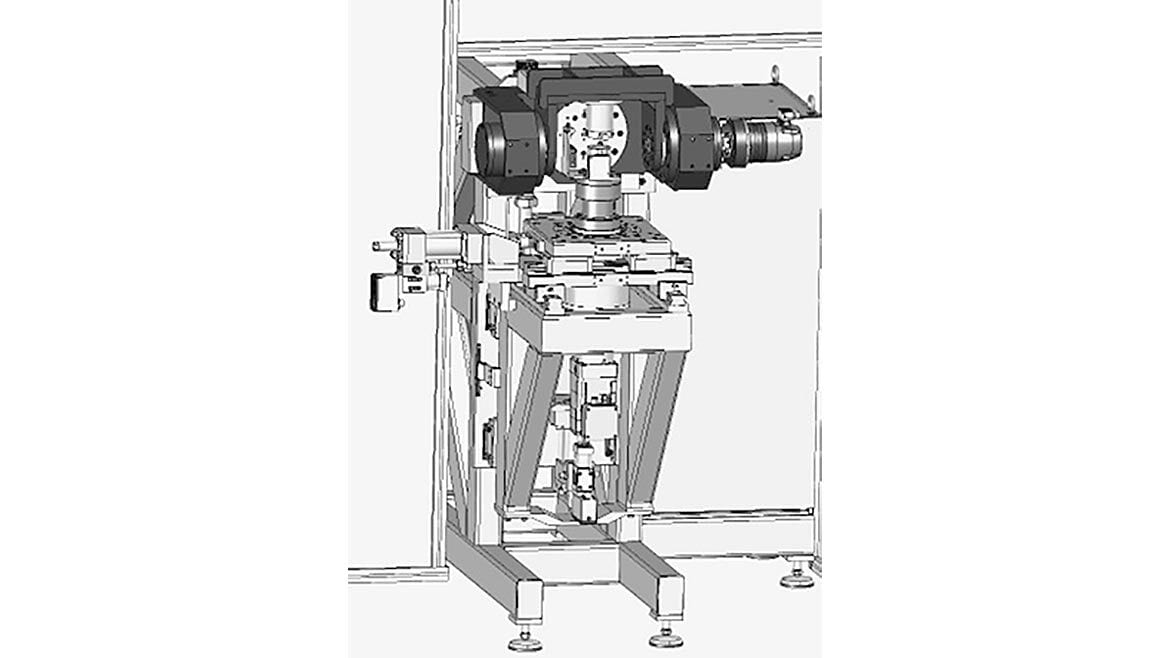

Sketch diagram of AHP’s proposed ball joint tester.

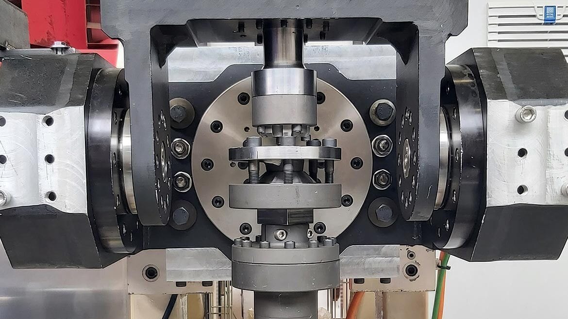

The ball joint test in question uses two hydraulically controlled axes: a horizontal (y-axis) and a vertical (z-axis), both with linear actuators, and both with electric torque axes. The hydraulic cylinders deliver position and force feedback into a programmable user-machine interface. The problem came down to precision and reliability.
“SIDEM NV commented that their existing system was not accurate enough,” says AHP Hydraulics automation engineer Ewout Reuman. They wanted a force tolerance of ±100 newtons over a total range of 6000 newtons. On the rotation, they specified a total tolerance of 0.5 degrees over a total range of 90 degrees while cycling at 4 Hz. “The rotational motion and the hydraulics had to be very accurate, and there I was on Google and YouTube trying to learn about the subject, quickly realizing how much I needed to pick exactly the right control product.”

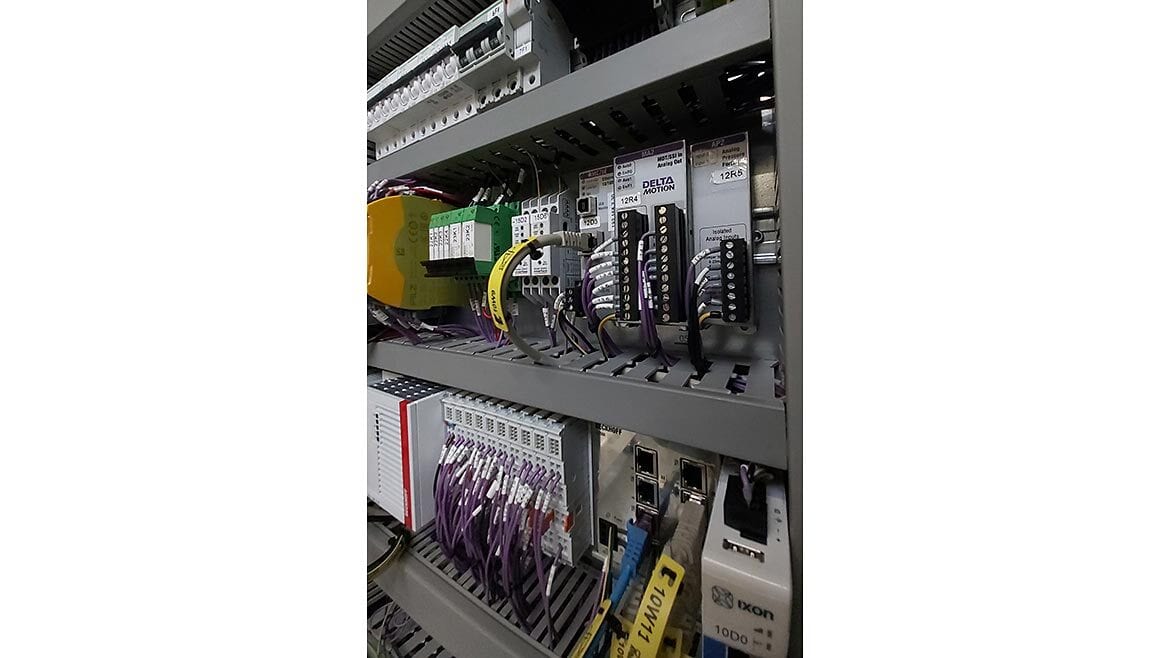

AHP’s first step was procuring the client’s current ball joint tester and disassembling it into the mechanical parts. This allowed them to examine the electronics and consider how to improve the horizontal axis (y-axis) and vertical axis (z-axis) of hydraulic circuits and components. Ultimately, AHP rebuilt the tester from bottom to top and re-engineered the electronics and software. That included scrapping the conventional PC for motion control in the electrical cabinet and replacing it with a Beckhoff PLC functioning as the master and the Delta Motion controller as a slave for the hydraulics.
AHP ball joint tester control cabinet featuring the Delta RMC75E motion controller.
AHP’s Ewout Reuman found himself tasked with handling the ball joint tester’s electrical engineering and software programming. Once he understood the accuracy needed in the solution and why prior attempts had fallen short, he reached out to Delta Motion, which in turn led to Delta sending a representative to Brussels to work alongside the AHP team in understanding the system’s challenges and how to solve them.
AHP procured Delta’s RMC75E dual-axis motion controller with Ethernet connectivity for communication with the system’s master PLC. Reuman paired this with Delta’s MA2 magnetostrictive I/O module and the AP2 analog I/O module for measuring force feedback from load cells.

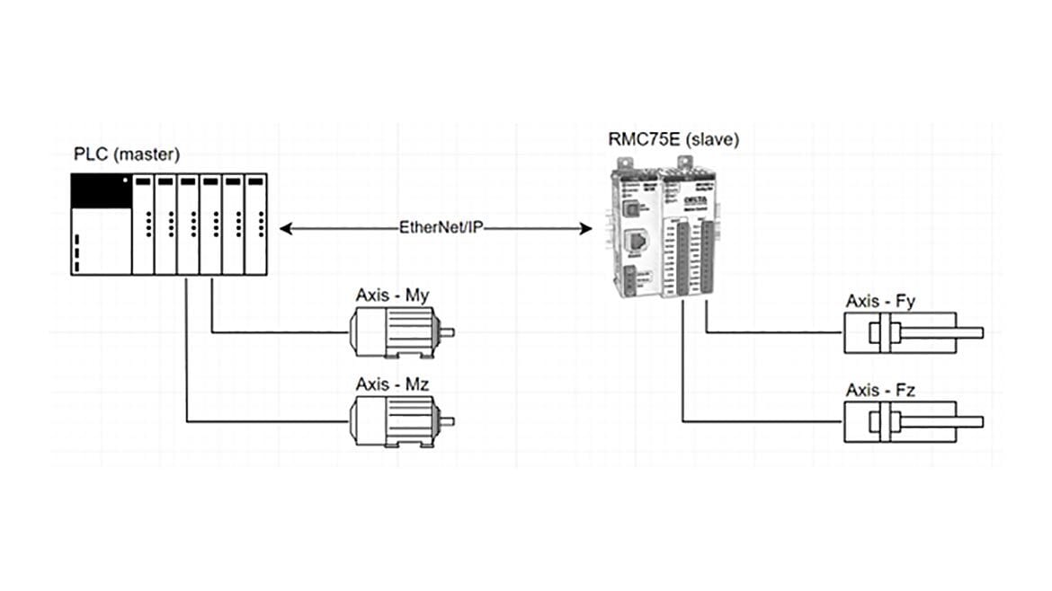

The two linear axes are controlled by a hydraulic servo valve and cylinder. The complete testing machine is controlled by a PLC, with the PLC providing set points and controlling both the rotational axes as well as the Delta Motion controller via an Ethernet IP connection. Within that PLC/Delta loop, in which the Delta serves as a network slave to the PLC master, the Delta RMC controls the hydraulic accuracy, error correction, and other factors.
Diagram of the basic PLC/Delta functionality.

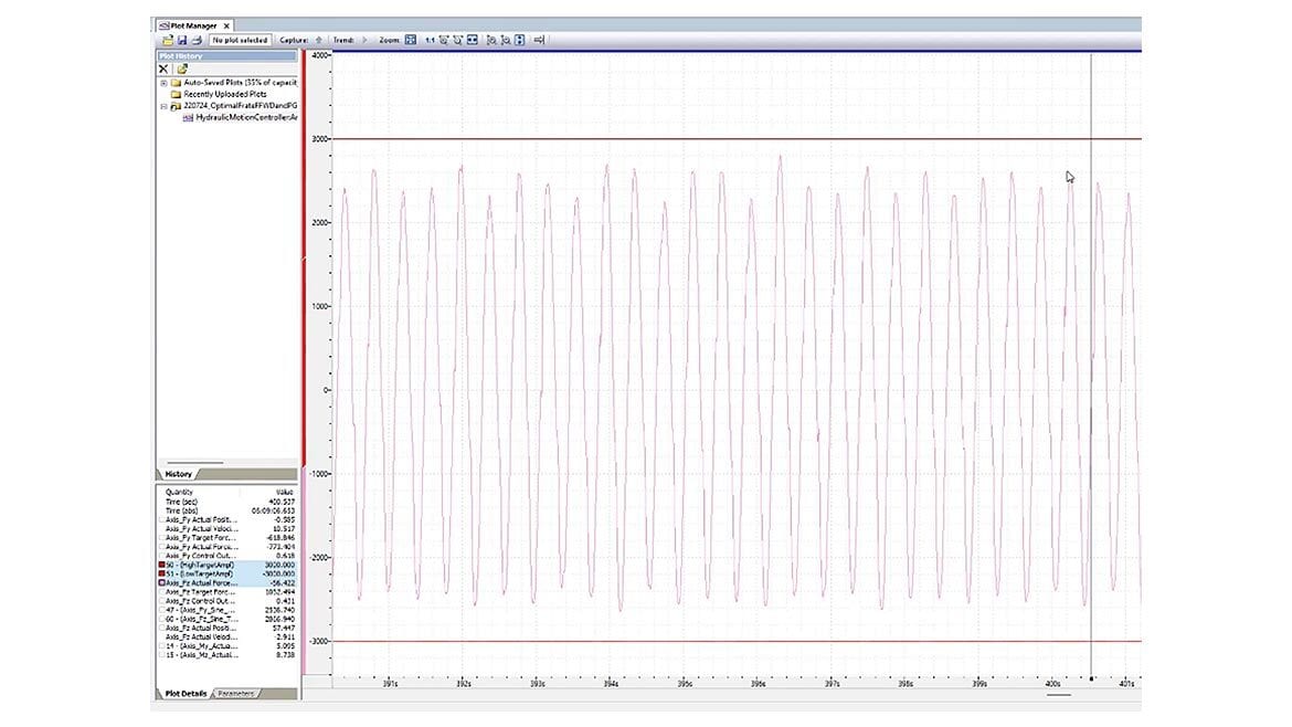

The nature of the directional forces within the apparatus led to some vexing challenges. Imagine the central ball joint continually rotating back and forth within its housing while being pushed on both from the side and below, all while a boom allowed the ball joint to swing back and forth, and the give within that joint housing allowed the ball to be constantly off-center. With these multiple forces all interacting, there was never a perfect center state; the system was always in a state of deviation and change. Asynchronous force testing was always inaccurate. That alone was something AHP’s client could accept, but the deal breaker was the system’s propensity to show force steadily growing over time. The customer demanded that asynchronous force be stable.
“I tuned my axes to specific frequencies, force amplitudes, and oil temperatures and the specific supply pressure for the pump and accumulators,” says Reuman. “But our setup is highly dynamic—the operator can select any combination from 0 to 6000 Newtons and 0 to 4 Hertz. Environmental factors also play a role. For example, if the power unit is located outdoors, weather conditions ranging from -30°C to +40°C will impact oil viscosity during test runs. To address this, we installed both a heater and a cooler. However, at the extremes of this temperature range, the system may struggle to maintain the setpoint consistently.”
“Going into the project,” he adds, “I wasn’t aware how much influence that would have. I would get immense overshoots and undershoots, so I was constantly retuning the system when test frequencies, amplitudes, or oil temperature changed.”
Understandably, Reuman turned to Delta support for help.
Figuring Out the Fix

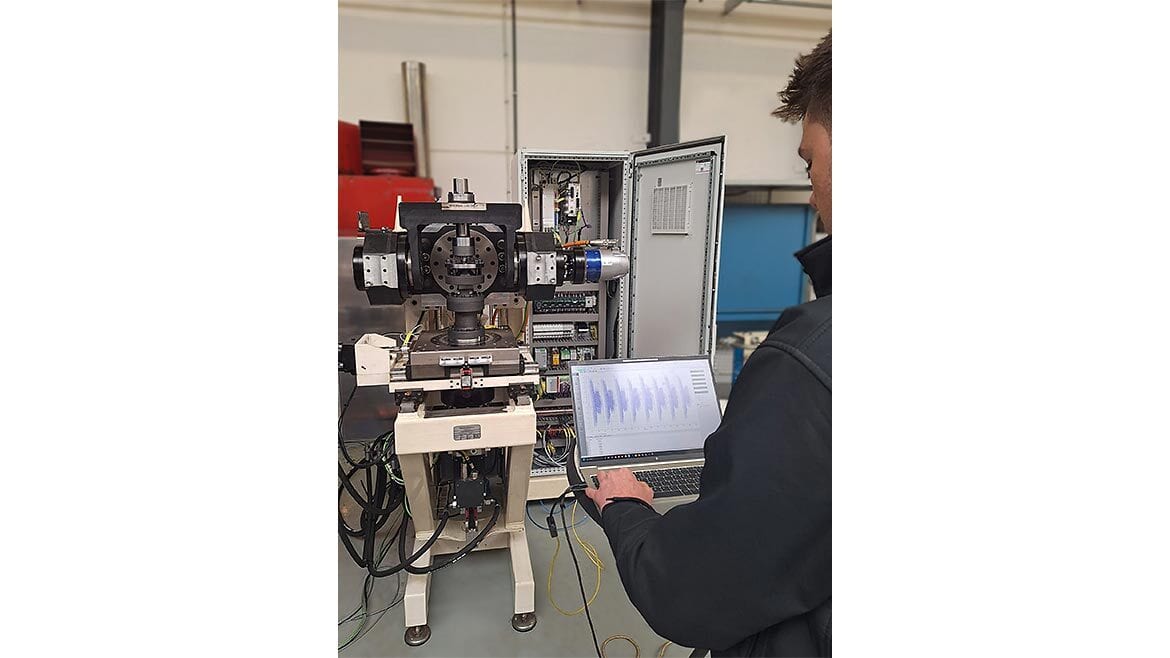

The situation called for rethinking the tuning. Delta suggested that adaptive amplitude control could fix AHP’s precision and reliability. AHP could measure every sine wave cycle and compare it to the target. Then the controller adjusts the amplitude and offset for the following sine wave cycle until the target and actual forces coincide.
Graph of asynchronous AHP ball joint test data for the Fz (vertical push/pull) axis. Note the rise and fall in the wave peaks.
Taking inspiration from Delta’s sample projects, Reuman identified a repeating wave pattern in the force curve. While the sample project provided the foundation for implementing adaptive amplitude control, Reuman added the wave pattern solution he developed. If all axes were synchronous, then the peaks would be flat. Based on the input frequencies, Reuman used Delta’s RMCTools software to identify the wave pattern in the wave crests and troughs and arrive at a method of offset and amplitude gains to compensate for it. For example, if the highest peaks occurred with every fourth wave, then the instance of one peak wave could inform how to compensate for the next fourth peak. (In reality, Reuman ultimately compensated for every sixteenth peak.) This dynamic approach proved far better than AHP’s previous approach of applying one set of offset and amplitude gain values for every wave. With wave peaks brought back within acceptance tolerances, AHP could successfully use PID control to control force between the peaks and thus rectify that runaway force growth.
This combination of adaptive control and PID tuning was the missing key that allowed AHP to succeed with its ball joint tester.
With some fine-tuning, Reuman easily mapped the changes he worked out in RMCTools to his own application. No additional sensors or other equipment were needed to successfully implement adaptive control. It simply dropped into place via software.

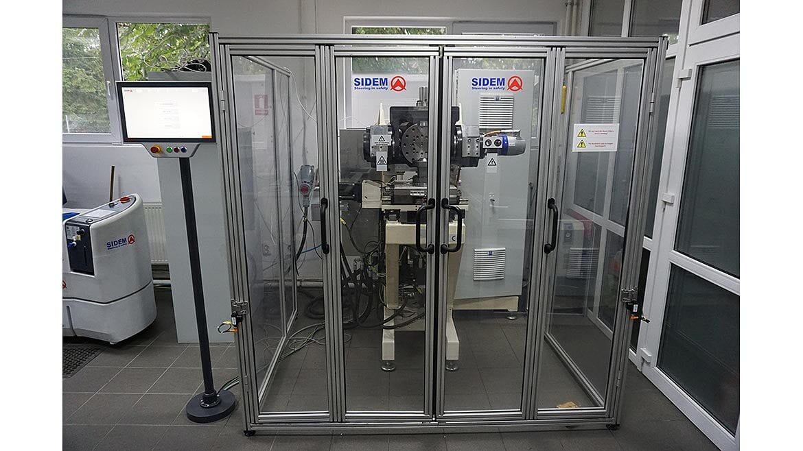

AHP’s ball joint test operating at the SIDEM NV’s site.

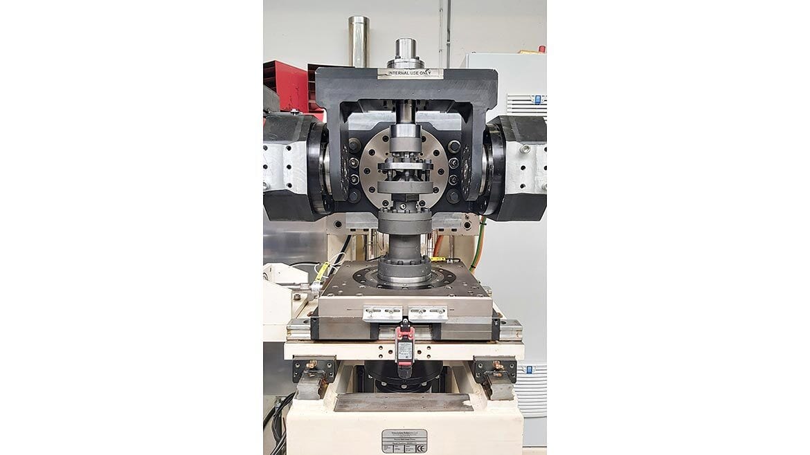

AHP’s ball joint test at AHP’s headquarters.
