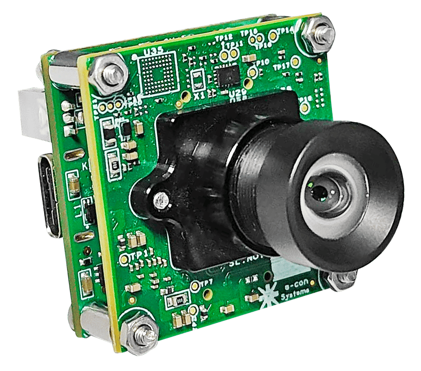

For instance, a recent camera uses a patented separation algorithm to process RGB and IR frames separately from the sensor. It can extract images in RGB and IR spectrums effortlessly without needing a mechanical switch or causing color corruption. This helps medical imaging devices perform exceptionally well, even when dealing with NIR regions.
Image Source: e-con Systems
Prabu Kumar is the Chief Technology Officer and Head of Camera Products at e-con Systems, and comes with a rich experience of more than 15 years in the embedded vision space. He brings to the table a deep knowledge in USB cameras, embedded vision cameras, vision algorithms and FPGAs. He has built 50+ camera solutions spanning various domains such as medical, industrial, agriculture, retail, biometrics, and more. He also comes with expertise in device driver development and BSP development. Currently, his focus is to build smart camera solutions that power new age AI based applications. Please visit the product page to learn about See3CAM_CU83.
