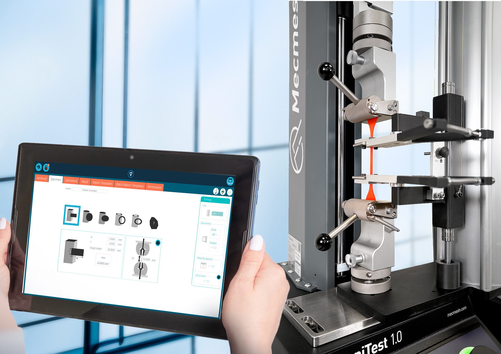

A software-driven UTM allows the human user to efficiently specify the test specimen’s initial geometry, and connect dedicated grips and digital instrumentation—an extensometer—designed to optimize the accuracy of the measurements taken. The program then handles the scientific calculations and communicates the output back to the user. This type of system now operates as an essential team member in quality assurance divisions globally.

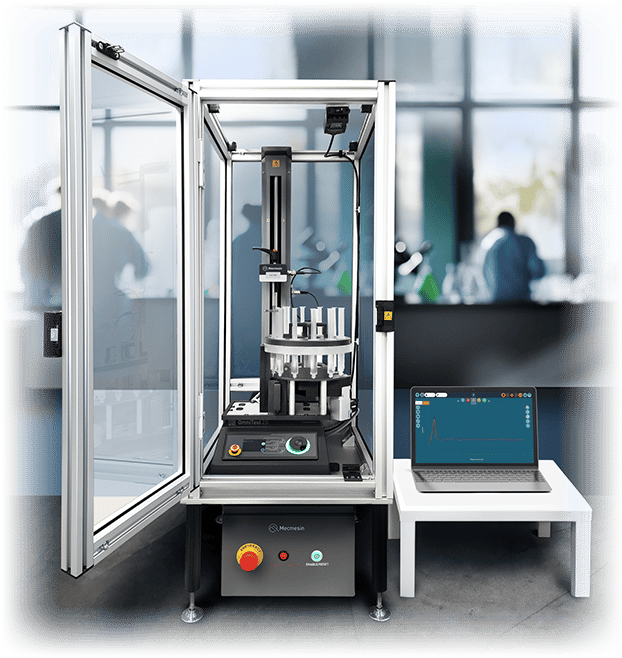

The same hardware, fitted with a flat-faced probe accessory is used to push the plunger of a syringe, measuring the effort required to expel the fluid from the cylinder. This ‘break-loose and glide’ force characteristic is influential in the efficient—and pain-free—delivery of the drug. Connectivity to external components and software control allows automation of elements in the complete testing cycle. Here a rotating carousel is loaded with a dozen test syringes and the results are calculated for the complete batch with intervention from a human operator.

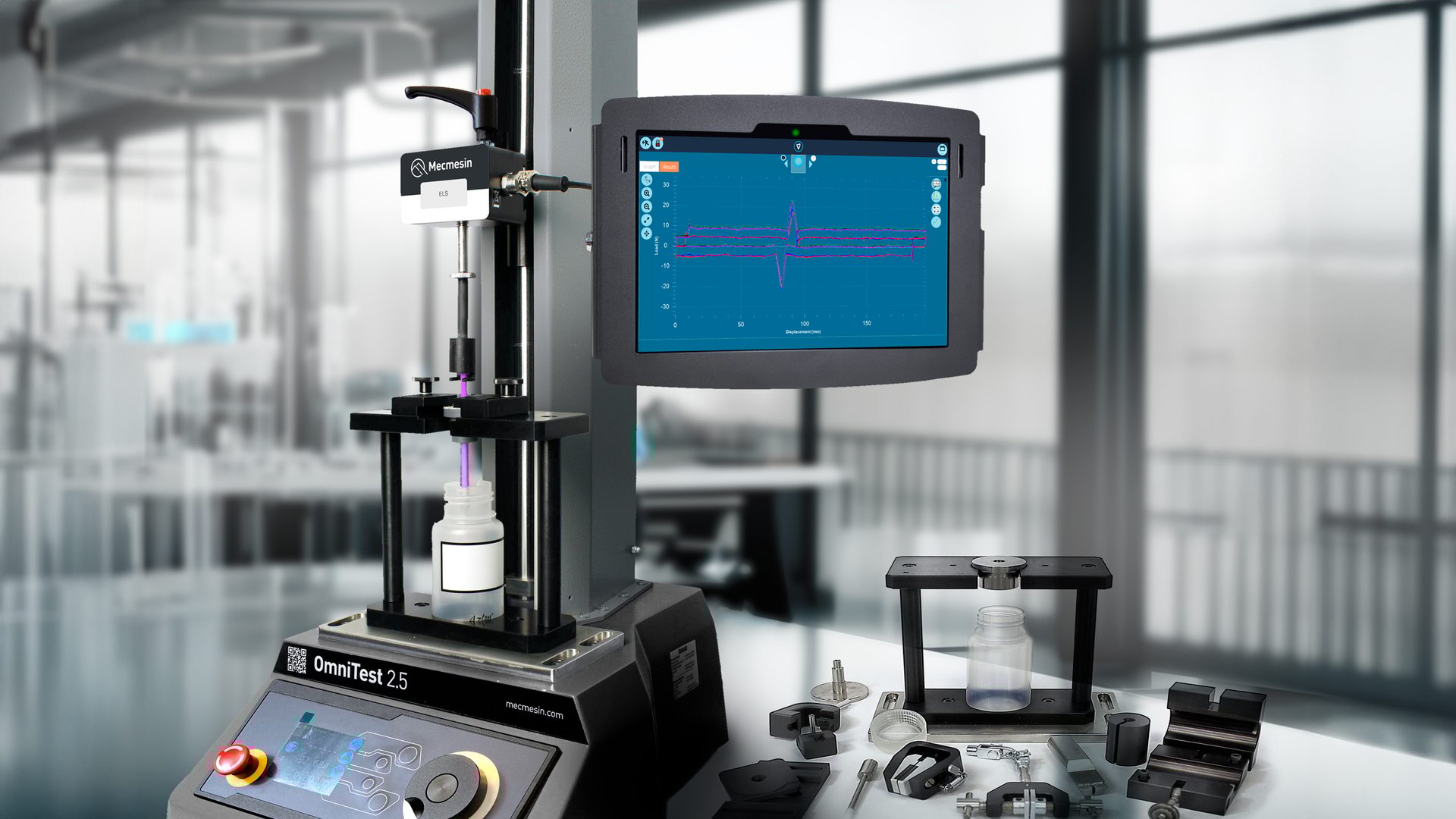

Quality in design is a foundation of quality in manufacture. A single tester in the R&D environment can not only replicate the exact checks that may (or must) be performed in production but can implement the full spectrum of functionality assessments that a new product may require. By simply changing the fixturing, testing to in-house benchmarks and against relevant legislation is straightforward. Here, the aspiration and injection effort of a syringe is measured. The medical device industry is heavily regulated, and many standards cover a range of performance tests for a single product—each necessitating a different accessory.
