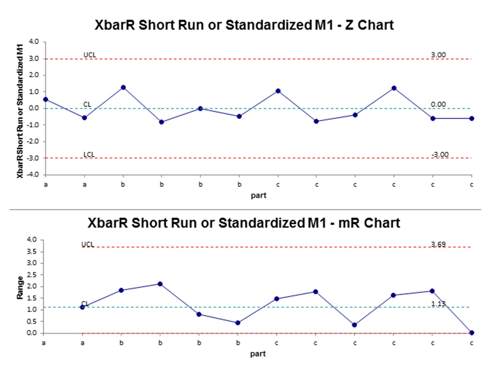

There are two main types of short run charts: Z charts and difference charts. Z charts normalize the measurements into standard values that can be compared. Difference charts subtract a target or historical average value from each measurement, yielding a difference. The differences can be plotted as a control chart.
Using ZmR chart for Variable Data
ZmR charts normalize the data for each of the small batches. Normalizing the data lets you analyze different runs using a single control chart. Affordable SPC software will do this transformation for you and plot the results. Figure 1 shows an example of a ZmR chart for three different parts. There are no out-of-control points. The process is in control.

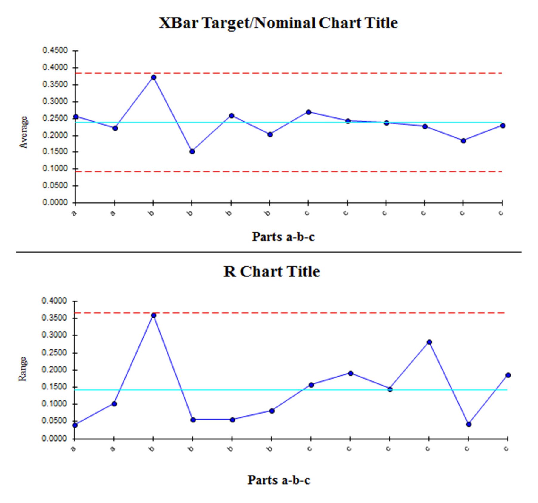

Also known as Nominal or Target Charts, the measured values are adjusted by subtracting a target value which give the variation from the target. Figures 2-3 show an example of an XbarR chart using targets for three parts. Here again, the process is in control.
Fig 2 Xbar R Difference Data
Figure 1: A depiction of how a skidded system’s hinged probe and a skidless system’s flat reference datum (surface) acquire data for measurements.
Fig 3 Xbar R Difference Chart
