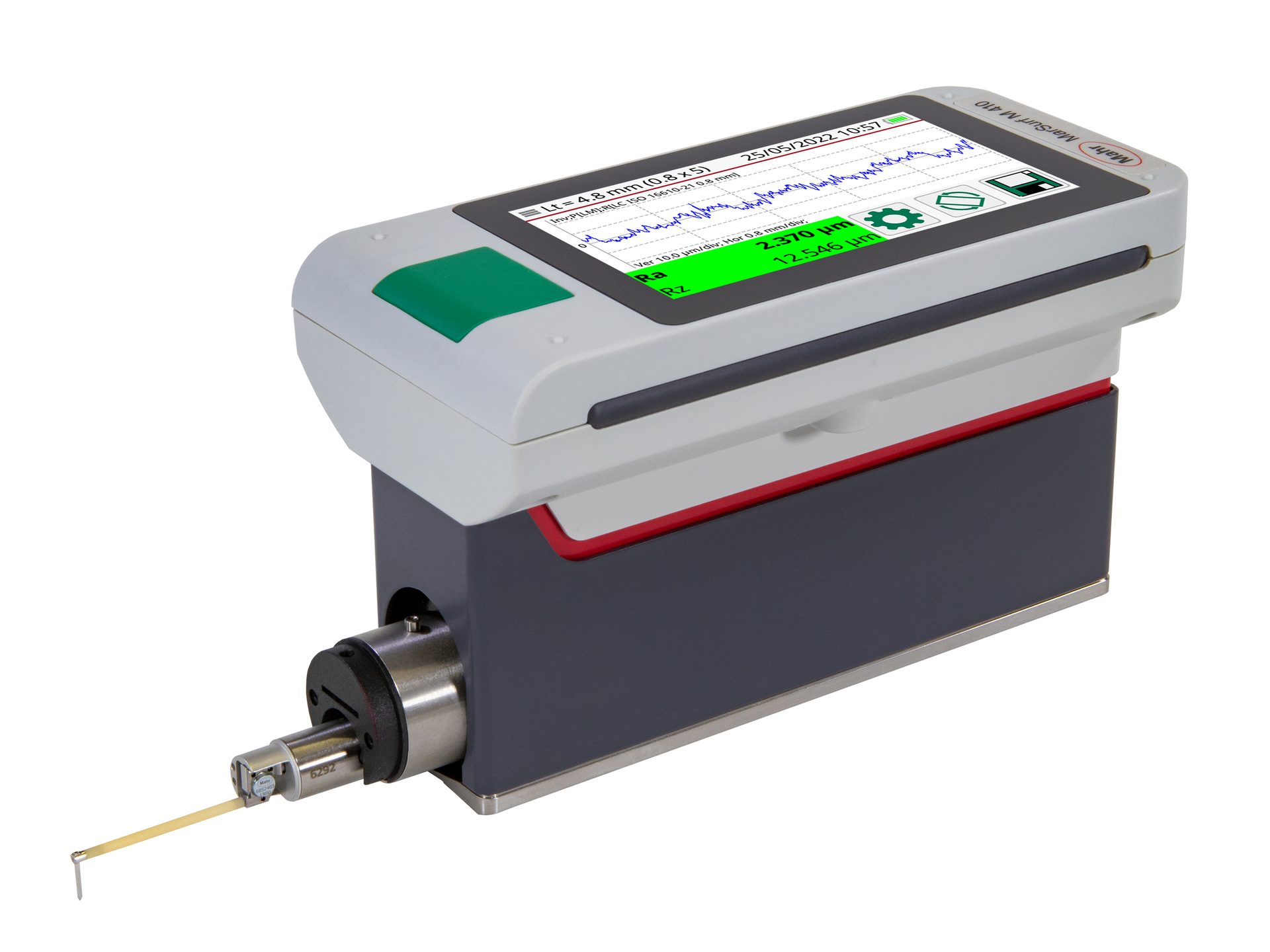

The MarSurf M410, a portable, skiddless unit.

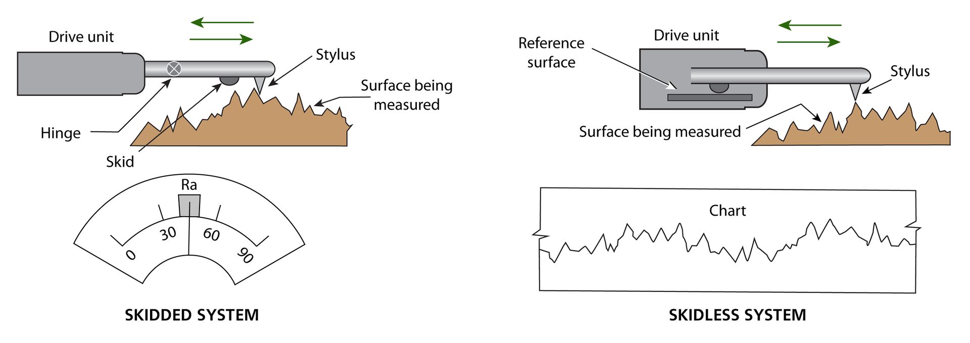

There are two main types of surface finish gages: skidded and skidless.
Skidded units are typically more common as they are less susceptible to background vibrations. A skidded system has a hinged probe. The probe rides next to a skid to measure the probe deflection. Both the probe and skid make contact with the workpiece. These units also inherently filter out waviness, so only short wavelength variations are recorded.
A skidless unit, as implied in its name, lacks a skid. In its place, the drive unit traverses a flat reference datum to measure the probe deflection. This flat reference datum also allows the user to measure workpiece waviness, which a skidded system cannot do.
A depiction of how a skidded system’s hinged probe and a skidless system’s flat reference datum (surface) acquire data for measurements.
Figure 1: A depiction of how a skidded system’s hinged probe and a skidless system’s flat reference datum (surface) acquire data for measurements.
Whether you are using a skidded or skidless unit, it is essential to calibrate them using certified reference standards that can be traced to international governing standards (e.g., ISO, DIN, and ASME) to provide an accurate pass/fail of the workpiece. Inaccurate pass/fails can lead to assembly failure and remanufacturing of workpieces, which can be very costly.
Figure 2: The MarSurf M410, a portable, skidless unit.

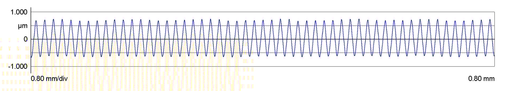

A stylus integrity check examines the stylus under a magnifier or measures a stylus check reference standard. Ensuring the probe has the same stylus radius as the reference standard, denoted on its calibration certificate, is imperative. Larger or smaller radius probes will fall into peaks and valleys differently. Therefore, measurements in the same location may have varying results if measured with a 2μm or a 5μm radius stylus.
Typically, a stylus check reference standard has an approximate roughness average, or Ra, of 0.4μm (16μin) and is a sawtooth (triangular) profile. This triangular profile helps determine if there is any damage to the probe, as the saw teeth are so compact that there is little margin for error in the geometry of the stylus. Visually, the saw teeth should be sharp on the top of the peaks; if they are rounded, this indicates stylus wear.

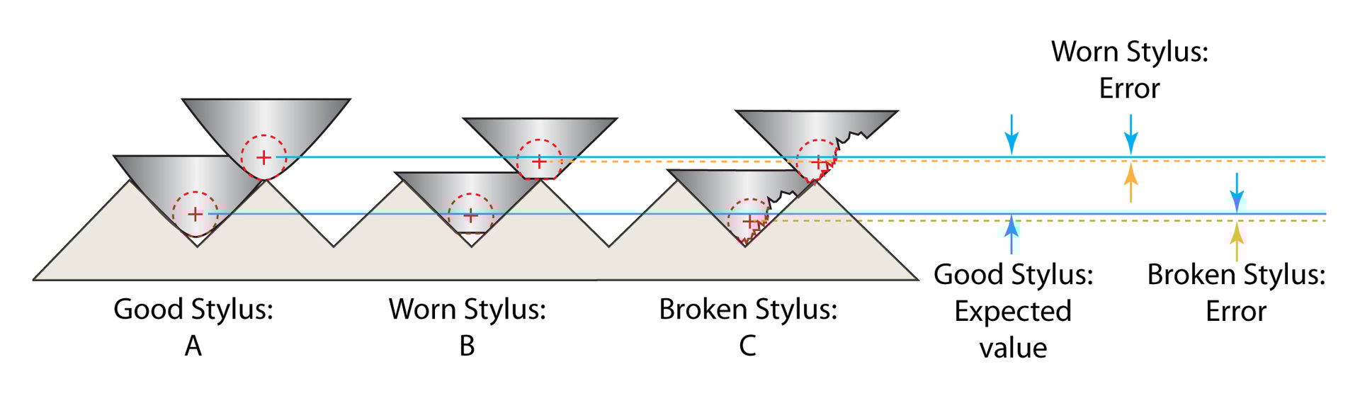

Any error in the geometry of the stylus can and will affect measurement results. This error in geometry is either in the form of wear or damage. Since the diamond stylus is constantly being dragged across a surface with a force anywhere between 100mg and 1500mg (1mN to 15mN), it’s inevitable that the stylus will eventually wear. However, since it is constructed of diamond and the measuring force is relatively low, this usually will only occur after a significant number of measurements and is dependent on the material of the workpieces being measured.
Harder surfaces can make the diamond wear faster. A worn stylus will usually under-report the peak-to-valley distances. Damage occurs when the stylus is dropped, impacted, or has had some sort of heavy physical contact. A damaged stylus can either under- or over-report depending on how (and where) the stylus is broken. A broken stylus can even damage the workpiece being measured.
Worn stylus B is shown to under-report the peak-to-valley distance as the wear is inaccurately determining the peak. Broken stylus C is over-reporting because the break is inaccurately determining the peak and valley.

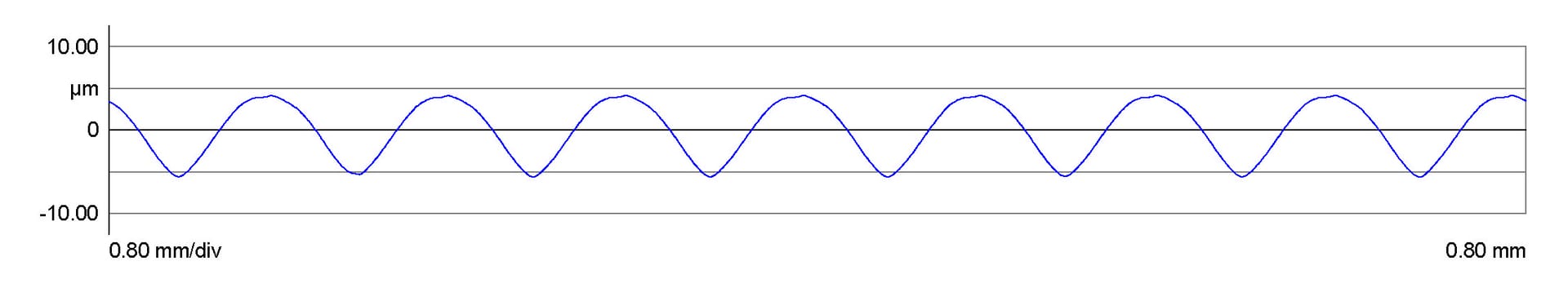

There is also a calibration standard outside of a stylus check reference standard. This standard typically has an approximate Ra of 2-3μm (79-116μin) in a sinusoid wave. Users are often under the impression that the probe must calibrate to an Ra value close to what is being measured. This is actually not true. Large linearity errors can be introduced if the anticipated result requires a much larger probe deflection than previously calibrated. Therefore, if you calibrate to an Ra of 3μm and measure a 0.4μm workpiece, the measured probe deflection is within the calibrated probe deflection, whereas the inverse is not true. This allows the probe to be calibrated over as large a range as possible to ensure proper operation anywhere within that range. Because this sinusoidal wave is not as compact as the sawtooth profile, it is generally not a good indication of probe integrity.
Figure 5: A typical sinusoid wave calibration profile.
The actual calibration process is simple: measure the calibration reference standard, evaluate with Ra, and see what the result is. A reference standard‘s calibration certificate will indicate the certified Ra value. After the measurements, compare the measured Ra value to the certified Ra value. This should be within an error percentage specified by the original manufacturer (typically no more than +10%). The system should then be adjusted based on the manufacturer’s process.
