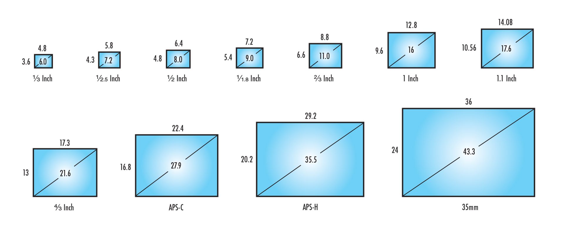

Imager size and sensor
Sensors are typically rectangular in shape, while lenses are round. In both cases it is due to the pragmatics of engineering design, production costs, physics, and performance. Matching a lens to a sensor may sound a bit like putting a square peg in a round hole!
Some typical sensor sizes
Some typical sensor sizes. Image courtesy of Edmund Optics, Inc.
In fact, it’s being sure the round cone of light fully reaches the corners of the rectangle, as it would be a shame to pay for the whole sensor and fail to utilize all the available pixels. So, the lens has to fully cover the sensor – it can be “just right” or “too big” – but should not be “too small.”
While it’s okay if the image is bigger than the sensor, ideally it’s not a lot bigger or you’ll have paid for more glass and a larger and heavier lens than would be optimal, if a smaller option is available.

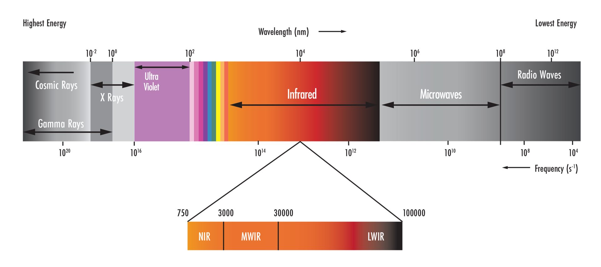

Wavelength
Many machine vision applications operate in the (human-) visible light spectrum, from approximately 380 – 700nm. So, there are a corresponding wealth of sensors, lenses, and optical filters that are sensitive to those wavelengths and that either block or are non-responsive to other wavelengths.
But some of the most innovative and effective machine vision applications operate in the non-visible spectra, including ultra-violet (UV), near infrared (NIR), and infrared (IR). Within infrared there are even distinctions among short wave infrared (SWIR), mid-wave (MWIR) and long-wave (LWIR).
Machine vision applications typically operate in one or more ranges from UV, visible, or IR portions of the spectrum.
Machine vision applications typically operate in one or more ranges from UV, visible, or IR portions of the spectrum. Image courtesy Edmund Optics, Inc.
Conventional (visible light) lenses might be ineffective for applications in other spectral ranges, so there are lenses designed specifically to perform well in certain UV and IR ranges. There are also “combo” lenses that can work in visible and IR, for example. Make sure you choose a lens whose design and performance is well-suited to the camera sensor and application requirements.

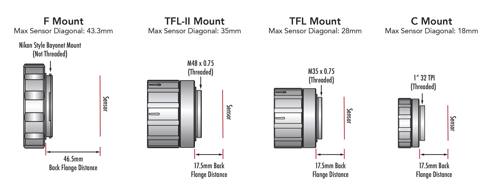

Camera (lens) mount
Most machine vision cameras provide one or more standard lens mounts, so that the same camera may be used for diverse applications – whether by the same user or across thousands of users with differing requirements.
Some popular lens mounts.
Some popular lens mounts. Image courtesy of Edmund Optics, Inc.
Popular lens mounts include M42, CS, C, and F, but there are others as well. The different mounts specify specific diameter openings, thread pitches, distance from the mount to the sensor surface, etc. Certain mounts are better for different purposes, larger diameter mounts for bigger sensors, or better alignment. In machine vision, optical alignment of the lens to sensor on larger more expensive sensors is more critical, and threaded mounts provide better lens to sensor/camera alignment and mounting compared to bayonet mechanical mounts.

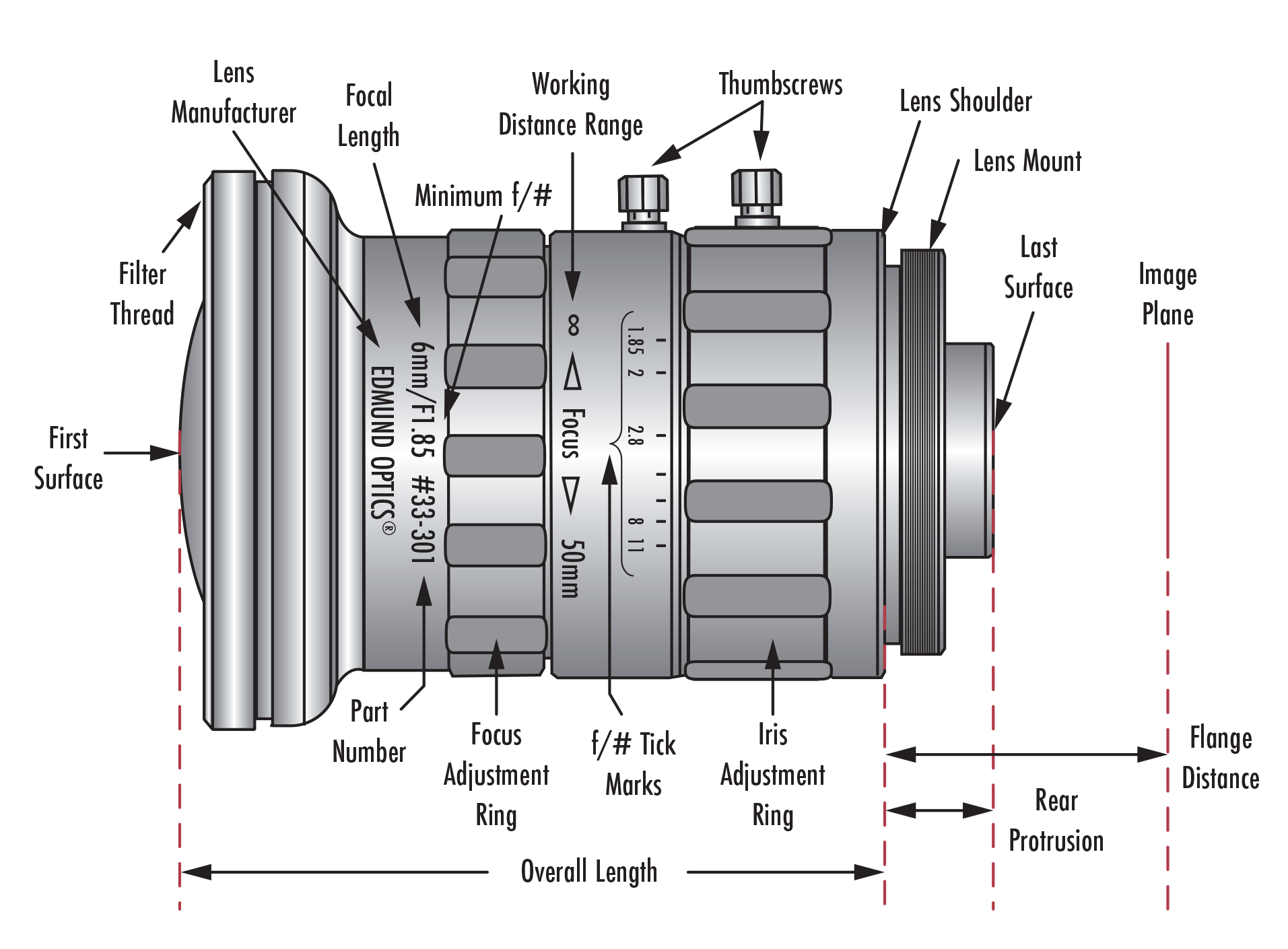

Lenses can be manufactured with varying levels of quality, including plastic housing to even molded plastic lenses. A lens might have fixed or adjustable focus. A set screw could be provided to lock down a focus or aperture control ring. Resolving power of the lens might be excellent, good, or merely good enough (for a non-demanding application).
Lens and its constituent components
Lens and its constituent components. Image courtesy of Edmund Optics, Inc.
