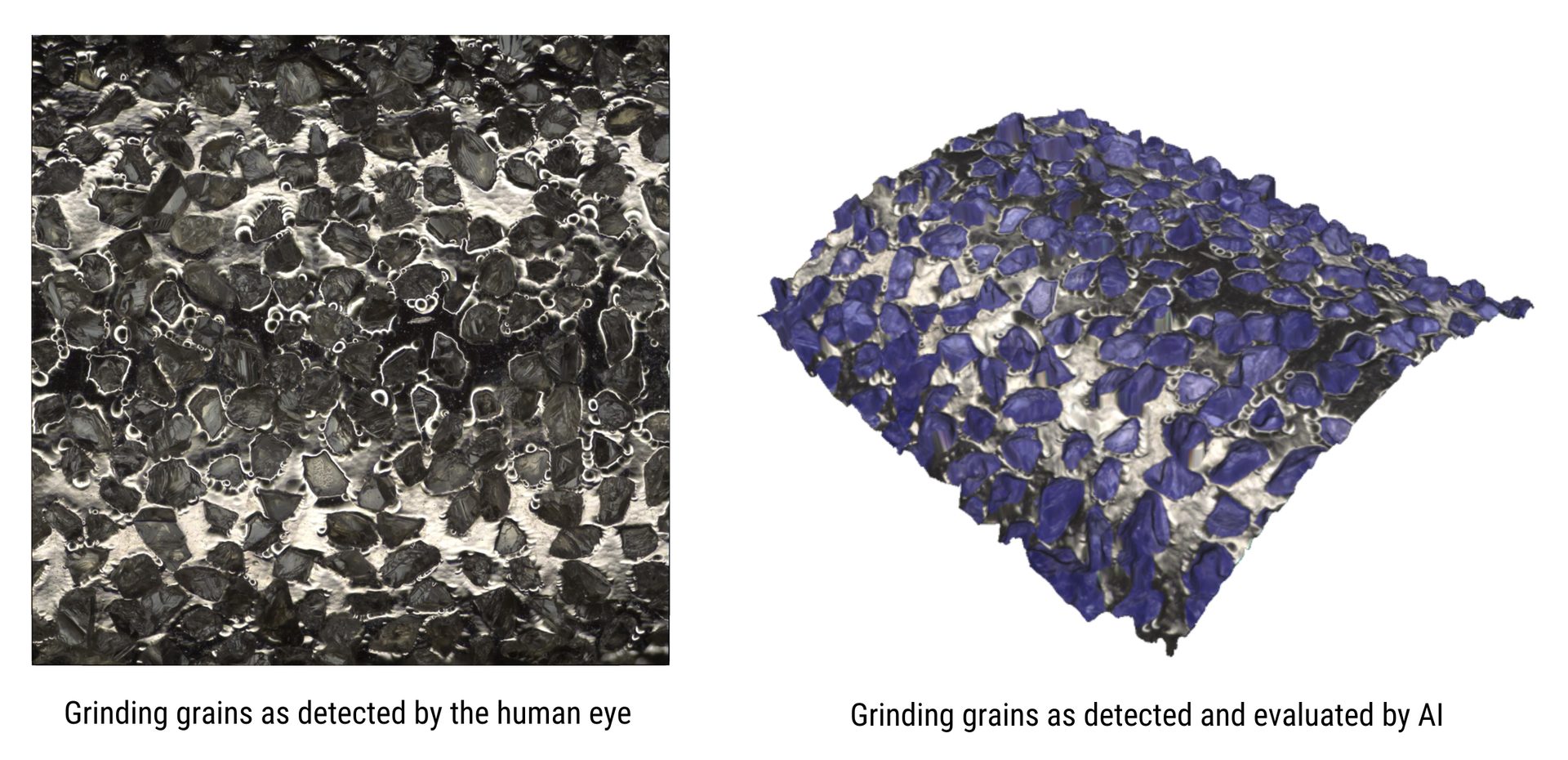

Figure 1 Grinding Grains As Detected And Evaluated By AI
Figure 1: Grinding grains as detected and evaluated by AI.
Practical example: Surface finish of a grinding pin

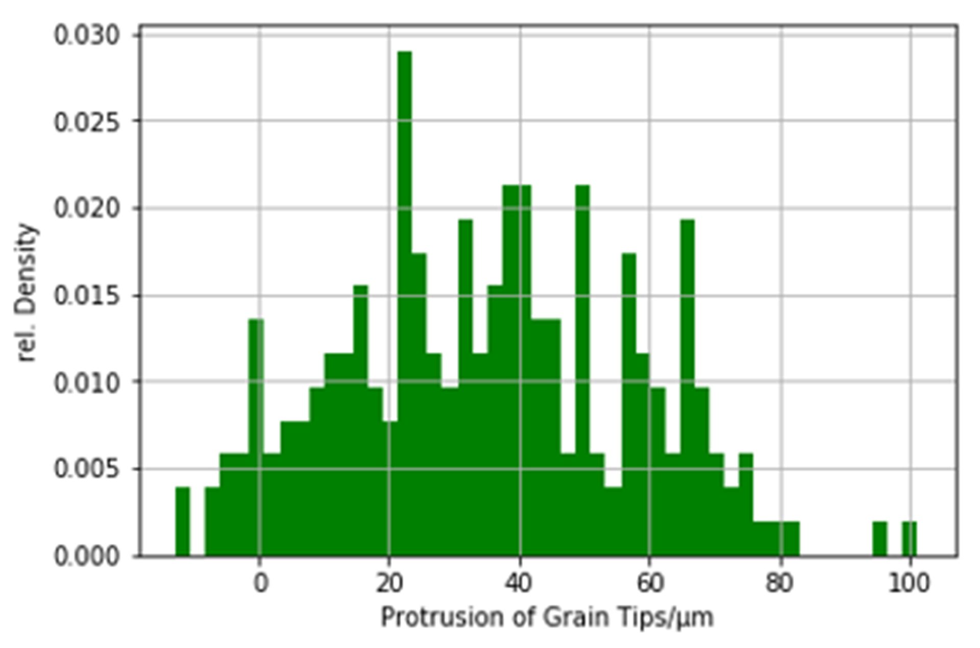

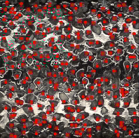

Figure 1 shows all the fine abrasive grains of a grinding tool. And what do you usually do with them? Estimate how big, deep, wide, distributed and so on they are. This is a perfect application example for AI. At the top, you can see the surface of the tool as the human eye perceives it. At the bottom, you can see all the abrasive grains that the artificial intelligence has found. These are the blue dots. The AI makes any estimation obsolete because it can produce an exact result - completely effortlessly compared to humans. Of course, the AI has been shown in advance what is and is not a grinding grain. It receives data from which it learns to identify such grains. This enables it to evaluate not only the quantity but also the distribution, height and so on. This can be seen in Figures 2 and 3. With conventional image processing methods, it is difficult to program a generally robust solution. There are many different grain materials and binding materials and also many different geometries, all of which lead to difficult lighting conditions. But AI can cover this quite well
Figure 2 Identification Of Grain Tips
Figure 2: Identification of grain tips.
Figure 3 Protrusion Of The Grain
Figure 3: Protrusion of the grain
