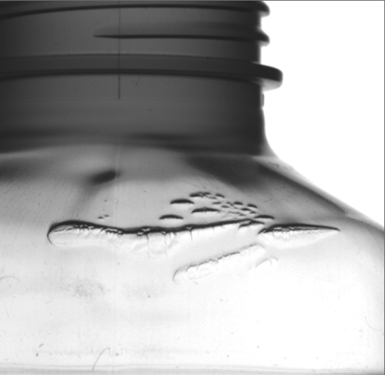

Figure 1
Figure 1
Most applications that have not been possible or feasible to do with traditional machine vision are those where it is not possible to create the “simple rule” aspect of the differentiation. Figure 1 illustrates the type of challenge often involved. In that example, the goal is to find defects on the bottle that are completely transparent and thus normally invisible or hard to see. The image in figure 1 is the result of applying some techniques that make the defects visible (dark). The simple-rule goal is “defects dark, everything else light.” Unfortunately, the technique also makes perfectly good portions of the bottle dark, therefore the “simple-rule” goal was not achieved. This may make it unfeasible to do with traditional machine vision, or unnecessarily difficult compared to using deep learning.
Even though we don’t have “simple rule” differentiation, we still have differentiation. A human can look at a few of these images, and, combined with their experience with bottles, tell the difference between dark parts that are defects and those that aren’t. This situation occurs in a wide variety of other applications such as wood or fabric analysis, surface analysis on complex surfaces, or unclear OCR applications. This is where deep learning shines; if a human can reliably see it with one quick look and decide, it will probably be possible to accomplish utilizing deep learning. We say “one quick look” because humans often do other things not available in a machine vision solution. If they hold and manipulate the product, they are in essence taking 20 looks from varying angles and lighting geometries and if only one of the 20 attempts is successful, that is sufficient.

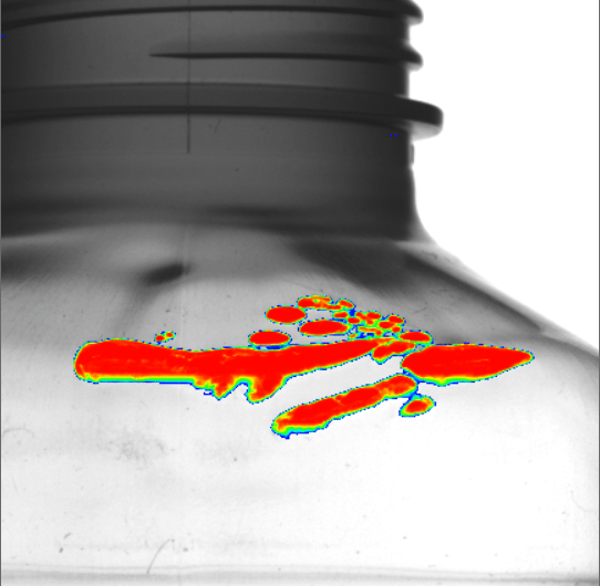

Figure 2
Figure 2
Figure 2 shows one of the available displays of the results, a “heat map” which shades the areas that the model considers defective. Note that it successfully identified the defective areas and was able to ignore the large quantity and diversity of dark areas that are not defects.
