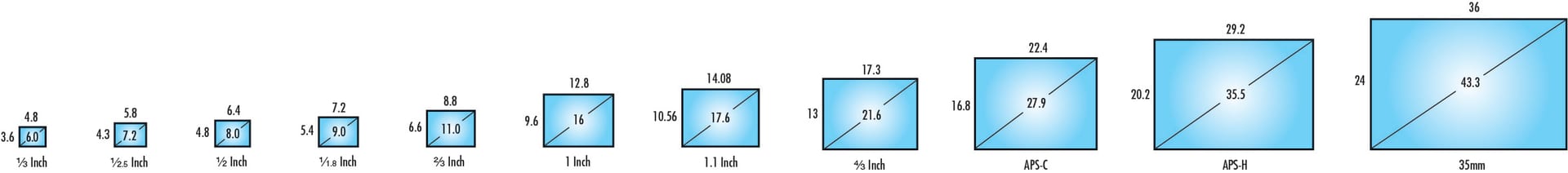

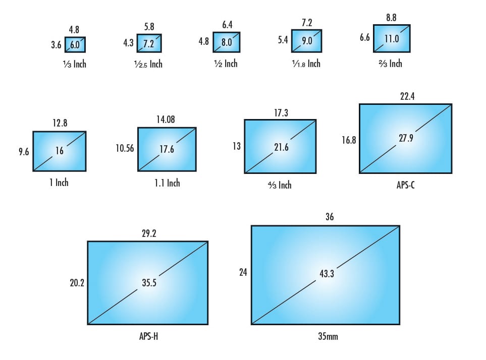

Sensor size determines the size of the FOV and the primary magnification (PMAG) of the system. Figure 1 shows the naming convention used for sensor formats, which is based on obsolete cathode ray video camera tubes for television cameras used from the 1930s to the 1990s. The naming convention, which has numerals, does not provide direct information about the sensor dimensions of which they refer. However, maximum sensor format is specified for imaging lenses on specification sheets. If a camera sensor is larger than the maximum sensor format for the lens, darkening around the edges of the sensor occurs; this phenomenon is called vignetting. Sensor size compatibility is important to keep in mind when selecting an imaging lens.
Figure 1: Sensor size formats for standard machine vision camera sensors.

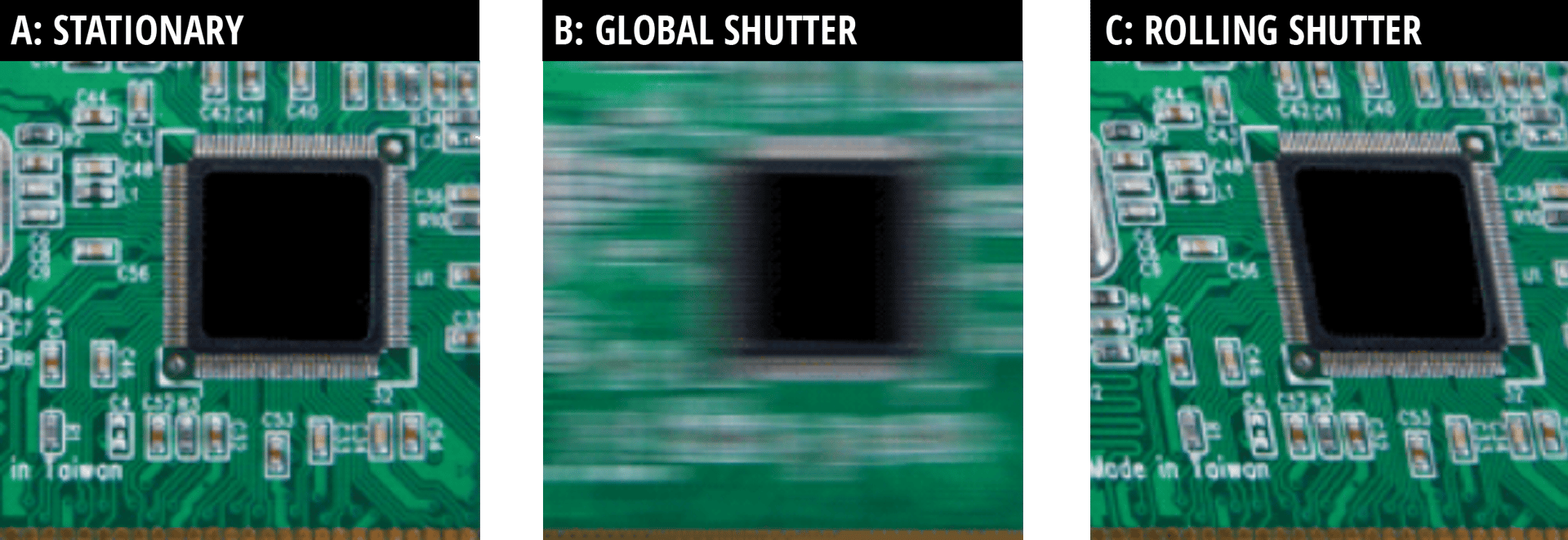

A final consideration for cameras is shutter speed. The camera shutter controls exposure time, which is used to capture pixel contents and then create an image. There are two different standard types of camera shutters: global and rolling. A global shutter exposes and samples pixels simultaneously and pixel readout occurs sequentially. Rolling shutters expose, sample, and then read out sequentially. Thus, each line of pixels is sampled at slightly different times. With a global shutter, a moving object’s image can be distorted and blurred. If the object is moving, a rolling shutter could be considered to prevent distortions. Figure 2 shows the difference in the image captured with these two shutters.
Figure 2: A motion blur comparison showing a stationary object (A), a moving object with continuous global shutter (B), and rolling shutter (C).

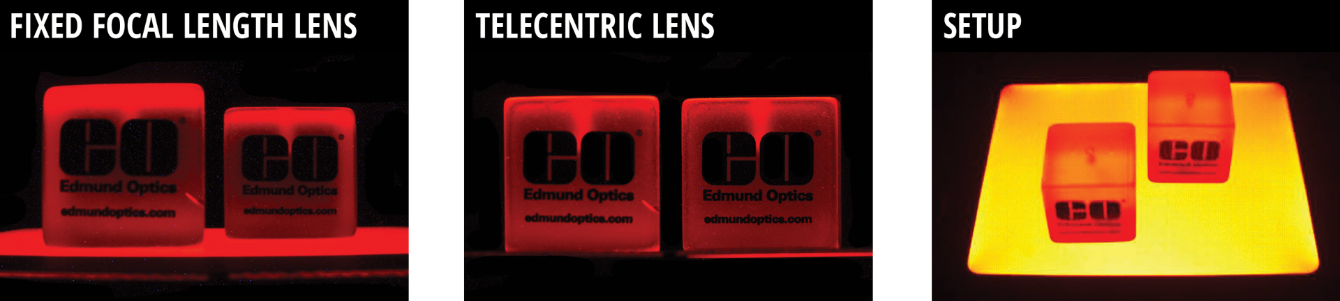

A fixed focal length lens has a fixed angular field of view (AFOV) which defines the image circle. For a given sensor size, shorter focal lengths create wider AFOVs. If the object is stationary, or if the depth of field is not changing, then a fixed focal length lens is sufficient. Additionally, telecentric lenses yield a constant magnification over a range of working distances, eliminating viewing angle error. The images created by telecentric lenses eliminate height variations within objects, which is useful for applications that require dimensionally accurate images. Below in Figure 3, images created by a fixed focal length lens and a telecentric lens are compared.
Figure 3: The images created by a fixed focal length lens and a telecentric lens.

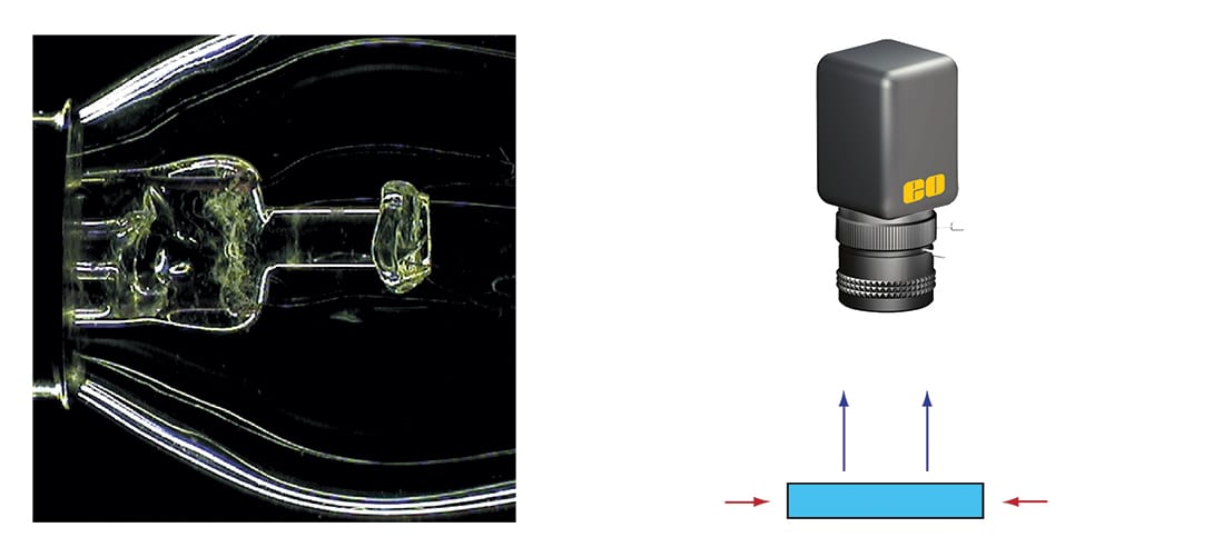

Darkfield
Darkfield- light enters a transparent/translucent object through the edges perpendicular to the lens. Ideal for glass and plastic inspection.

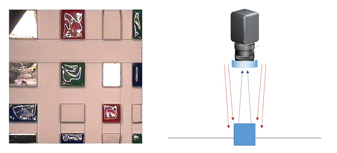

Ring light
Ring light- coaxial illumination that mounts directly on a lens. Ideal for inspection and measurement systems on matte objects.

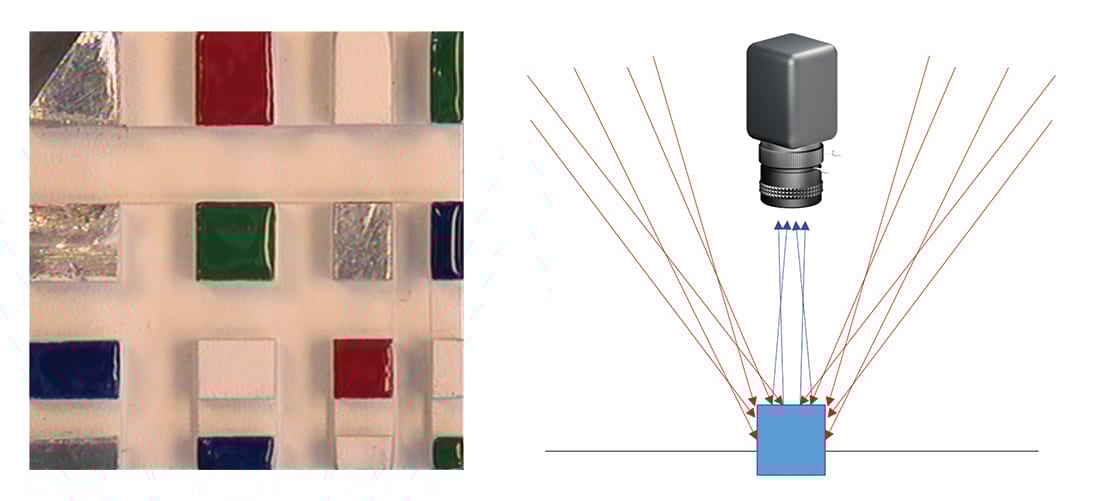

Diffuse illumination
Diffuse illumination – diffuse, even light from an extended source. Ideal for large, shiny objects with large working distances.

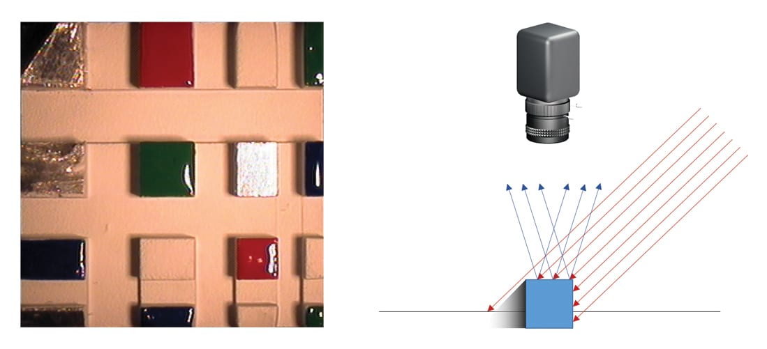

Directional illumination
Directional illumination – point source illumination from single or multiple sources. Ideal for matte and flat objects.

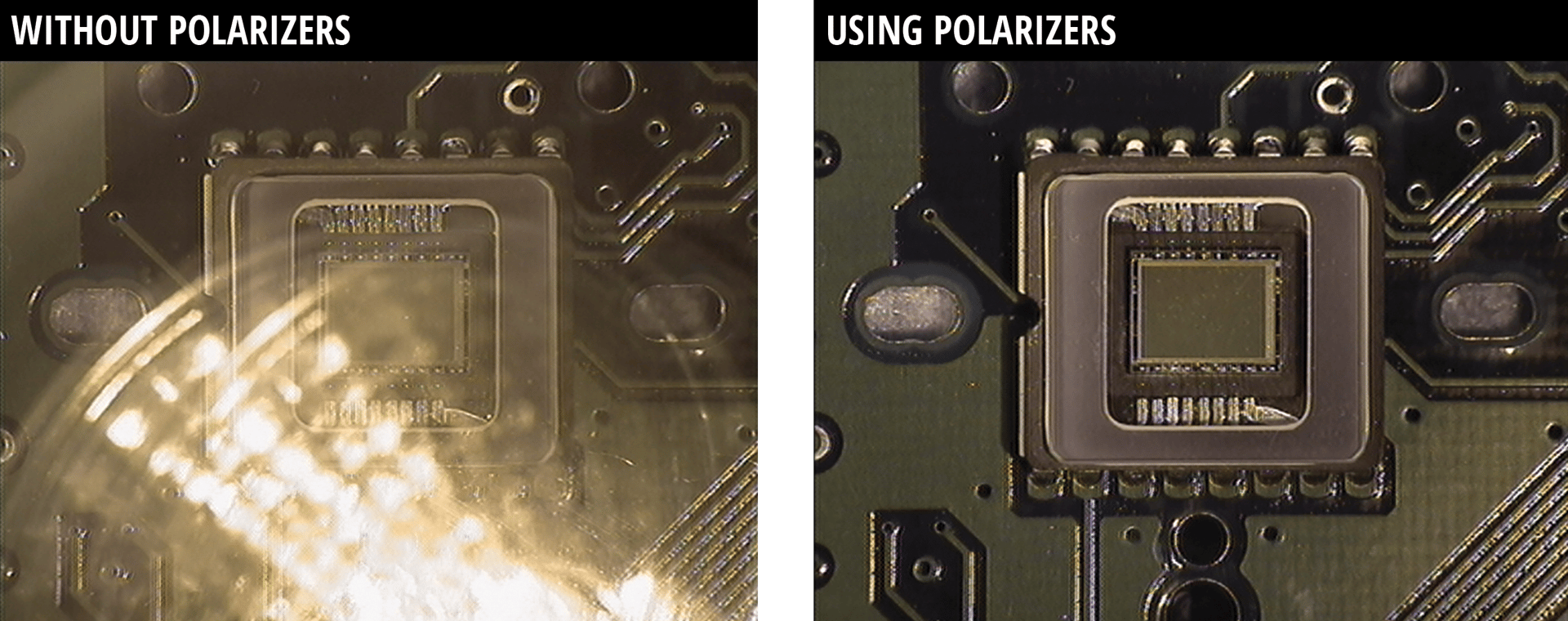

The last important and major set of characteristics for an imaging system is related to the illumination. If the environment is too dark, a clear image is nearly impossible. Many fixed focal length lenses have adjustable apertures. The f-number (f/#) is a value that describes the size of the aperture stop, which is the point along the optical axis and within the lens stack, where the cross-sectional area that light passes through is the smallest. A larger f/# is associated with an increase in aperture closure and less light entering. External apertures can also be used to control light throughput if a lens does not have an internal aperture. Machine vision filters may be used to reject or pass certain wavelengths or wavebands into or out of the imaging system. Polarizers can also be used to pass or reject specific polarizations of light to eliminate glare for clearer pictures. Figure 4 shows the difference between images with polarized and non-polarized light.
Figure 4: The effect of polarization on image quality.

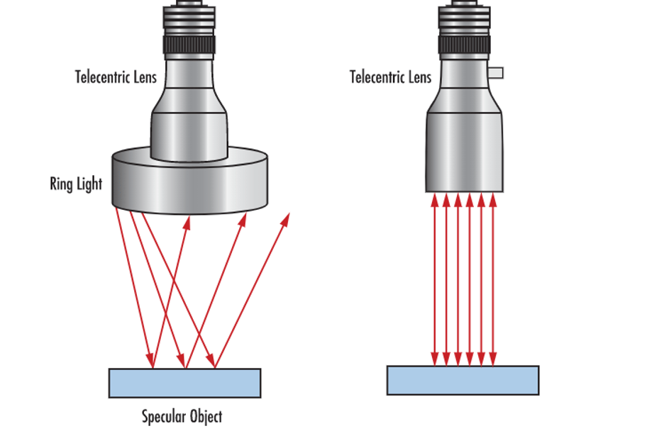

There are multiple types of illumination that can be accomplished with different sources. LEDs offer long lifetimes, are available in a variety of colors, and can be intensity controlled for specific configuration of many illumination schemes. Fiber optic illumination typically uses light guides to direct light into specific space-constrained applications. Light guides are used for in-line illumination, which is integrated into many telecentric lens designs. In-line illumination enables brightfield illumination over the entire FOV. Figure 5 shows the difference between using a telecentric lens with a ring light versus in-line illumination. The image shows a divergence of the beam path between both types of illumination. By determining the ideal type of illumination for the application, blurriness is minimized and image quality is improved. Table 2 defines different types of illumination and shows how the illumination is used. The object surface and surrounding environment help determine what type of illumination is needed for the application requirements.
Overall, an imaging system is defined by asking questions about the specific application requirements. Defining the needs of the system will refine the choices for types of cameras, imaging lenses, and illumination schemes.
 Figure 5: Ring light illumination vs. in-line illumination with telecentric lenses.
