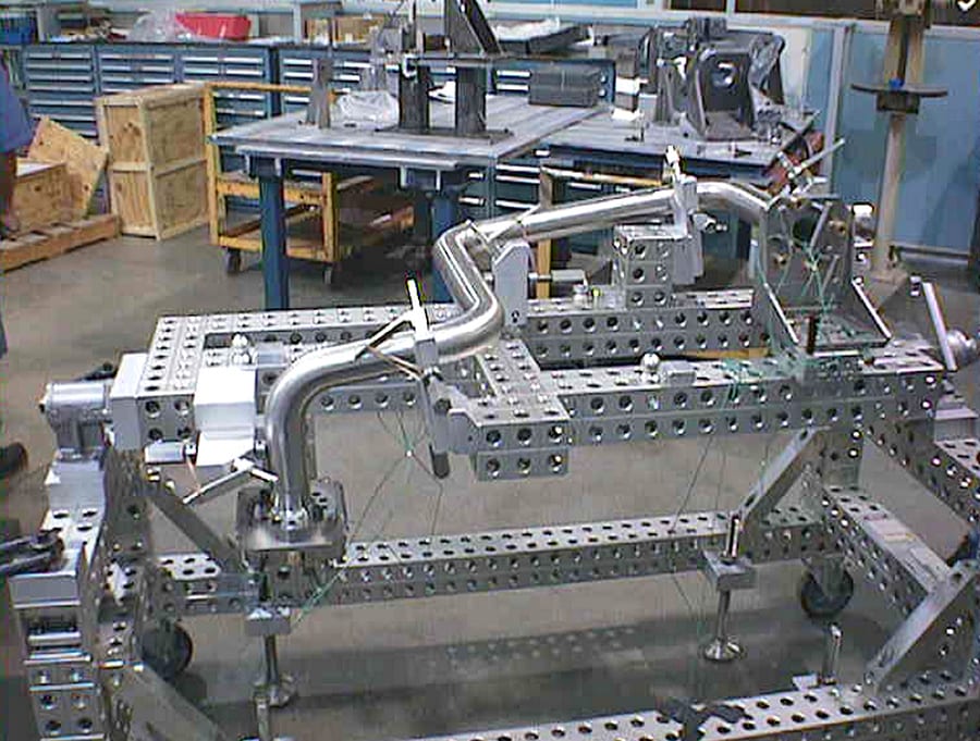

This flexibility is particularly important in aerospace, where manufacturers often deal with “high-mix, low-volume” (HMLV) production, complex geometries, and frequent design revisions. Rather than designing, fabricating, and storing a dedicated fixture for each part, by using a modular option, manufacturers can build a multi-purpose tool using reusable building blocks as shown in figure 1 encompassing two similar parts. The removable blocks were positioned to clamp both parts in the same frame.

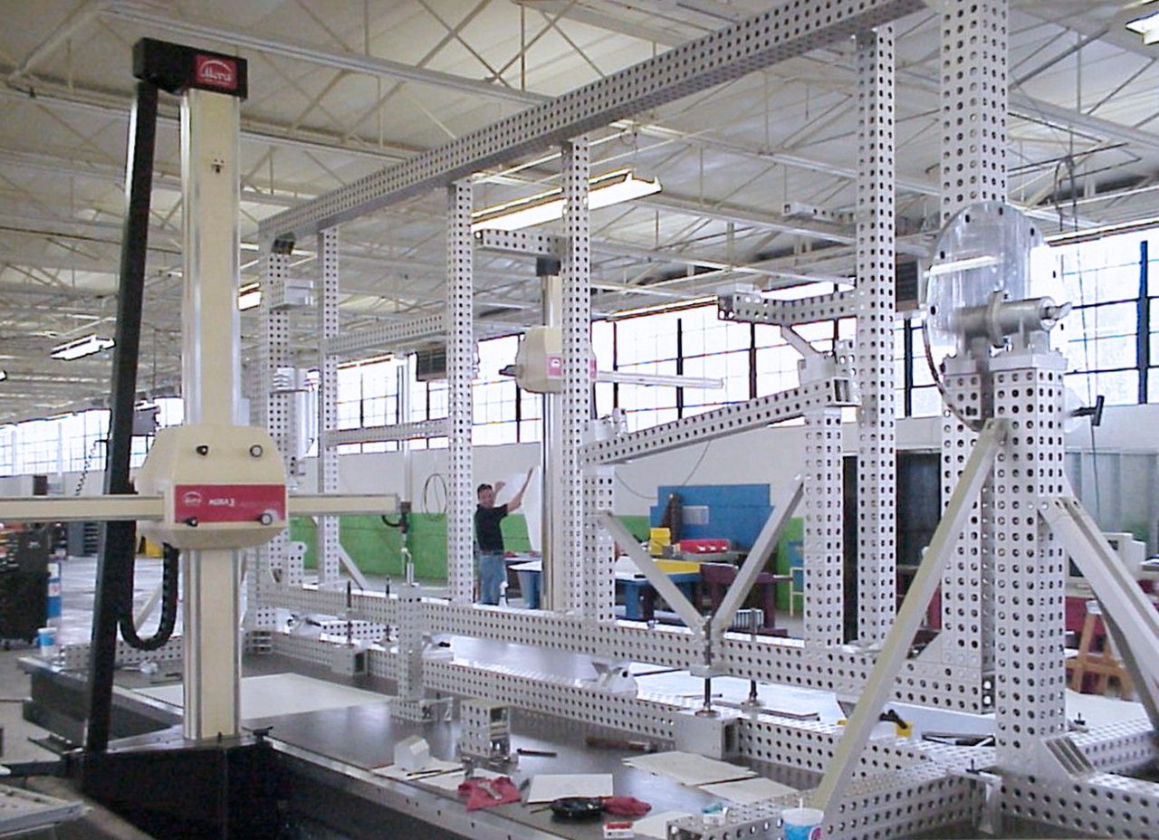

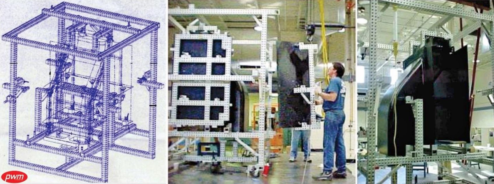

Depending on the depth of a given modular system’s components offering, fixtures can be designed and assembled for both small and large aerospace parts, from delicate components like fuel lines to complete fuselage (figure 2) or wing assembly tools (figure 3).
Modular fixturing system holding a bent metal pipe in a workshop.
Figure 2
Large CMM machine in an industrial space, surrounded by a complex perforated metal framework.
Figure 3
Fixtures can be built in sections, enabling manufacturers to create large structures that can be disassembled, relocated, and reassembled without losing accuracy. Think: Simplicity – Fun – Repeat.

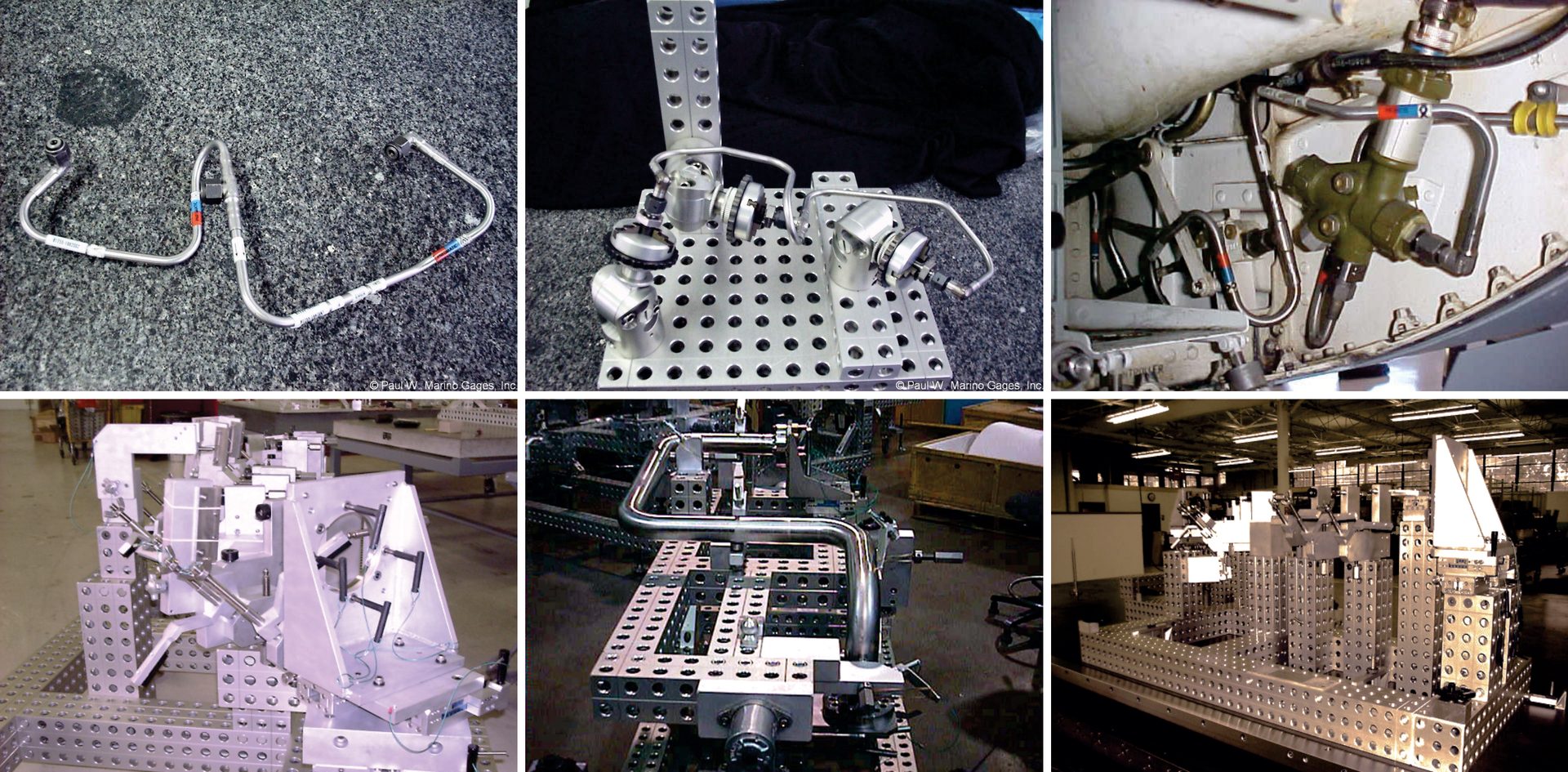

Modular tooling has been used across a variety of aerospace engine processes including orbital weld inspection of liquid oxygen (LOX) propulsion fuel lines (figure 2) and complex assembly fixtures for airframe components (figure 3) including reverse engineered duct fighter jet maintenance tools (figure 4).
Because aerospace often involves prototype work and frequent engineering model changes, the ability to modify a fixture in hours—rather than building a new one over weeks—is a major competitive advantage.
Workshop collage: aircraft engine components in modular jigs, and a worker maintaining a jet engine.
Figure 4

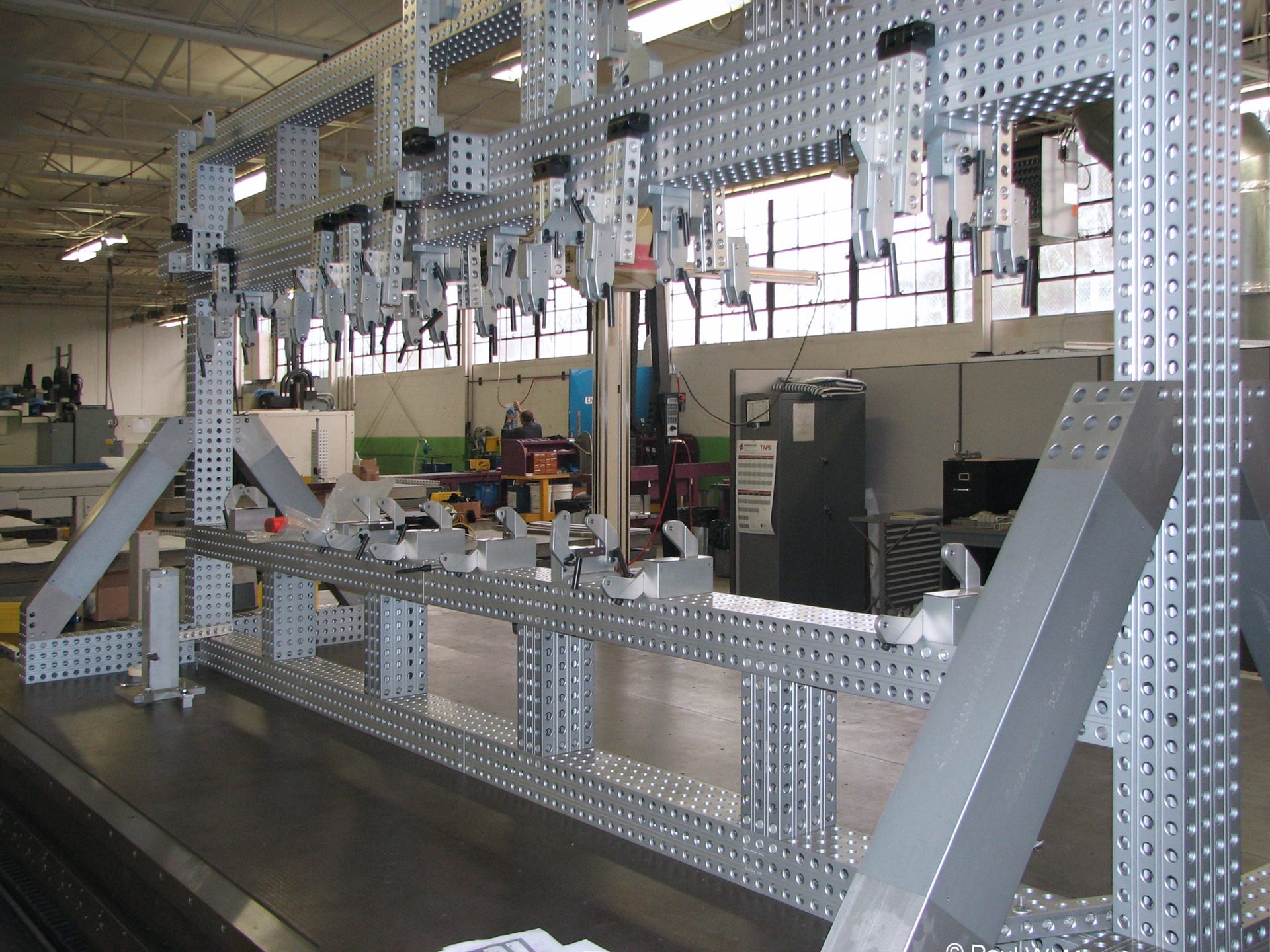

CAD design and real-world assembly of a large component using a modular framing system.
Figure 5
Consider R&D as in “bonding tools”, like the Forward Center Fuselage (FCF, figure 5) implemented by an aerospace team targeting affordability, fabrication and assembly.
