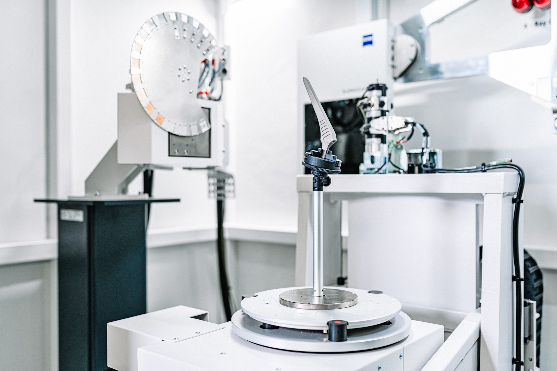

As manufacturers take greater responsibility for defining and validating how complex medical devices are measured, engineers increasingly need to evaluate internal features, tight tolerances and complex assemblies that traditional gages cannot fully assess. To do so, quality teams now use methods such as computed tomography and multisensor coordinate measuring machines to examine characteristics that previously required destructive testing or could not be measured at all. Existing FDA and industry standards describe quality system requirements but offer limited direction on how to validate these newer inspection approaches, prompting manufacturers to define inspection protocols internally and document their rationale for regulators.
Podcast ad featuring hosts Michelle Bangert & Darryl Seland discussing industrial quality control.
Paul Brackman, X-ray product manager at ZEISS Industrial Quality Solutions, said manufacturers cannot rely only on established standards as device designs evolve. “Medical devices are becoming more complex, and companies can’t afford to wait years for new standards to be developed,” Brackman said. As a result, manufacturers increasingly write their own inspection procedures and quality criteria rather than relying solely on FDA or ASTM standards.
Carrie Pfeifer, applications engineer at ZEISS Industrial Quality Solutions, said manufacturers often work directly with measurement equipment suppliers to establish validation approaches that fit their products and risk profiles. FDA standards outline what a quality management system must achieve, she said, but do not always explain how to apply advanced measurement technologies in practice. That leaves manufacturers responsible for demonstrating that their inspection methods produce reliable, defensible results.

Metal medical implant on a rotating stage within a Zeiss industrial X-ray inspection system.
CT technology supports innovation in the medical industry by enabling comprehensive analysis of complex parts through digitalization.
