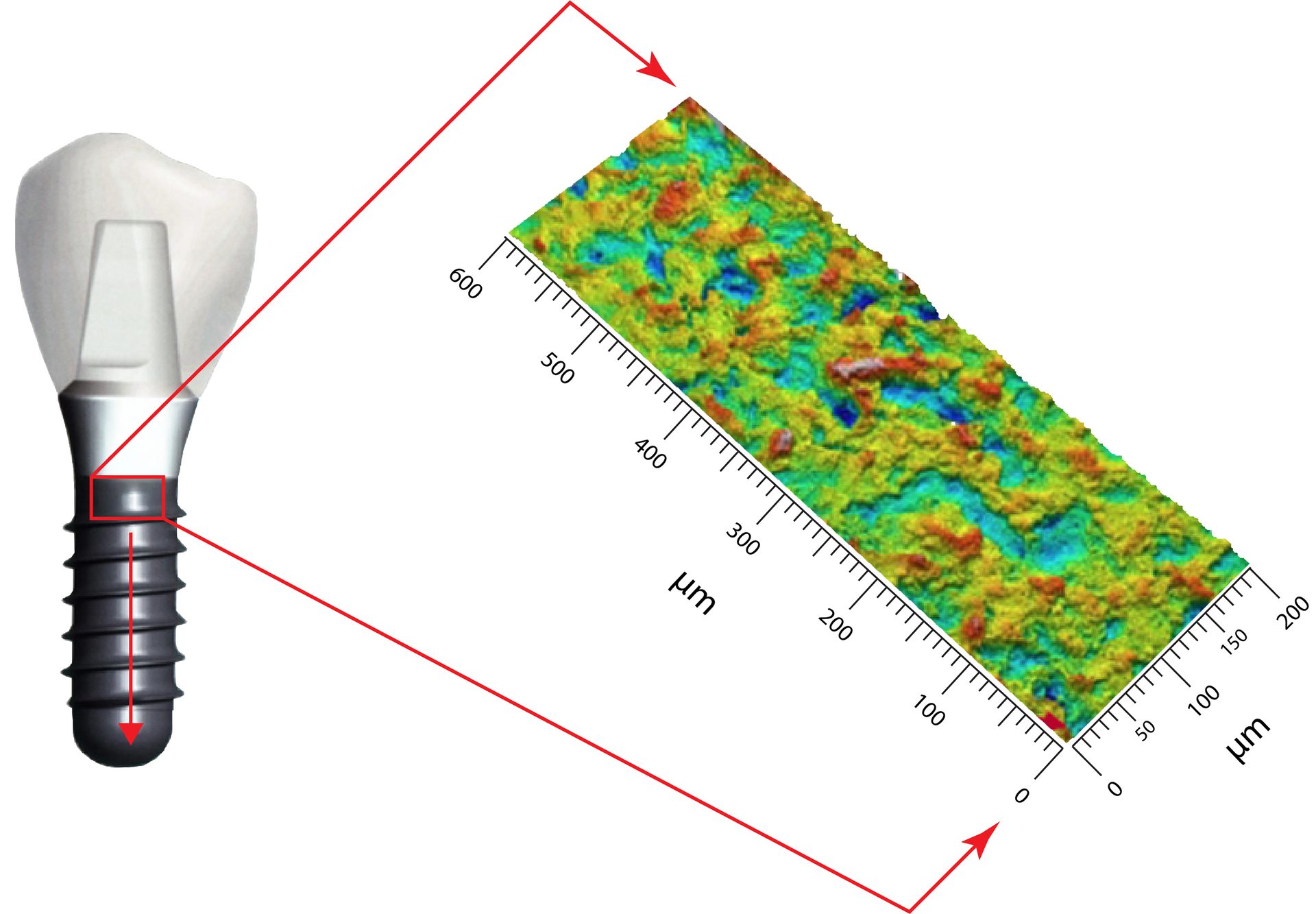

Dental implant with a colorful, magnified topographic map of its surface roughness, scaled in µm.

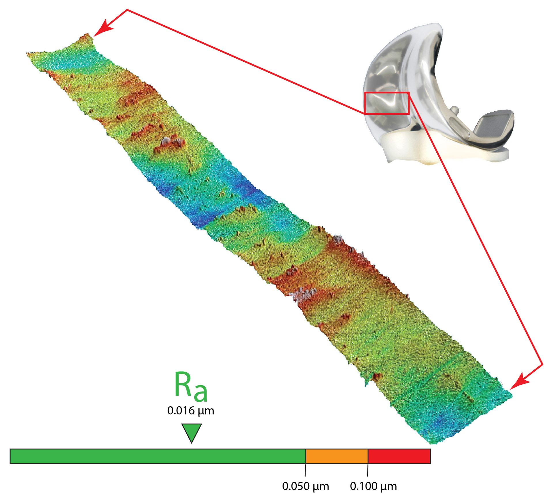

3D surface map of a knee implant's articulating surface showing Ra = 0.016 µm with a color scale.

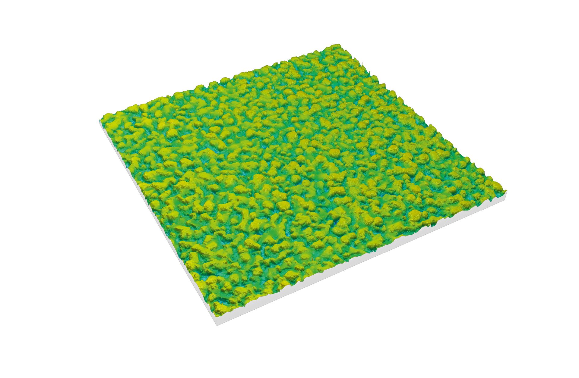

Colorful 3D surface map of a bumpy, textured surface.

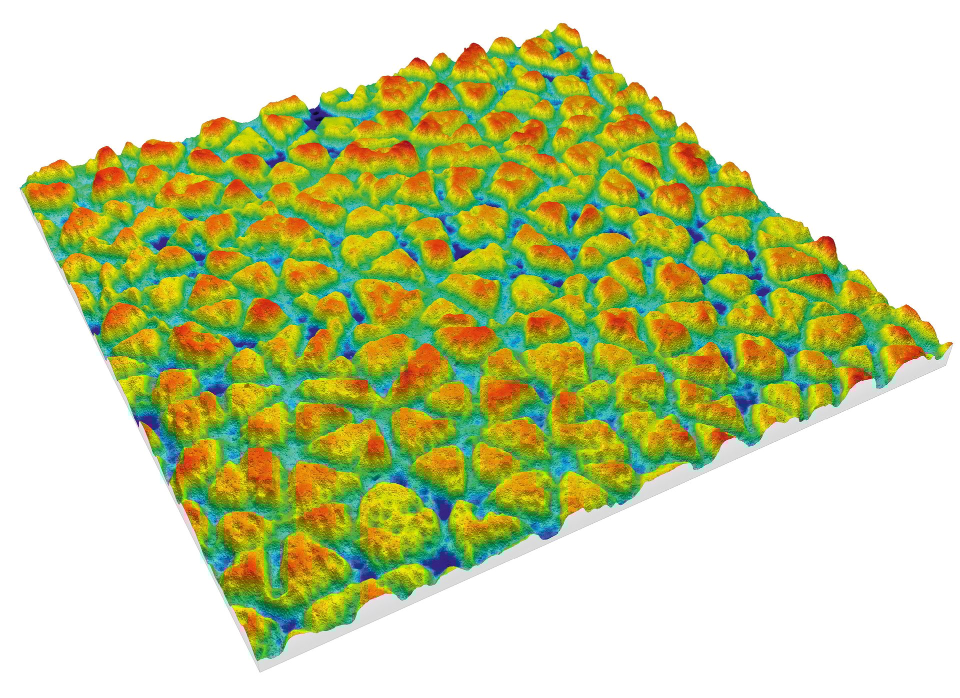

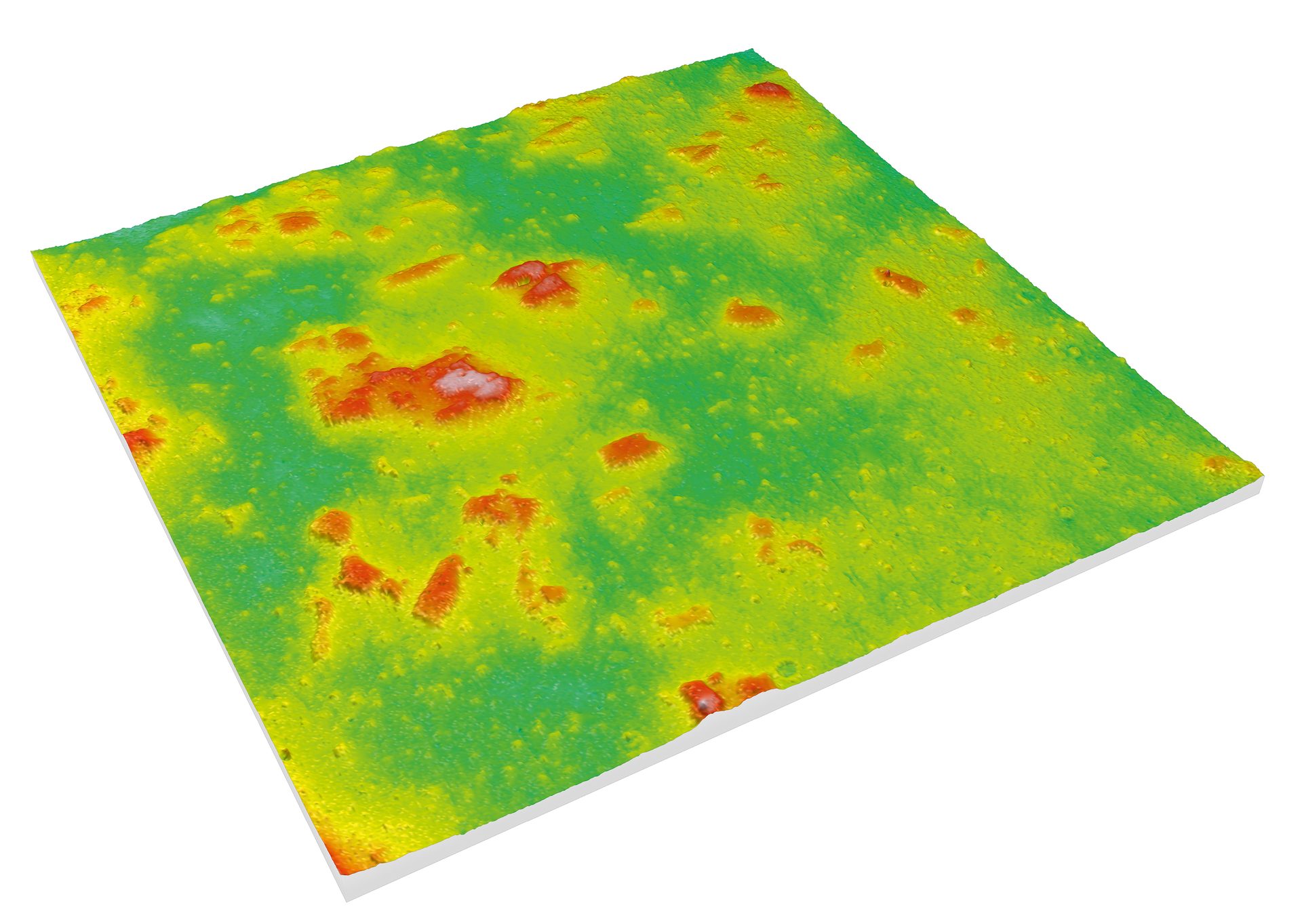

3D topographic surface, colored green to red, showing height variations.
caption
