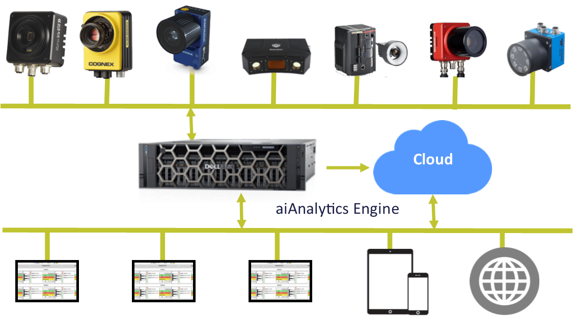

Data analytics solution
Data analytics solution for acquiring, storing, and analyzing vision data from multiple vision systems.

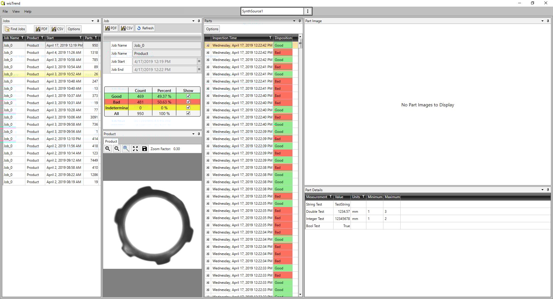

Reviewer application for monitoring and trending of vision system results
Reviewer application for monitoring and trending of vision system results.
