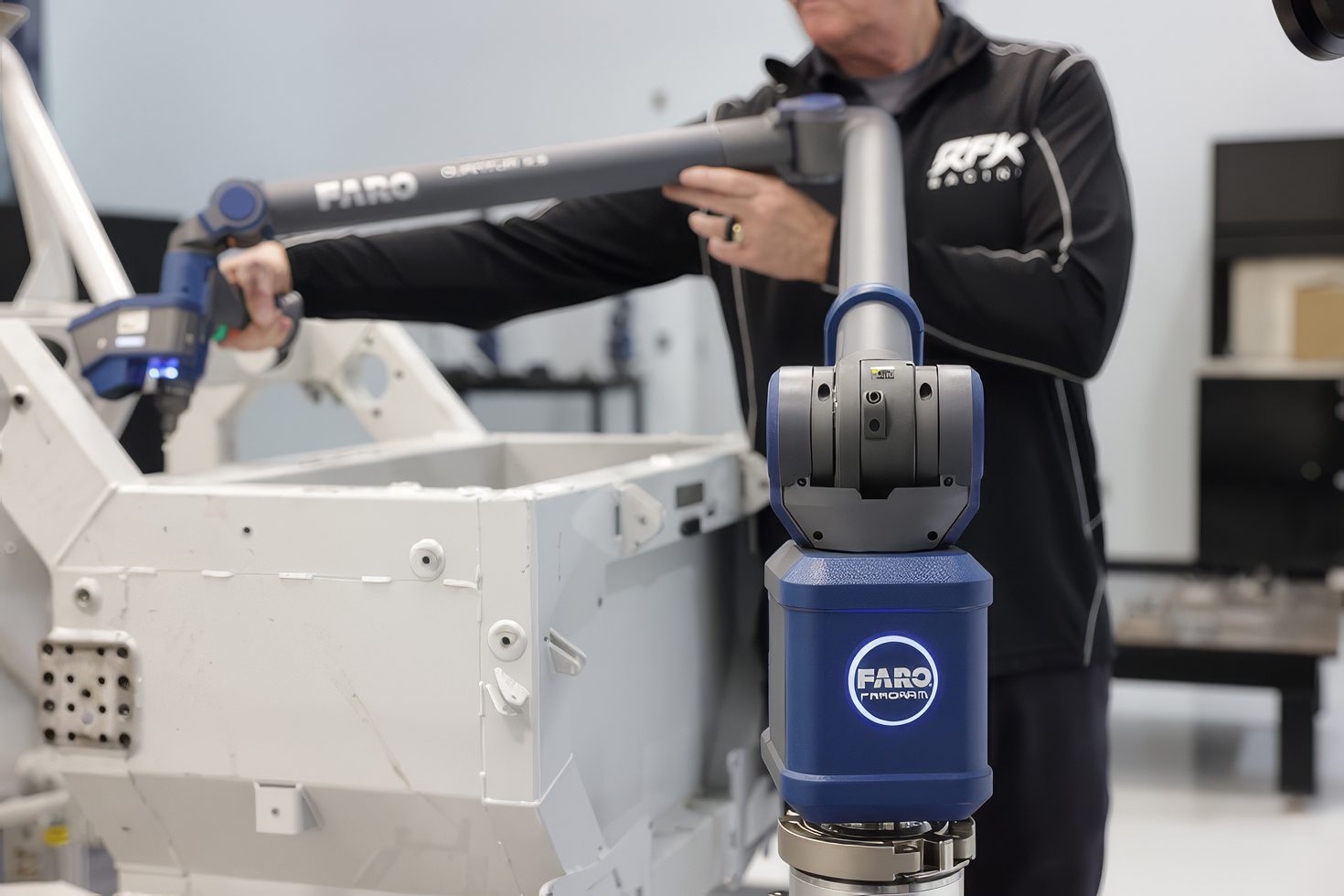

Probing/Scanning an Electric Vehicle
For an electric vehicle, probing and scanning play complementary roles to ensure that physical parts are aligned and maintained with the precision required for mass-produced consumer transport.
Probing is most valuable when technicians need to verify discrete, high-accuracy reference points tied to the structural and mechanical foundations of a facility.  But when to probe or when to scan often breaks down on the part size in question. Examples include:
  • Battery pack inspection: Can be a combination of the two. For deformation inspection, a handheld scan might be best.
  • Battery pack fitting and mounting: This is where an arm would be ideal.
  • Battery pack layouts: To ensure correct thermal management, channel geometries/simulations, heat-sink surface, scanning might be best.
  • Heat-sink surface and geometry analysis: Best to use a handheld because of their excellent performance for free-flow surfaces.
  • Housings/casing: For parts <500mm, an arm would be best.
  • Vehicle interiors: While still in common with current combustion cars, most components are molded plastics and have organic shapes. Scanners excel at this and can even be brought into the vehicle to perform a complete scan of an assembled interior.
  • Large panel/Body in White (BIW) Inspection: A BIW inspection is a critical automotive manufacturing process that verifies the dimensional accuracy, structural integrity, and welding quality of a car’s assembled sheet metal framework before painting. For these inspections, premium handheld solutions are best.
In the above examples, all must meet strict positional tolerances to ensure the final vehicle will come together properly while maintaining all the characteristics that customers care about.
Probing allows teams to capture the precise XYZ coordinates of these features, confirming that surfaces are level, anchor points are straight up and down, and structural elements align with design intent.
