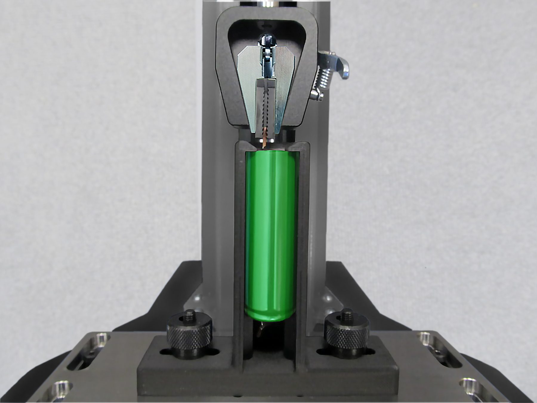

A pull-off tensile test on the terminal interconnect tab

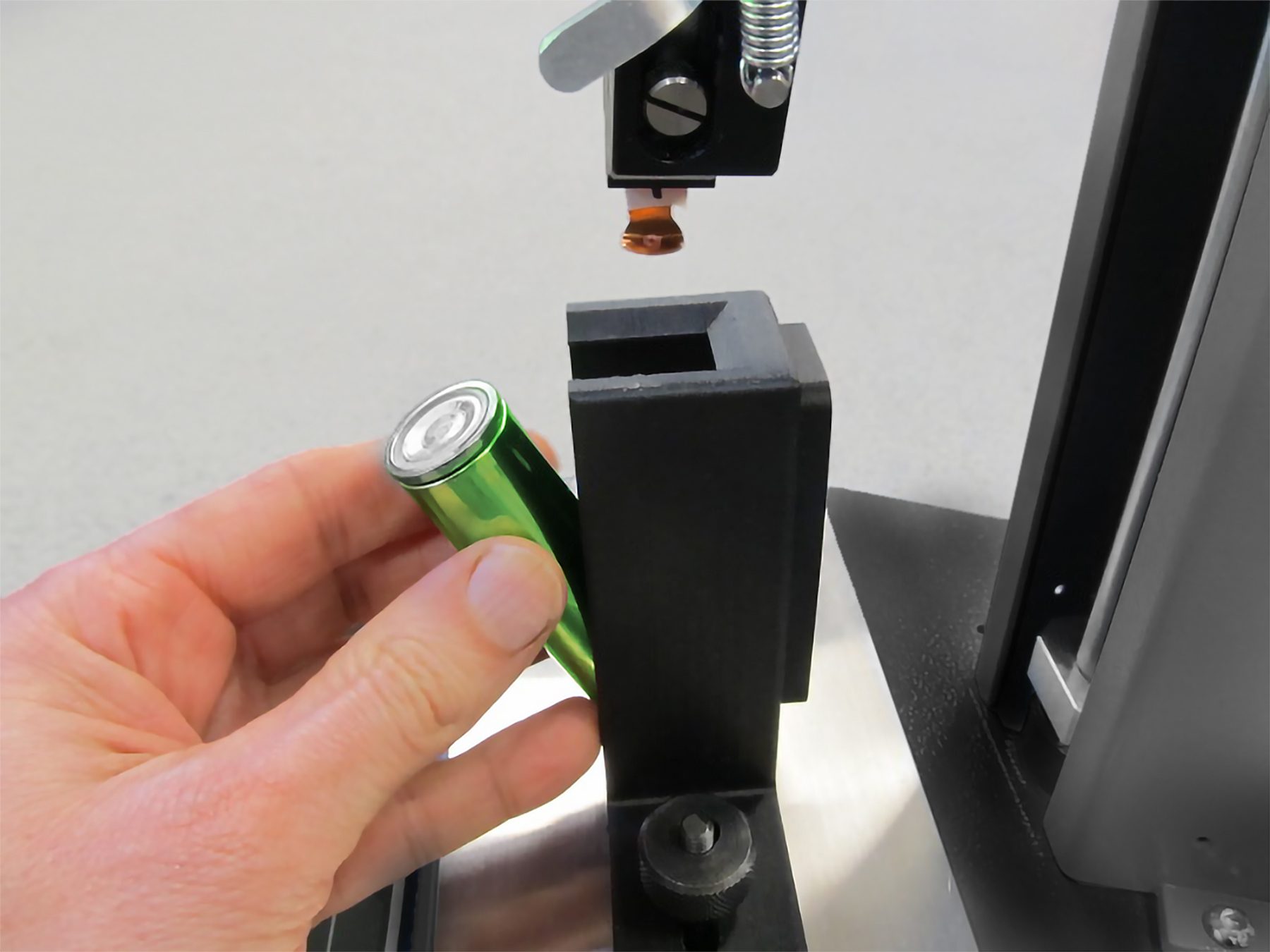

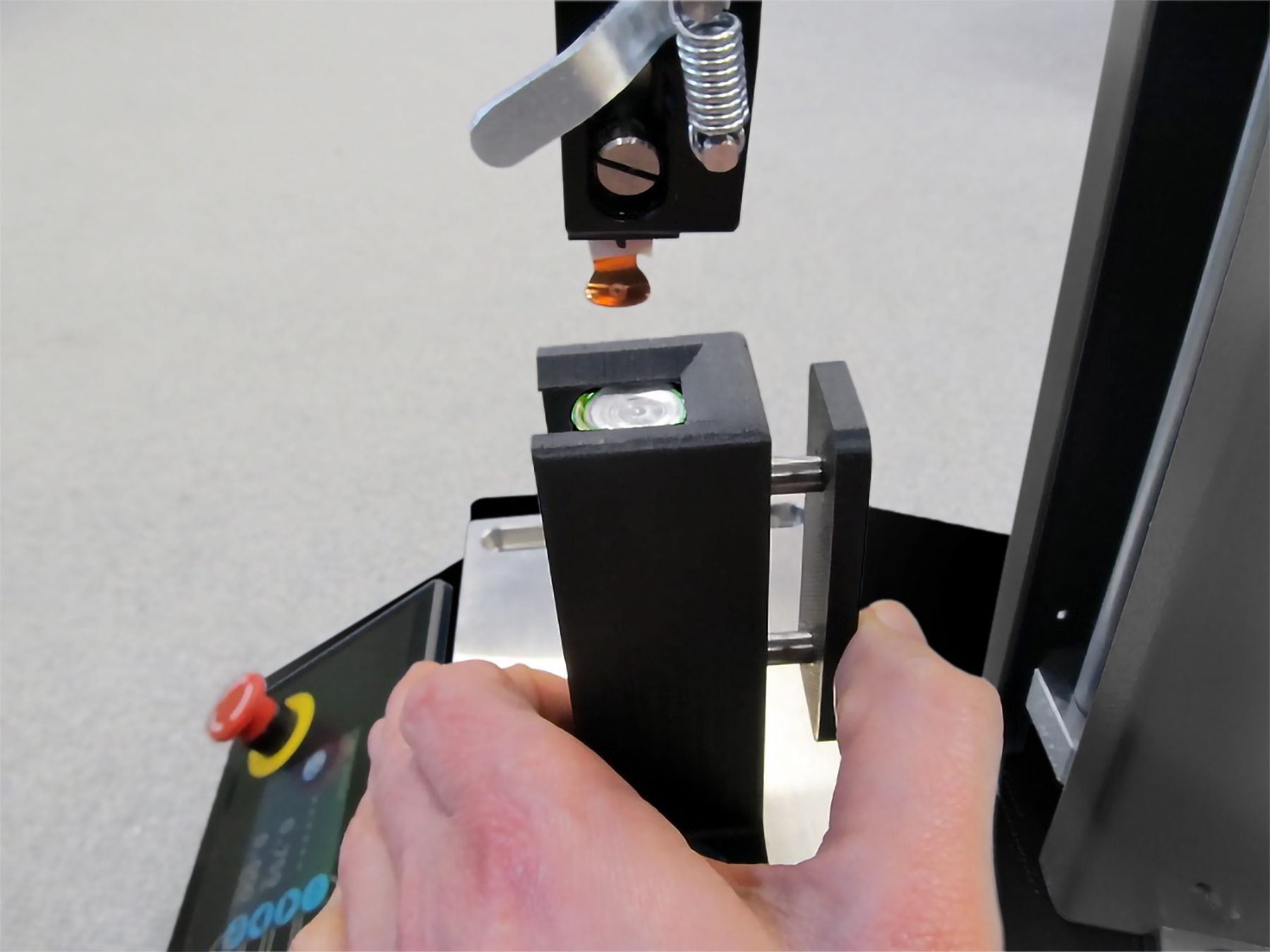

A pull-off tensile test on the terminal interconnect tab at the cathode (positive) end of a cylindrical cell battery. The axial force is consistently increased until failure, which may be the tab material itself or its welded joint to the casing, and the peak load is recorded. Efficiency and repeatability of testing a batch of battery samples is enhanced by use of a custom-built fixture to load, secure and release the cell. A serrated-toothed jaw self-tightening wedge grip ensures the metal tab does not slip.

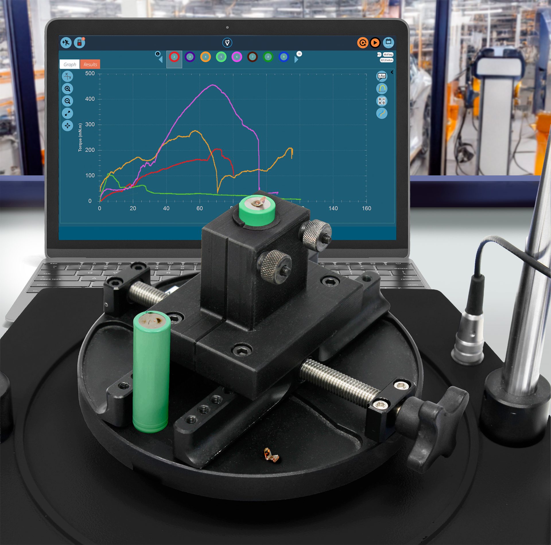

Torque testing of electrodes to current collector interconnects
A twist on the mechanical integrity test of current collector tab manufacture is to again test to failure but by the application of a torque rather than an axial force. The vibration experienced by the battery pack in service will be random in nature and manufacturers take advantage of software-controlled systems to implement a variety of loadings in order to thoroughly test a component’s resilience.

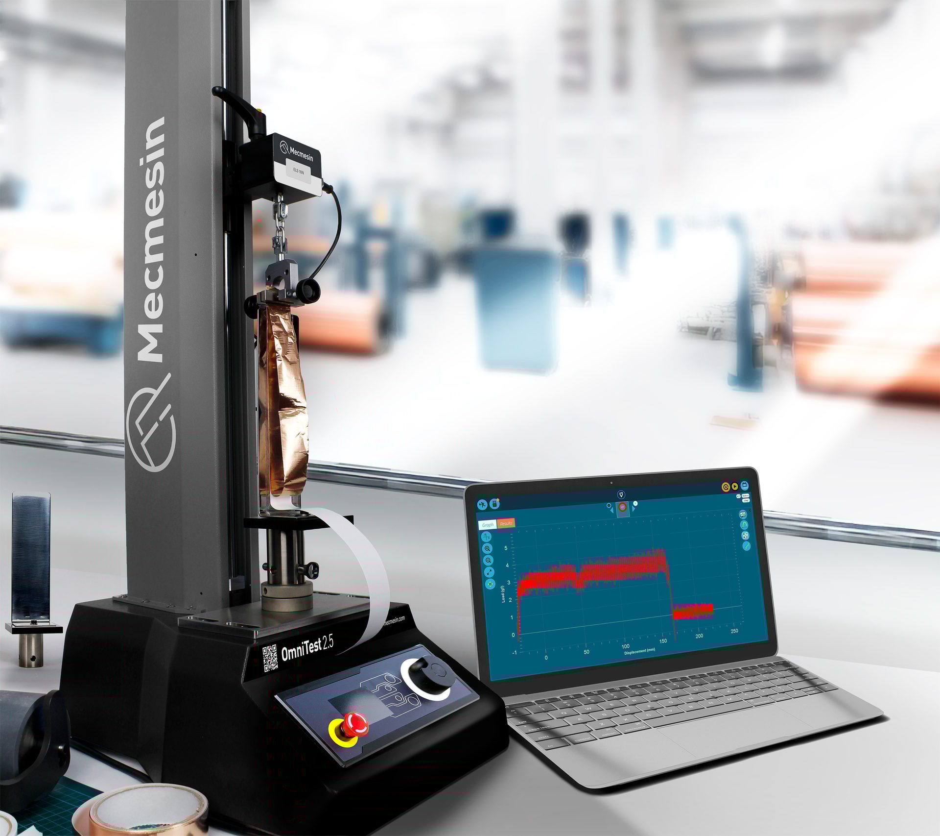

A 180° peel test on metallic film. In this version one substrate is adhered to the vertical plate fixture and the other is peeled by the upper grip of the UTM. By gripping the edges of both films with a similar vice grip in the lower fixture another 180° peel may be performed. The 90° test places the test sample on a horizontal bed which moves in the lateral direction at the same rate as the upper fixture pulls the film vertically, thus maintaining the appropriate angle.
A twist-off test measures the torque required to make the electrode tab fail. An adjustable clamping fixture grips the cell’s exact geometry enabling meaningful comparative testing of batches.
Peel and adhesion strength testing of coated battery components
The internal components of a battery are largely comprised of thin, coated sheets densely packed within the casing—the cathode, anode and separator elements. Efficiency is heavily dependent on the effectiveness of the chemistry inside the cell and these components are coated with films to maximize these reactions and optimize charging performance. The bonding of the coatings is tested to quantify the ability of the adhesion agent (slurry) to remain in place and perform over the lifetime of the battery.
Standard peel tests are used, of which there are several, to provide a range of data to benchmark a particular formulation’s suitability. A peel test applies pull to one substrate at a controlled angle, typically 180°, 90° and the Z direction (effectively 0°).
A universal testing machine (UTM) implements specific procedures by means of fitting fixtures to hold and apply forces to a test specimen. Thus, the same machine may also perform the Z-direction test, whereby one substrate specimen (cut to certain dimensions) is subjected to a pulling force evenly over its cross-section, pulling apart—not a ‘peel’ motion in the conventional sense but a universally implemented and valuable measure of bond strength.

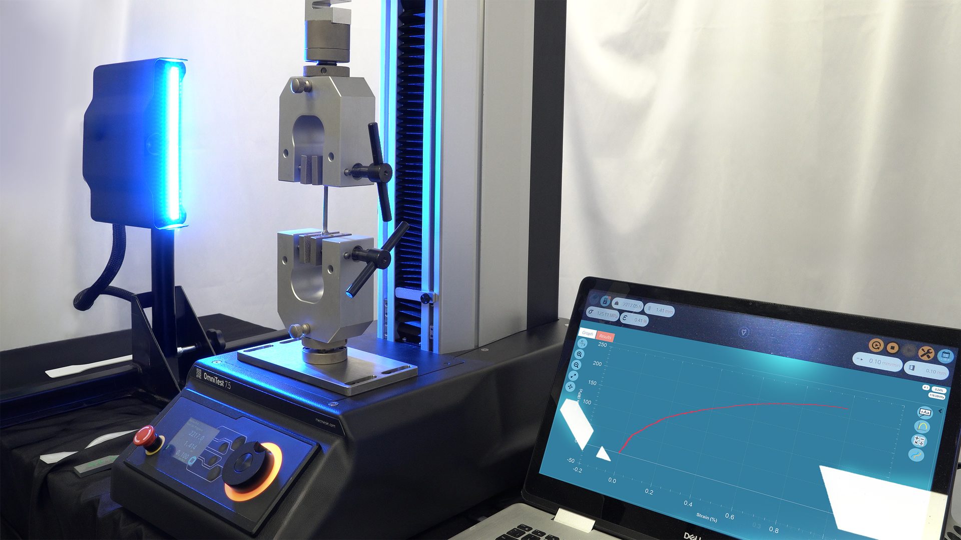

Measuring the stress-strain behavior to the point of failure of a standard dumbbell-shaped material test piece is the fundamental method of determining a raw material’s physical strength. The specimen is put under tension and calculations based on the load-elongation curve is used to quantify benchmark properties. Understanding how a new material with improved electrical efficiency might be impacted in terms of mechanical strength is a vital insight. Changes to the structure to elicit gains in conductivity, ductility, ease-of-bonding or thermal behavior must be evaluated against any significant loss in robustness.
An established tensile load-displacement test on a metallic raw material test piece. Accuracy of calculated physical properties is important where fabricated components are part of an EV system, as efficiency improvements are at the forefront of current research and development objectives. This system employs a video extensometer which measures the true strain (elongation) of the test piece without contact, optimizing the accuracy of the measured value.
