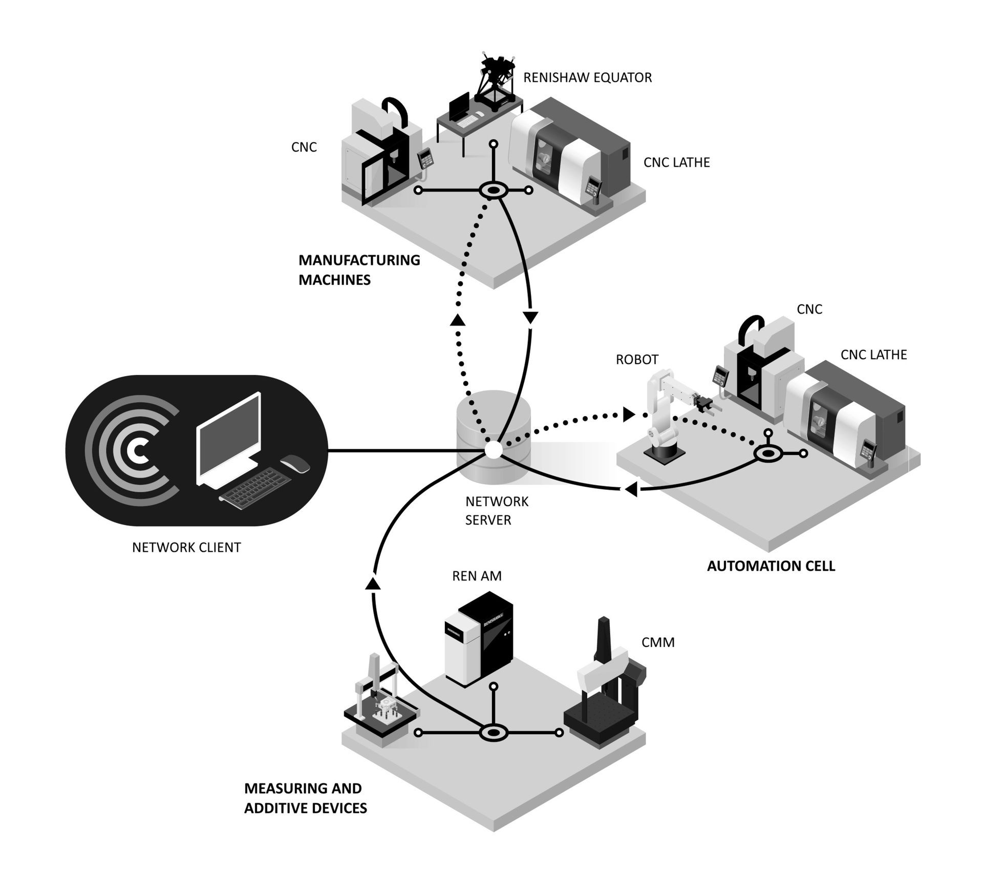

![An example system setup for Renishaw Central. The platform was connected to 69 machines at the company’s low-volume, high variety UK manufacturing facilities in Miskin and Stonehouse.](https://cdn.vev.design/cdn-cgi/image/f=auto,q=82,w=1920/private/TrZjorIyzFVHDIUpGHunL0PSQdM2/image/6SDtB0OdyA.jpg)
