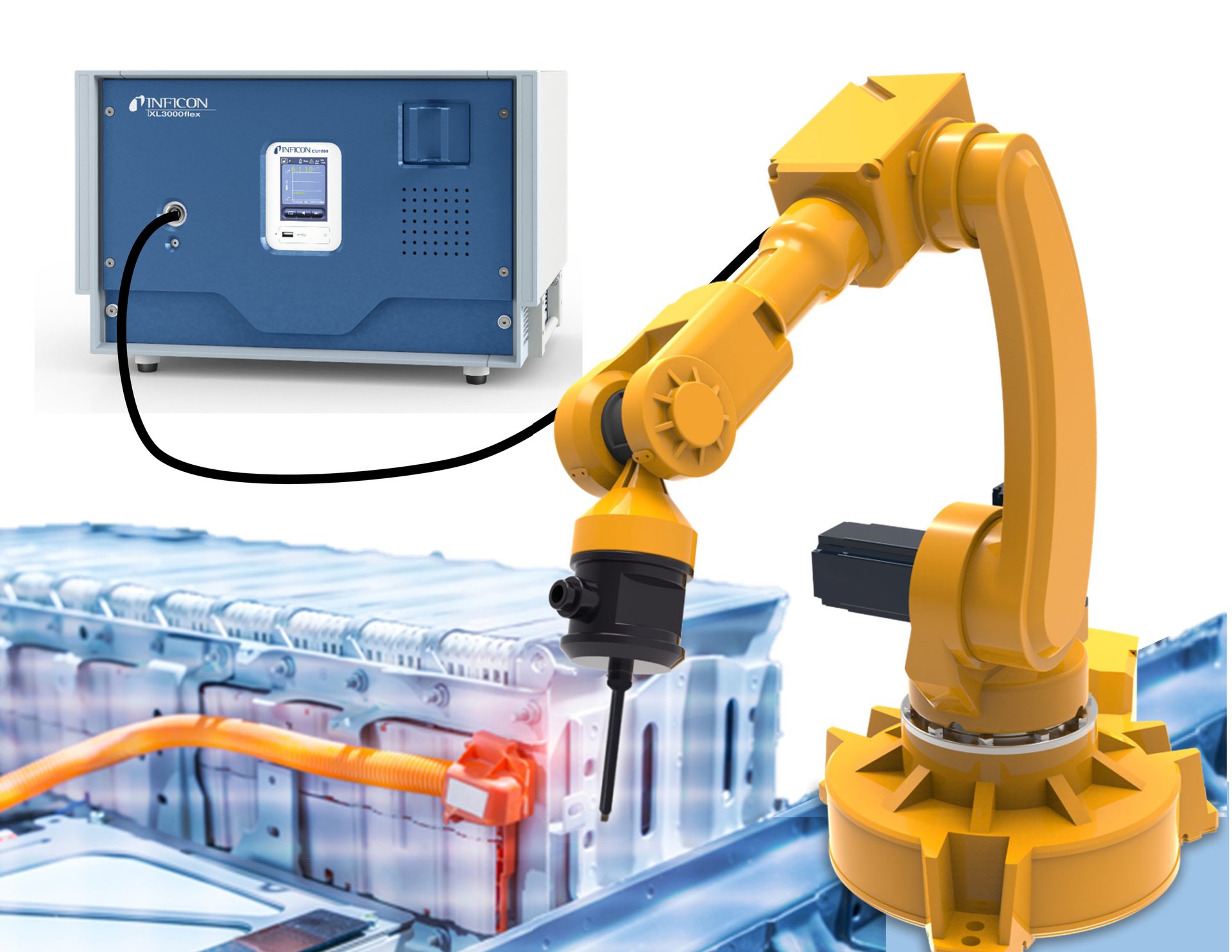

![](https://cdn.vev.design/cdn-cgi/image/f=auto,q=82,w=1920/private/KiK8toUCswUM2XtVNUOXzt0p3Zw2/image/nr8gd2mV5e.jpg)
Robotic sniffing battery pack with XL3000flex

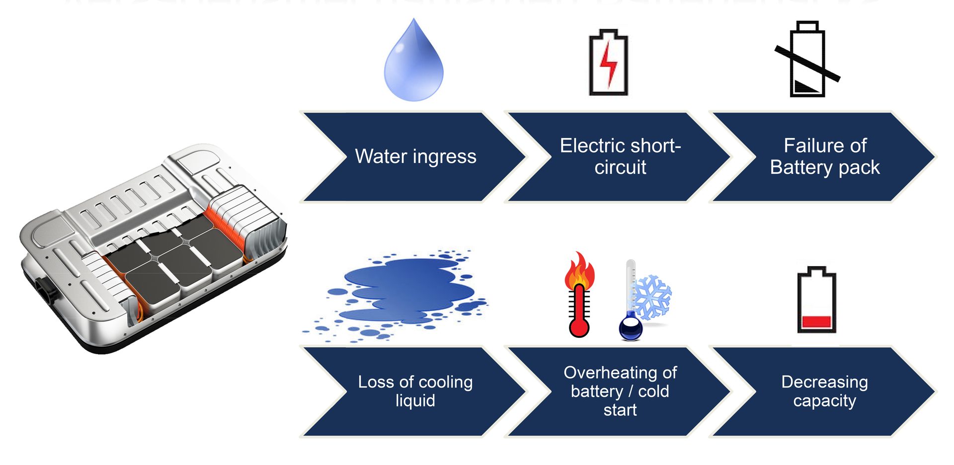

![Font, Line](https://cdn.vev.design/cdn-cgi/image/f=auto,q=82,w=1920/private/KiK8toUCswUM2XtVNUOXzt0p3Zw2/image/HXG7cKOgQU.jpg)
Battery pack failure mode
Li-ion batteries and fuel cell stacks typically use water-glycol cooling loops to regulate battery temperature. Very small amounts of water-glycol loss can enable the liquid to come into contact with electronics in the battery pack and may cause an electric short. Therefore, the allowable amount of water-glycol leakage needs to be set low. Considering the operating pressure of the cooling loop system, it needs to be tested for leak rates in the 10-4 to 10-5 mbar.I/s range.
