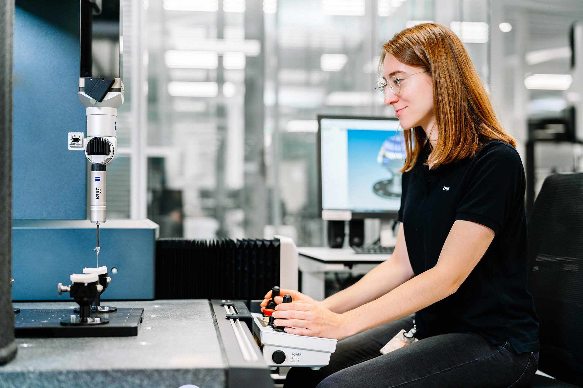

The CMM
The specific intended use of the CMM is to facilitate accurate, repeatable measurements of medical device components (or other workpieces) within the manufacturer’s given environment (an inspection lab, production area, etc.). This intended use gives rise to a number of requirements, including:
- The requirement that the CMM performs to an expected level after being installed in the manufacturer’s environment
- The need for it to be traceable to national standards
- The need for the CMM’s environment to be suitably controlled with regards to temperature and humidity
- The requirement that CMM users are trained to operate and maintain the CMM system.
Given such requirements, it’s clear that the CMM hardware alone is not the only aspect subject to validation. Realistically, it is the “CMM system” — the collection of CMM hardware, environment, users and other related infrastructure — that addresses the intended use. “Generic” documents like CMM accuracy specifications are not, by themselves, sufficient to proclaim that a CMM is validated, although they are important.

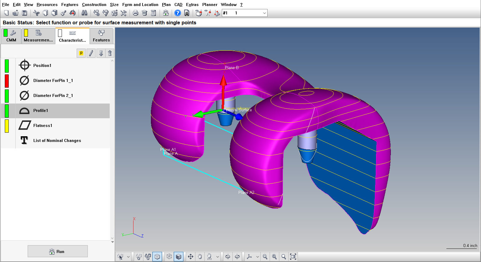

Metrology Software
Next, examine the metrology software used to create the programs or inspection routines carried out by the CMM. NIST or PTB certifications are available for many metrology software packages. While these documents are important evidence that the software algorithms adhere to known standards, they are not specific to the intended use of the software, which is to write a measurement program.
In fact, metrology software packages are analogous to programming languages, like C++ or Python. There is no way to validate these languages with intent that all programs written thereafter are inherently validated; it is the program (written using the programming language) that must be validated.
Inspection Program Written Using the Software
For CMM-based inspection programs, the “inspection process” is the program’s ability to produce accurate measurement results for identified drawing requirements within certain parameters, including:
- Demanded cycle time
- Real workpieces being measured
- Necessary probe tooling and fixturing
The inspection process should be validated just as the infrastructure surrounding the CMM should be validated as the “CMM system.”
