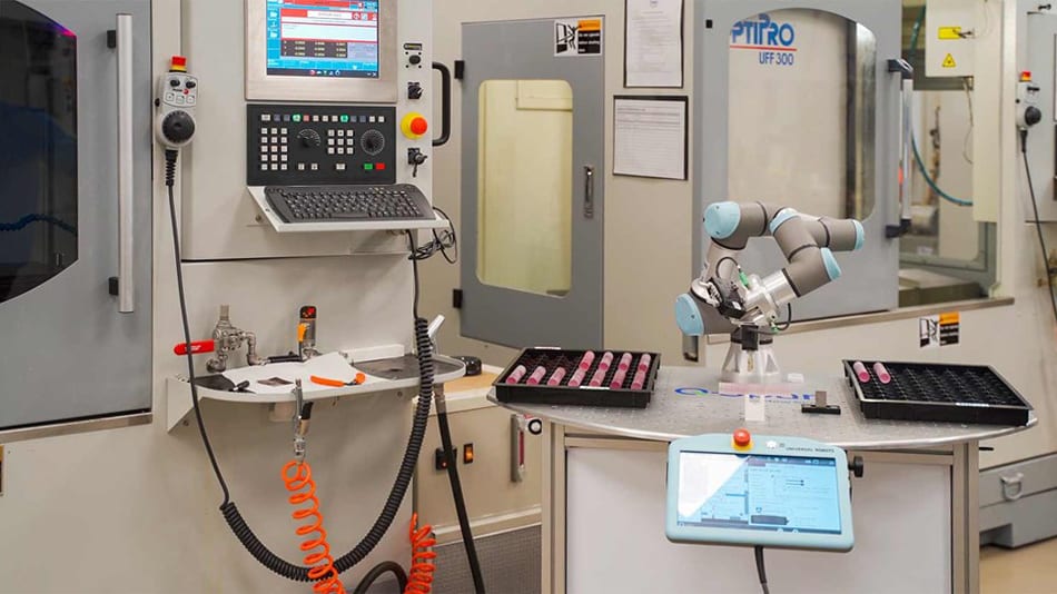

Optipro’s OptiSonic grinding machines use diamond tool drills to produce precision optics. A Q-Span Workstation with collaborative robot placed near the machine can measure core thickness of each cylinder in process, flagging out-of-tolerance errors and allowing immediate remediation such as change of drills or feed rate.

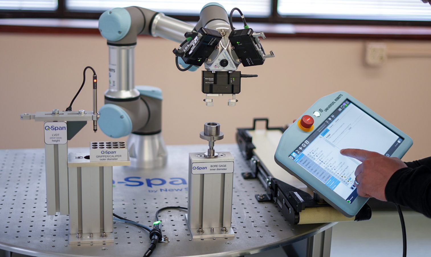

A Q-Span Workstation automates manual gaging tasks using a robotic gripper/caliper tool and a variety of familiar gages including bore gages and LVDT height gages. “No-code programming” makes them easy for operators to learn and use.
