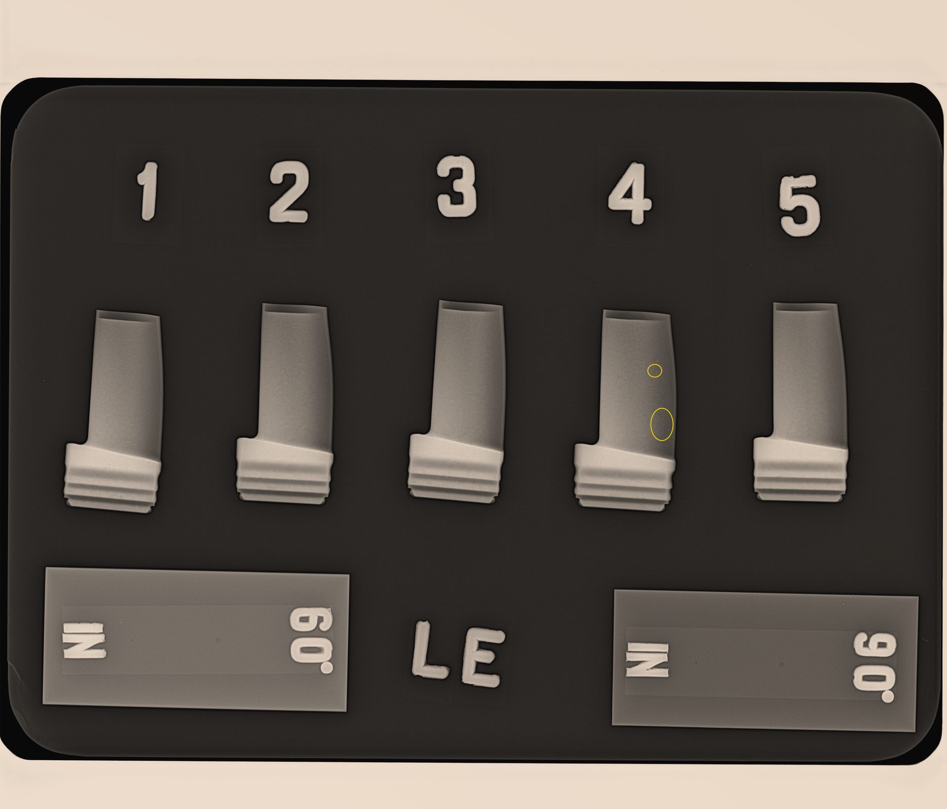

For internal flaws, the most common method is radiographic testing (RT). Radiography is especially useful when the subjects have complex geometry. In many cases, the internal design will make RT the only option when flaw detection and visual images are required. If images and location of defect is not required, then resonance inspection (RI) is another possible internal detection method. Gaining access to all inspection areas of a part can be difficult the more complex a part design is, but for many parts where this access is possible, alternate internal methods like ultrasonic testing (UT) and phased array ultrasonic testing (PAUT) can be used.
After the internal and external methods are selected, the next key thing to consider is method optimization. As an example, we consider both radiographic testing (RT) and liquid penetrant (PT). For RT, the density and geometry of the component will play a large role in optimizing the RT to ensure that the best flaw detection is possible. The three main items of optimization are: 1) X-ray tube power, enough to provide proper penetration of the subject part. 2) X-ray film, image plate, or detector sensitivity, high enough to provide the required sensitivity. 3) Inspectors need to be properly trained, qualified, and certified.
